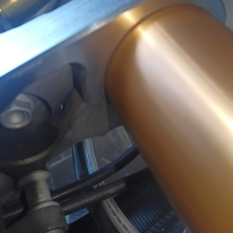

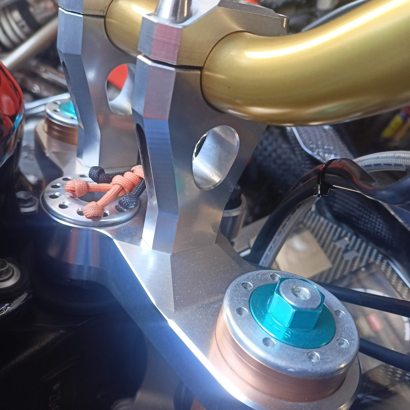

Not sure if it helps much ( if at all) , as mine's the Factory but couple of pics below of my standard Gen1 Tuono top yoke.
On mine the "leveling up" is part of the top surface casting

Tricky wrote: Wed Apr 12, 2023 8:51 am Not sure if it helps much ( if at all) , as mine's the Factory but couple of pics below of my standard Gen1 Tuono top yoke.
To my untrained eye, that looks a lot more like it's been machined from billet.
I could be mistaken but it has all the hallmarks. A wider shot would help.

Think it might be a finished machined casting, looking at the underside?

Looking at the pics again, I think Screwd is probably right, I think the underside is just dirty. Doubly so when you look at the risers themselves, clearly machined from plate. I suspect the driving reason was cost more than anything, Aprilia probably don't/didn't make enough to bother setting up castings.
That yoke is what....40-50mm deep overall? 50mm Ally plate is basically an off the shelf product, cheap as chips.

It's a machined casting.
They are Ohlins forks in my model- I don't know whether Aprilia buy the whole assembly including the top yoke from Ohlins or just the fork legs, but whatever, the top yoke is quite different (and a lot more substantial) looking than the one on the non-Ohlins variant of the Tuono.
