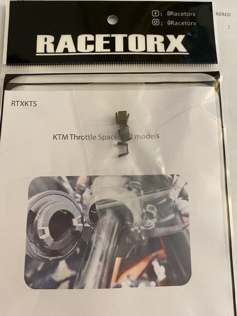

dern wrote: Fri Sep 30, 2022 3:54 pm
Dodgy knees wrote: Fri Sep 30, 2022 3:47 pm Doesn't the big SD have engine modes. Whats it like in rain mode or whatever they call it. ?
Don't know, it drops it to 100bhp so never tried it.
Tried it today… a little bit better but slower.
I think the problem is at least partly the slack in the throttle. The kit didn’t arrive today thanks to the postal workers strike. Went out anyway and tried to ride around that and was partially successful. Looking forward to the kit getting here to take the slack out.

Numnut wrote: Fri Sep 30, 2022 10:53 am
dern wrote: Fri Sep 30, 2022 10:02 am That's interesting as that uses the same photo and description as the racetorx spacers at twice the price... https://racetorx.co.uk/product/ktmsk/
That's pretty cheeky really then! That aside, a lot of people seemed to think they were well worth fitting, so hopefully it'll improve things.
These came this morning so will try and fit them in the week and give them a go. 5 small pieces of plastic to take up the play in the fbw throttle. You only need two but they break easily apparently.
Yours for 10 quid delivered from Racetorx.
