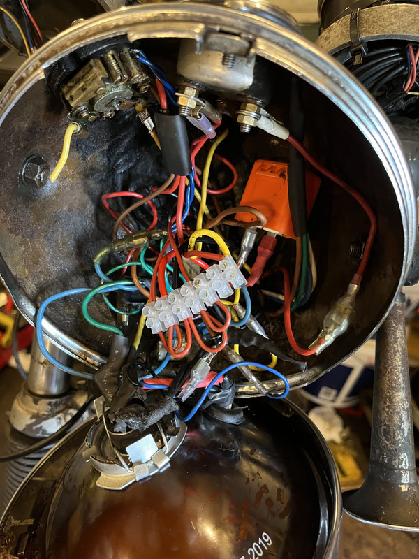

Just been out for a spin...tis the first time I've been out on a bike, any bike, "just because" in a long long time. WTF I chose today I have no idea, its three million degrees out there and that engine puts out ALOT of heat.
Also. I broke down.
This one was an easy one though, the battery connector had vibrated off the terminal. Shes got a non standard battery, its actually intended for UPSs in fire alarms and the like and is theoretically better suited to long periods of non use. The connectors aren't bolted to the terminals though, which is a downside.
A fag butt from the side of the A5 makes the perfect anti vibration spacer. I'll redo the connectors with ones that actually fit the terminals! Duck taping them in place will probably also help.
Also. I broke down.

Also. I broke down.

I sometimes punch a dent in the back of a female spade, to make it grip better.
Looking at the wiring, was your wife’s dad colour blind?
And crimpophobic!
And crimpophobic!

The best bit is, this wiring was done by my FiL and his BiL (i.e. my wife's uncle).
FiL was a cheif tech in the RAF for >30years (well he obviously want a chief for that whole time), BiL was also an RAF techy type before leaving to become....an automotive electrician

On my Kawasaki I separated the 4 wires it needs to run from all the other wiring needed for other things, makes the wiring tons easier. I need to do the same on my YPVS.
