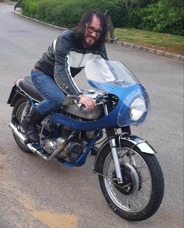

I posted about this bike back on the old place, but it deserves it's own thread here now.
Last year my FiL passed away and bequeathed his 3 bikes to my Wife, who doesn't ride. I kinda hope this will be the catalyst for her getting her licence, but we shall see.
One bike is a 1969 T120R. It was built in the last 6 months of bikes with a separate oil tank and is pretty much the final iteration of "classically classic" Bonnies before things changed.
My FiL bought it in '72 for the princely sum of £375 plus £7 and a half quid road tax. The receipt says (still got it, from Revitts in Ipswich) £382.5 so one of the old boys will have to tell me how you say that!
The bike's first owner bought if for racing and it wasn't road registered until my FiL bought it in '72. Before it even turned a wheel it had a bottom end rebuild, new cams, high compression pistons, clipons, rearsets, a close ratio box and lockwired everything fitted. The family story is that was all done by Rickmans but I've no idea of the reality. How much it that still remains I am not sure, but the bars and footpegs are deffo a bit racey!
It also won't do <20mph without a shit load of clutch slip, the gears are on the left and the rearsets also come with a flipped lever meaning it goes 1 up 3 down.
At various points in it's life it's been sole family transport, it's had a sidecar, topboxes and panniers etc. My wife's uncle dispatched on it in the 80s (Mids Link if anyone knows 'em).

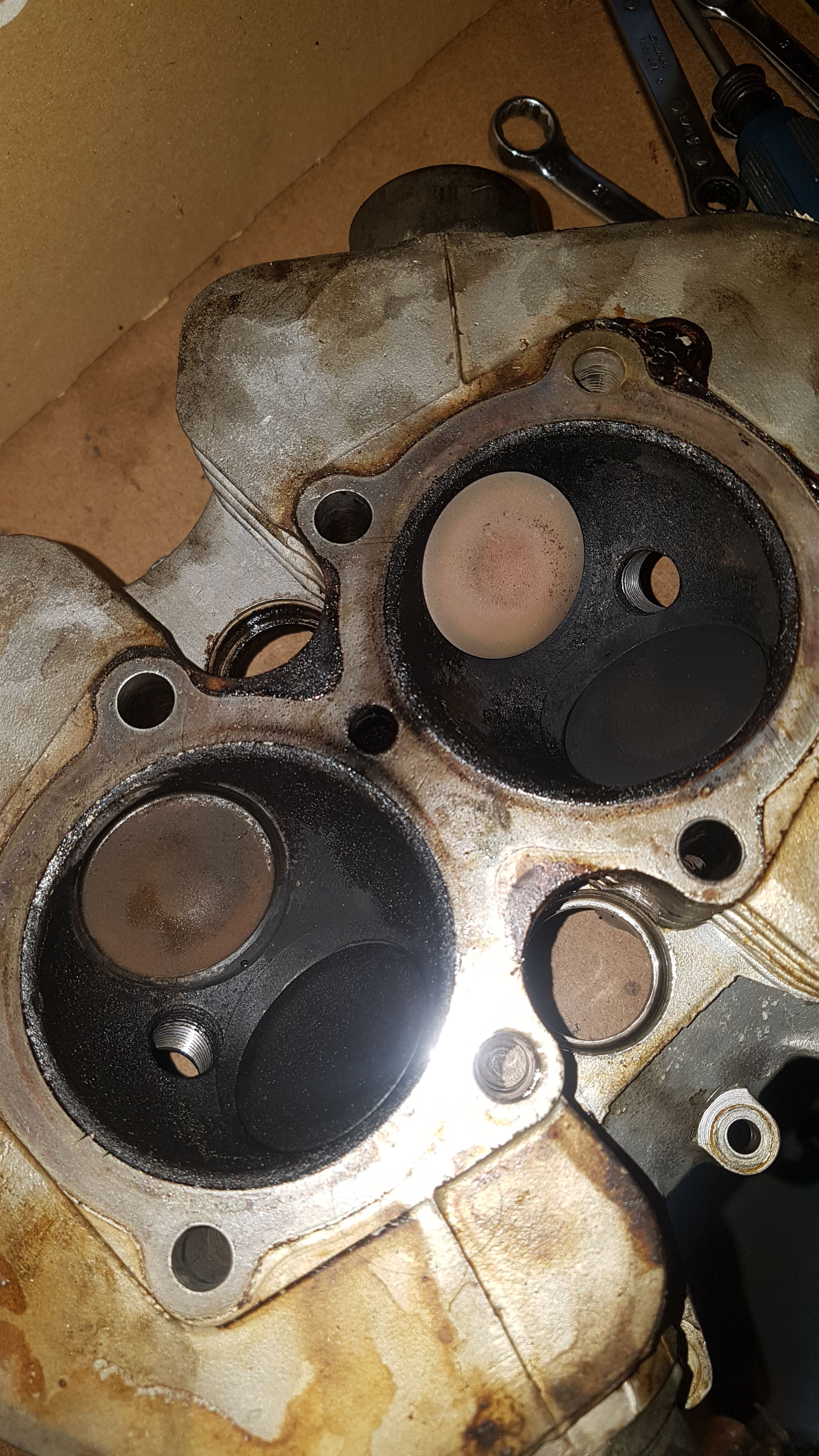

I've given the head to these guys for investigation. When I dropped if off they had what must have been a few hundred grands worth of black and silver bikes in the workshop, she I guess they know their stuff. They also spanner for a BSB team at weekends.
https://vintageclassicmotorcycles.co.uk/
I spoke to 'em this morning. The guide hole has ovalised on the right exhaust valve, hence why it failed. The valve springs also don't match across the head - I guess there was a budget repair done at some point long ago. They're gonna speak to welding specialist to see if the hole can be built up and remachined.
Looking at new guides, valves and springs at the least. A second hand head might well be cheaper than fixing this one, but then it wouldn't be original.

If the bike has been raced, I wouldn’t bank on any parts being “original.”
With luck, the guide hole can be trued for an oversize guide.
The photo makes it look like the valves are pocketed. That’s got to cost a bit to put right. But then it’s not the cheapest hobby.
Re: Classic Triumph Bonneville
The pocketing looks different on each side too? Might explain the different length springs?
As far as originality goes...the engine and frame numbers match. The head isn't serialized so you can't tell if it's the original, however we can tell the date is was made and it's the same age as the rest of the bike so it's a fair bet.

There seems to be plenty of second hand 9 stud heads out there - and significantly cheaper than the the later T140 10 stud heads. I think I'd go down that route, frankly as long as the cases are original to the frame (matching numbers) no-one would know if the head, barrels, carbs etc etc are original
Nidge wrote: Tue Aug 18, 2020 10:16 am There seems to be plenty of second hand 9 stud heads out there - and significantly cheaper than the the later T140 10 stud heads. I think I'd go down that route, frankly as long as the cases are original to the frame (matching numbers) no-one would know if the head, barrels, carbs etc etc are original
I've been thinking on similar lines...
But then if I buy another head I'd probably want new bits in it anyway. Or Id want a freshly built one, which will cost correspondingly more. So what am I saving, other than the cost of the guide hole repair?
Even if you buy a head that needs new valves, guides and springs, those are just service items.
By the way, when a Triumph head is distorted up in the middle, it’s better not to skim it.
Straighten it in a jig, or just let the bolts hold it down flat on the barrel.

That in the photo goes back further than March this year.
What can I say, I'm ahead of the curve.
Don't be jealous.
