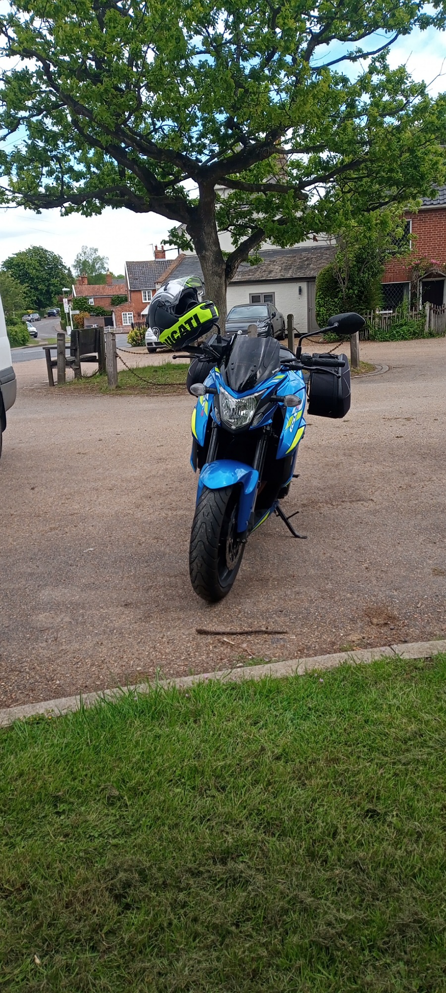

Re: GSX-S 750
Hurt my back so not going far today, thought I'd try my luggage out, took about 20 minuters to put the frame on the bike, they're quit wide, but you don't notice them when riding

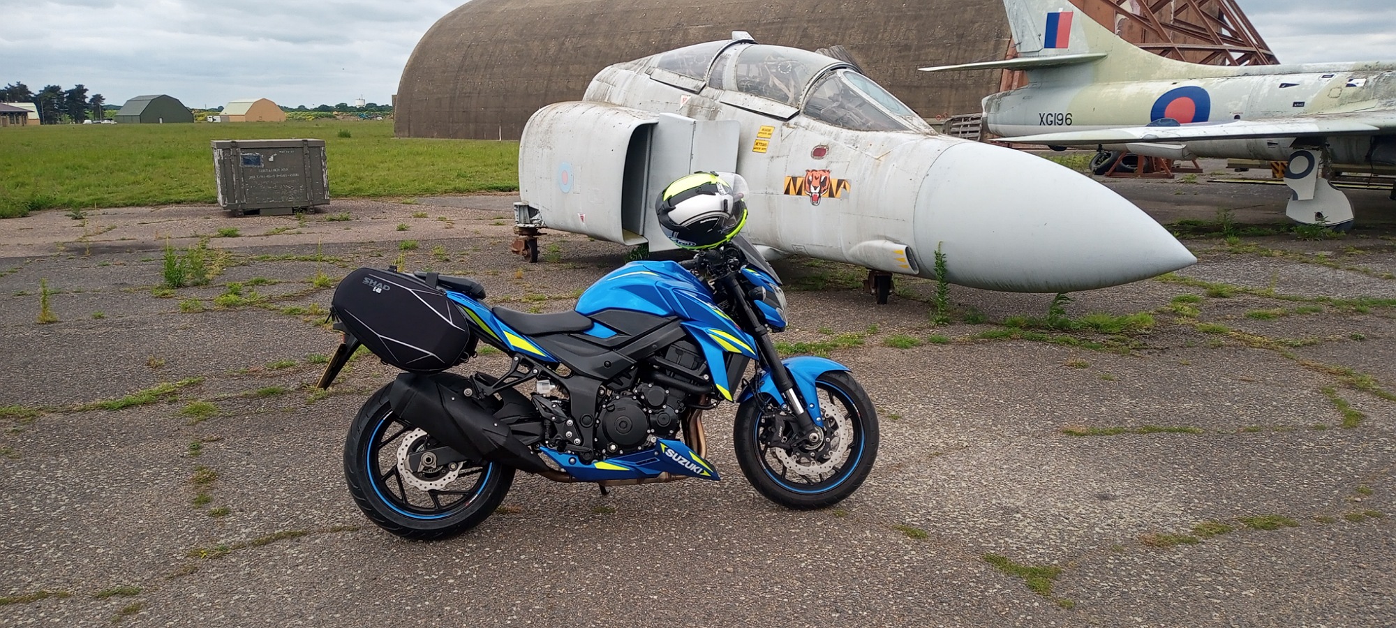

Re: GSX-S 750
Side on picture, what's the link between the aircraft and the bike?
Re: GSX-S 750
They've both got 2 seats
Re: GSX-S 750
Mr. Dazzle wrote: Thu May 26, 2022 1:27 pm They've both got 2 seats
Not the link I was thinking of
Re: GSX-S 750
Is it the black version of the bike being called Phantom?
Re: GSX-S 750
The cockpit is an F4 Phantom?
Suzuki make Phantom editions of their bikes... which yours isn't one of?
