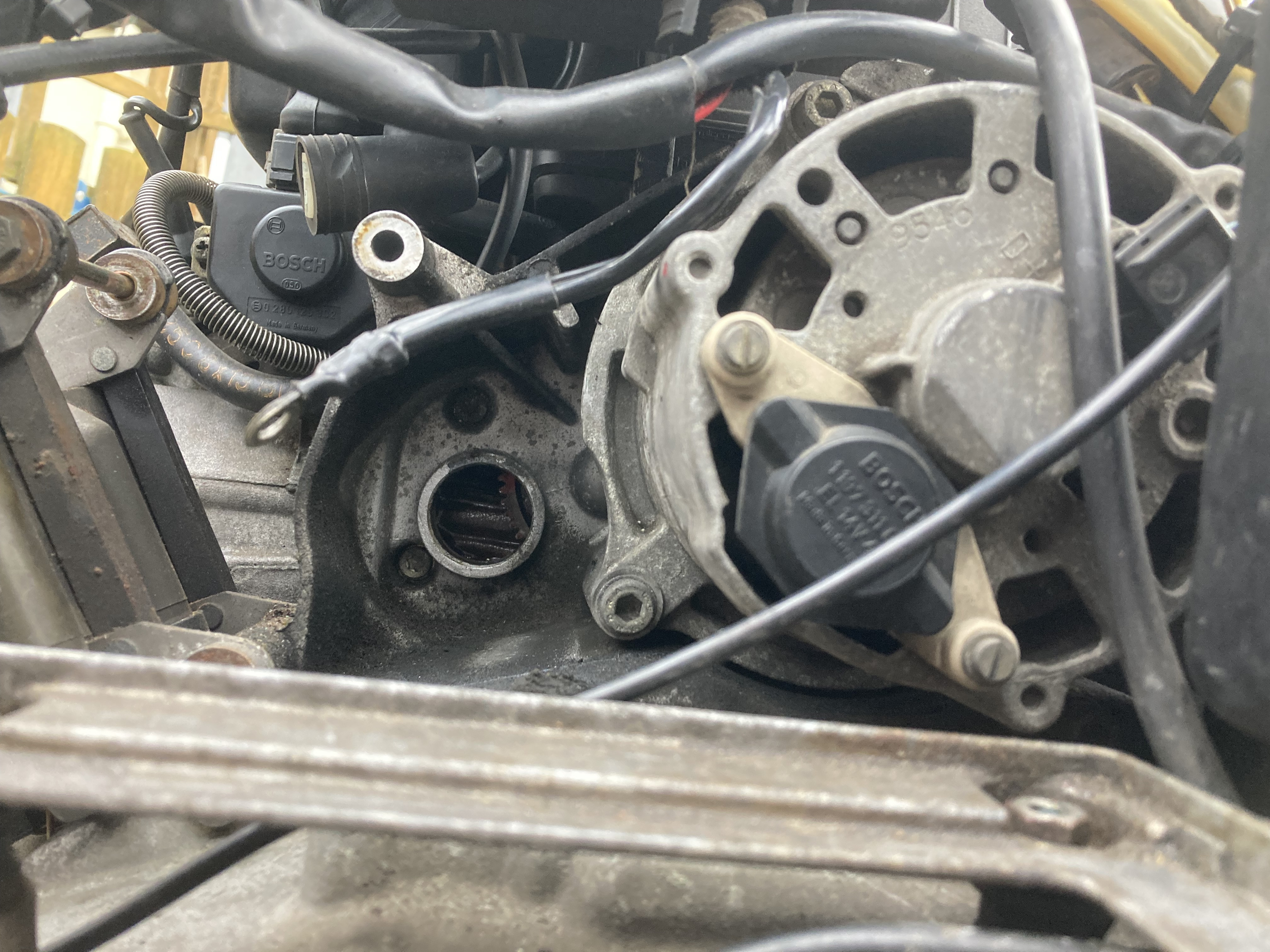

I’ve cleaned up the earth point on the engine case and +ve to starter motor, used another battery and it still runs on without firing up inly stopping when -ve to battery disconnected.

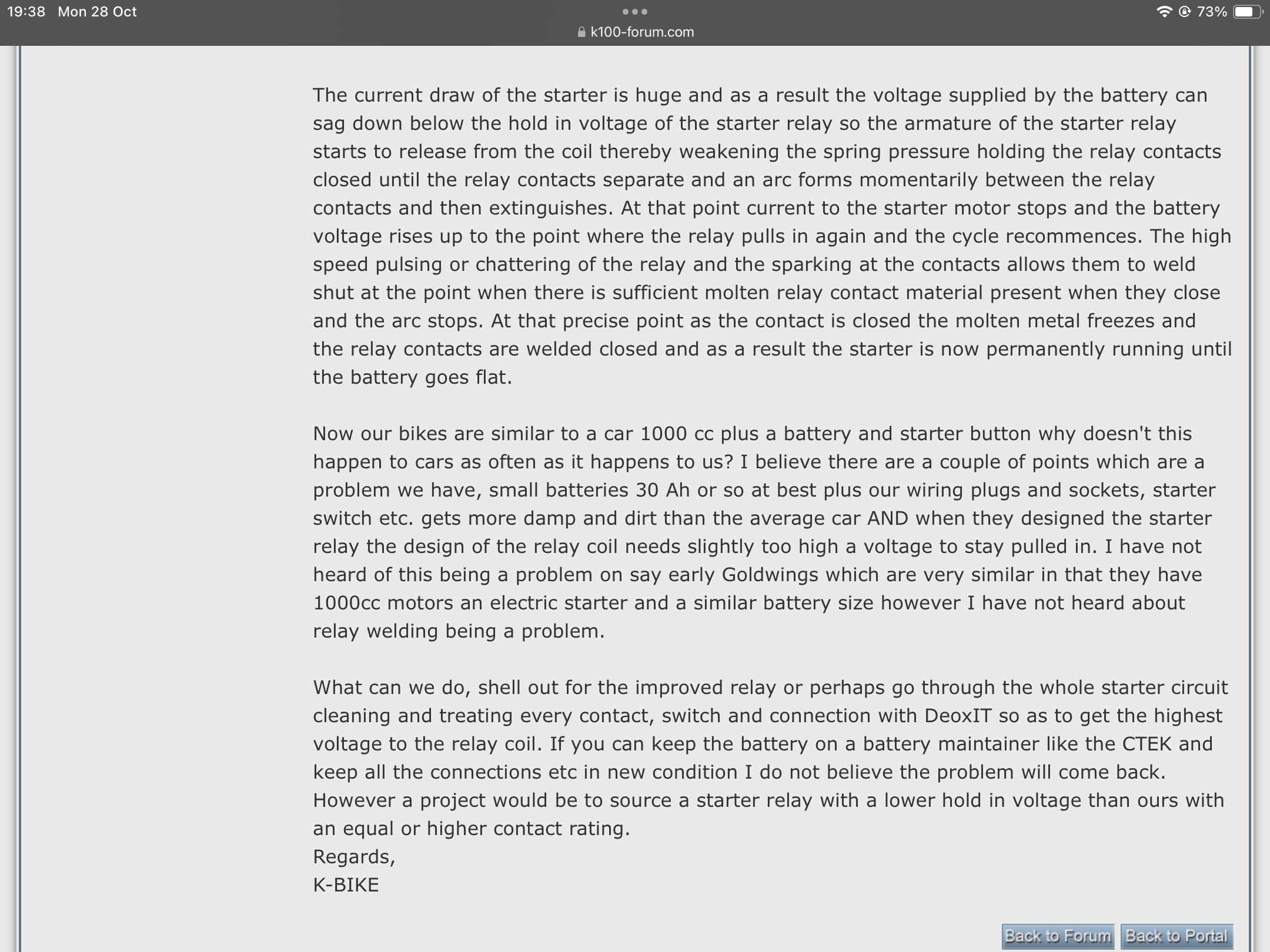

I was struggling to understand what is going on here when the starter continues to run with ign and killswitch off, fuses pulled etc.
This was on the excellent K100 forum.

Gregor wrote: Tue Oct 29, 2024 10:44 am I was struggling to understand what is going on here when the starter continues to run with ign and killswitch off, fuses pulled etc.
All sounds logical enough.
Keep the battery charged and get a good relay.

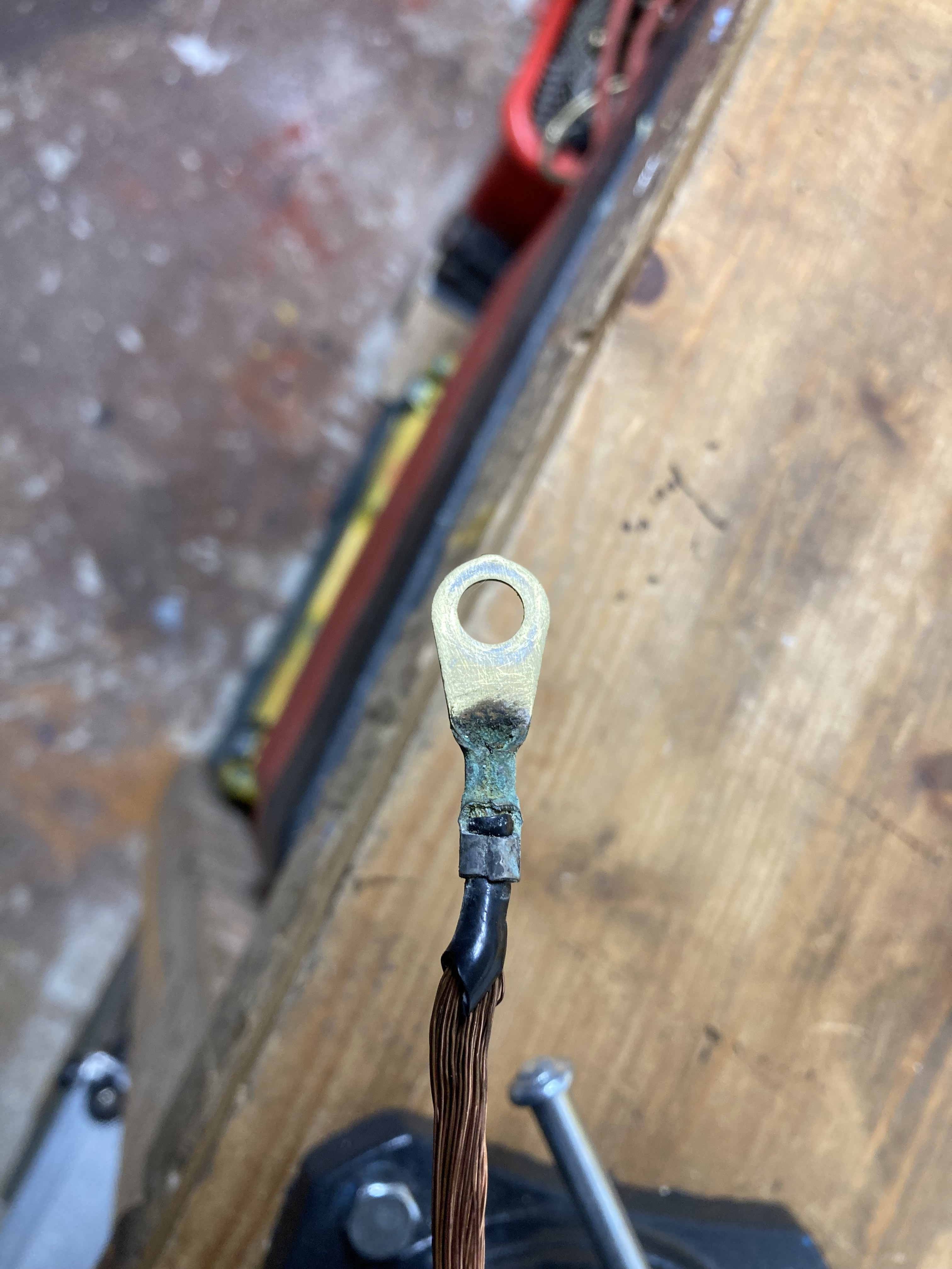

The old battery negative cable to ground on the engine did not look very healthy.

Gregor wrote: Tue Nov 05, 2024 5:42 pm The old battery negative cable to ground on the engine did not look very healthy.
And, the winner of this year's "Understatement of the Year" goes to......
