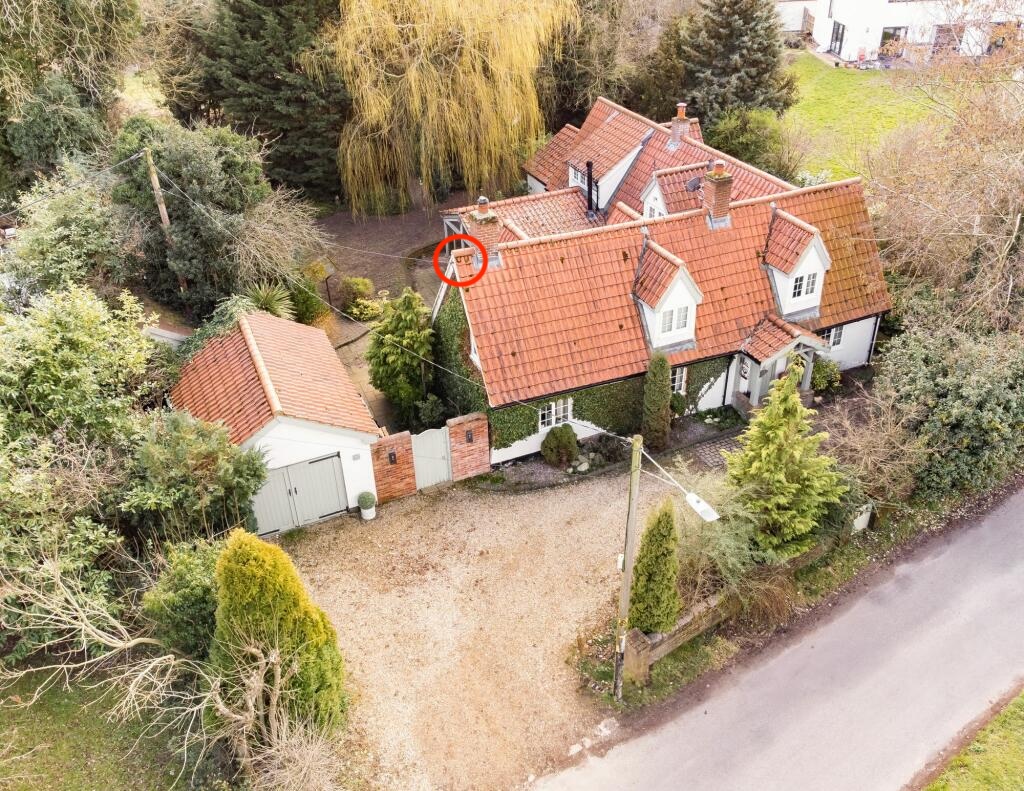

Its view if the sky is pretty bad in the test position as it's next to the house and there are several trees. In the new house it'll be installed here...

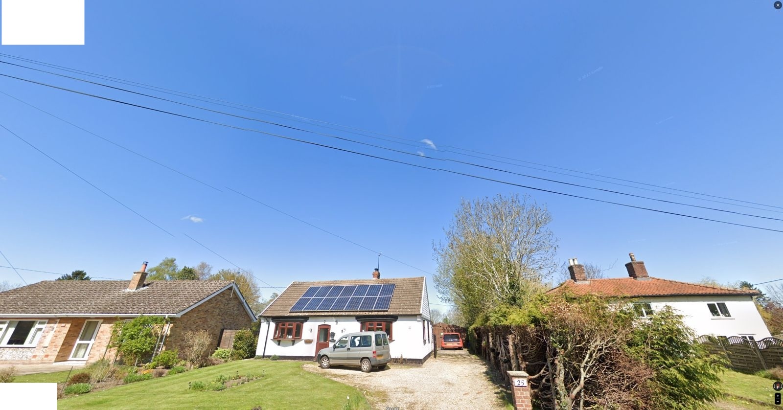

...and the view of the sky north is this and as the 'dish' is above the phone lines it should work pretty well...

Isn't the chimney in the proposed mounting position at risk of blocking the signal ?

It might do. I'll have to check when I get there. There are plenty of alternatives, even moving it down the roof to the front may be an option. It may be better at the top of one of the windows to the front but I'll have to see when I get there.

Looks like a very nice gaff. Hope the move goes well. :thumbup:

Lovely house btw

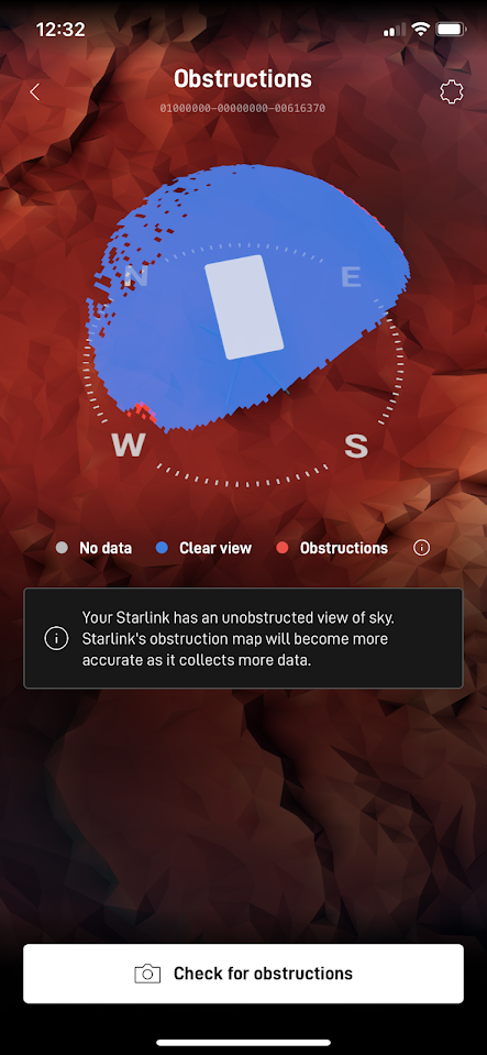

Anyway I installed the dish half way up the right hand side of the garage eves. On a test it seemed to want to point in a direction where the view of the sky was clearest in that direction. The obstruction map looks really good...
Speeds seem be ok. Starlink itself reports that it's getting 175Mbps down, 25 Mbps up and the latency is 28ms. I've had to build a mesh with 5 tplink nodes as the walls are pretty thick but wifi performance is excellent. The tv is wired to the hub and doesn't have any problem with 4k streaming. The only thing I've not yet tried is online gaming but I need to hard wire the office to the hub for that but it should be good.
