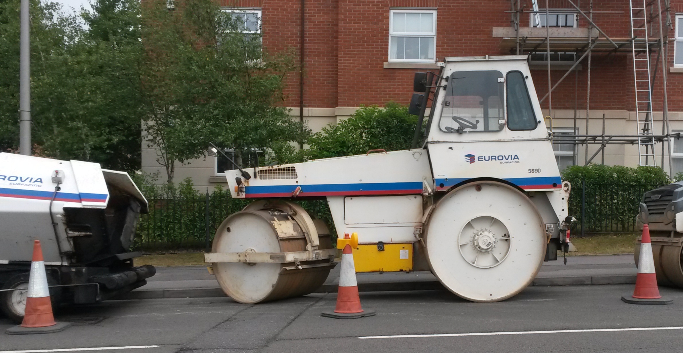

You wouldn't want one of these rolling away
