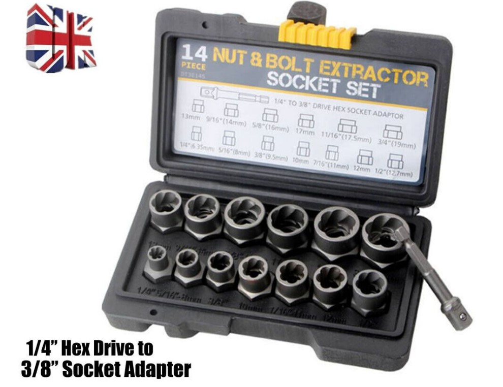

Other half has lost the locking wheel nut key. Despite the shape matching up the eBay replacement doesn't fit - number 805 for what it's worth. I'd rather not pay Halfords to come to do it so was thinking of trying these:
Nut & Bolt Extractor.jpg (114.08 KiB) Viewed 1117 times
Anyone tried these before? Appreciate I'll likely muller the locking wheel bolt but I'm fine with that.

That's essentially all a garage is going to use/do. Whether i'd use a set that looks like it's £4.56 on Ebay though... i don't know :D

Will they fit in the wheel recess? My locking nuts are recessed into the wheel, a socket or the proper key will fit, but some of those look to have quite thick walls?

weeksy wrote: Tue Feb 13, 2024 12:07 pm That's essentially all a garage is going to use/do. Whether i'd use a set that looks like it's £4.56 on Ebay though... i don't know :D
Yeah, the one pictured was the first set I came across on eBay so is only for pictorial uses. :D The other sets are the drill-the-bolt/reverse thread types which always seem a bit of a gamble.
I had a cheap set years ago. They were useless.

TBH i'd ring my local polish/rasta/east euro part worn outfit and say "how much to get of 4 locking wheel nuts" i bet it's not much more than the price of the decent version of that tool and a shit load less effort.

Last time I had this problem a local garage did it in a few minutes. Agreed, locking wheel nuts are the work of the devil.

Forget a 3/8 inch drive! I have two half inch jobbies...they got the soft as shit Ovlov nuts off....if you are near Weston S M pop by...
Posts: 2432
Re: Removing locking wheels nuts without the key
The problem is not mullering the nut (it will)....it's getting the wee scrote back out again

The Irwin extractors are pretty good. Used them a couple of times on lost-key wheel studs.

My locking nuts are in the canal. You could be careful and weld a nut on it or find someone with the same car and wheels and ask if you can loosen your nuts and replace them with normal ones.
