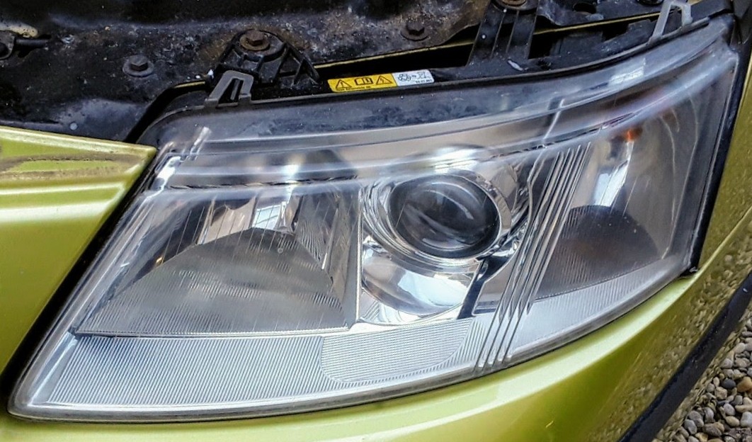

Demannu
Posts: 1882
Has thanked: 65 times
Been thanked: 1234 times
Re: Headlight Restoration Kits
Post by Demannu »
Foolishly I didn't do a before pic!
But Mr MOT mentioned the discolouration/opacity of the lights as an advisory, so went to work with 2k wet and dry, and finished off with 5k.
