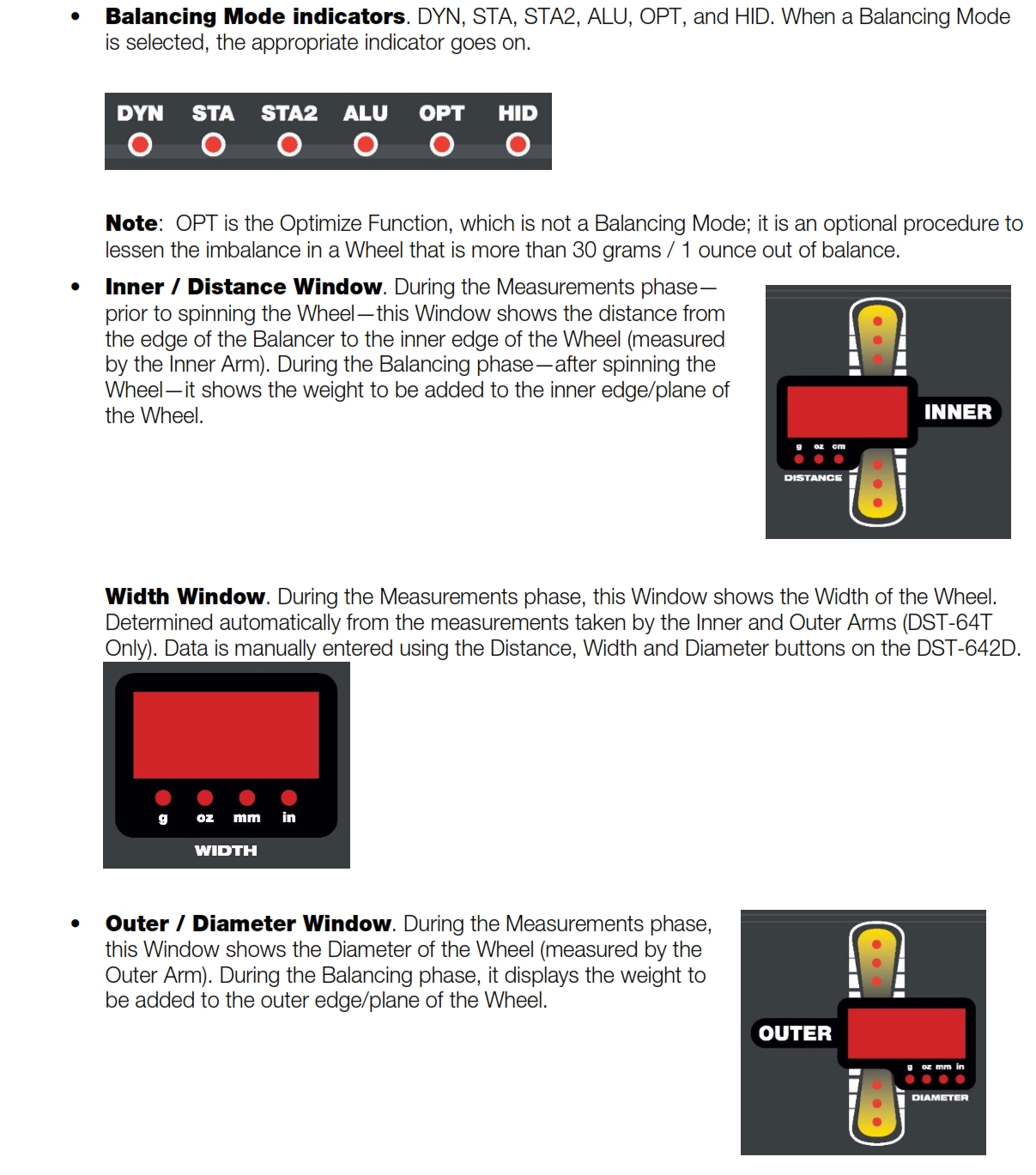

Mr. Dazzle wrote: Fri Aug 04, 2023 9:56 am Do normal modern wheel balancers tell you which side to stick it on?
I've balanced (well, arranged for someone else to balance!) loads and loads of things. Spent a lot of my career working on prop shafts, high speed motors, fancy flywheels etc. so I've specced and done all sorts of balancing. I always assumed most road tyres/wheels are just single plane balanced? Anyone know?
Bikes don't generally need dynamic balancing because the wheel is narrow. Proper car balancers definitely do need dynamic balancing but in my experience operators don't always understand this. Latest machines don't rely on operator skill and just tell the operator exactly where to place the weights.
Here is a page from the manual of a professional machine
When the wheel is dynamically balanced it shows the operator which side to place the weights ( inner plane or outer plane). Elsewhere the manual also says that static balancing should be selected for motorcycle wheels.
There is still a problem with balancing a new tyre because its shape will change when it has been through a few heat cycles. In an ideal world tyres should be balanced after about 100 miles of use.
