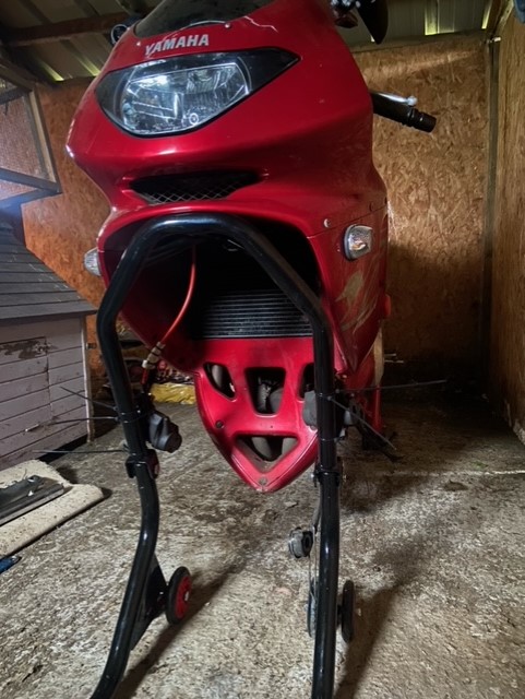

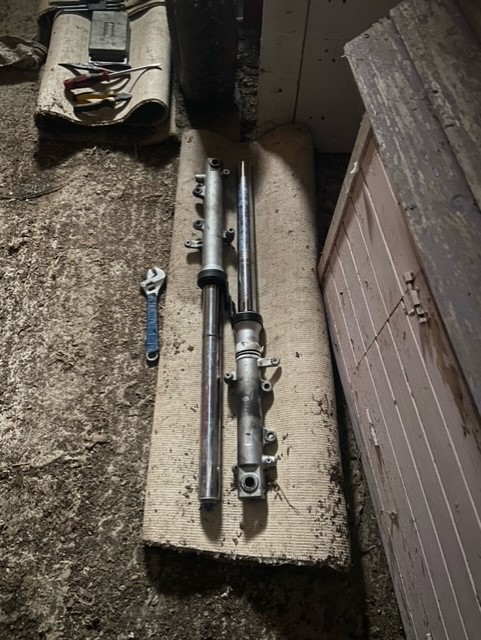

Thundercats are not go, unless I wheelie everywhere. The front forks are off ready for the overhaul with new stanchions, oil seals, dust seals etc.
After yesterdays front paddock stand little problem. What problem? :D
And this is the Thundercat all upgraded and finished. Street-fightered....... Whaddya think? :D
