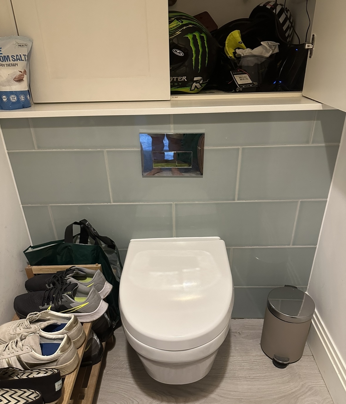

Right. So a strange one here.
Our ground floor toilet it’s leaking, it’s tiny but it’s leaking, it’s not constant but it’s leaking, it’s floating (hanging on the wall) it’s a new build so in who Evers infinite wisdom there are no access panels for access. The tiles either side on the floor where it’s joined are slight cracked. I am assuming it’s just fitted badly.
Had an emergency plumber come today and say he can’t do anything as they can’t start ripping off tiles or cutting holes.
£109 for nothing.
Now my question is what the f**k do I do?

Re: Floating toilet leaking from bottom
I was watching a YouTube video on how to fit one and if you can find it it'll give you some idea, unless they've done a really cack-handed job. You should be able to a) take the chrome panel off and have a squizz and isolate the water supply and b) remove the bog and sort out the waste joints if that's the issue. Emergency plumbers tend to be the bottom end of the plumbing league.
Where's the water appearing? Could be the tank is overflowing if it's intermittent. Dodgy siphon maybe, with no external overflow. (That's my prediction).
PS It looks like they put the shelf on, then fitted the cupboards (been there
). If the shelf does slide out you might have access to the tank/siphon. You may be in 'cupboard dismantling' territory.

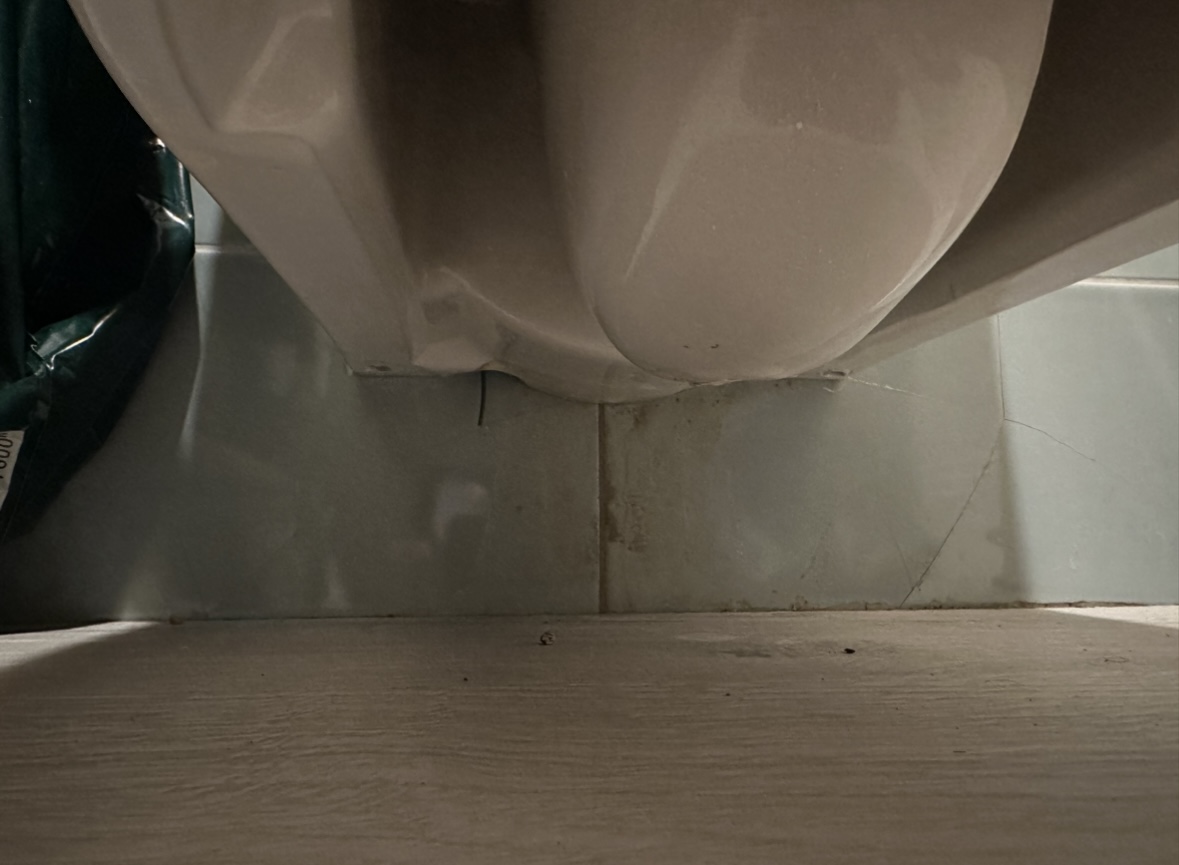

I’ve seen the videos where they remove the silver covers and fiddle around. But I’ve not idea how that can get to the cause of the leak (this is well past my understanding)
Also how does the pan connect to the wall??? I can’t see the screws to think about removing it
It seems to be leaking from the bottom here
Which bunch of cowboys tiled around the pan instead of behind it?
4 mins in shows how wall hung are installed so hopefully will give you a clue how to uninstall.
The good news is, you should be able to remove the pan to see where the leak is coming from without too much hassle but you’ll be losing a few tiles along the way* and there is no guarantee you won’t need to remove the tiles / plasterboard from that section of wall to resolve it. Just make sure the tiles go back on the wall before the bog.
* you may be able to minimise this by scoring through the silicon with a sharp Stanley blade before looking to loosen any fixings.
The cracking on those tiles suggest that the bowl has moved (if they weren't broken when it was fitted) which may have unsettled the waste pipe. As Sillycar says, you can remove the bowl (logically they put it on last so there's got to be a way of getting it back off again).
TBH if you're not happy with plumbing I'd get a proper plumber/bathroom fitter in and get them to do it/tile/refit it all properly. I'd ask the neighbours if they can recommend one - there may have been a bit of demand!
So if I grip the bowl from the bottom and can very gently lift it up and down a small amount.Count Steer wrote: Sat Jul 01, 2023 8:50 pm The cracking on those tiles suggest that the bowl has moved (if they weren't broken when it was fitted) which may have unsettled the waste pipe. As Sillycar says, you can remove the bowl (logically they put it on last so there's got to be a way of getting it back off again).
Yeah. Probably needs taking off, the joint lubed and remounted properly - unless the frame isn't secure. Be good to tile it properly so it sits flush to a solid surface. As mentioned, those cracked tiles suggest it's flexed on the mount a bit. There's quite a bit of force/leverage involved, particularly if you have a weighty visitor so they need to be rock solid.formula400 wrote: Sun Jul 02, 2023 7:00 amSo if I grip the bowl from the bottom and can very gently lift it up and down a small amount.Count Steer wrote: Sat Jul 01, 2023 8:50 pm The cracking on those tiles suggest that the bowl has moved (if they weren't broken when it was fitted) which may have unsettled the waste pipe. As Sillycar says, you can remove the bowl (logically they put it on last so there's got to be a way of getting it back off again).
