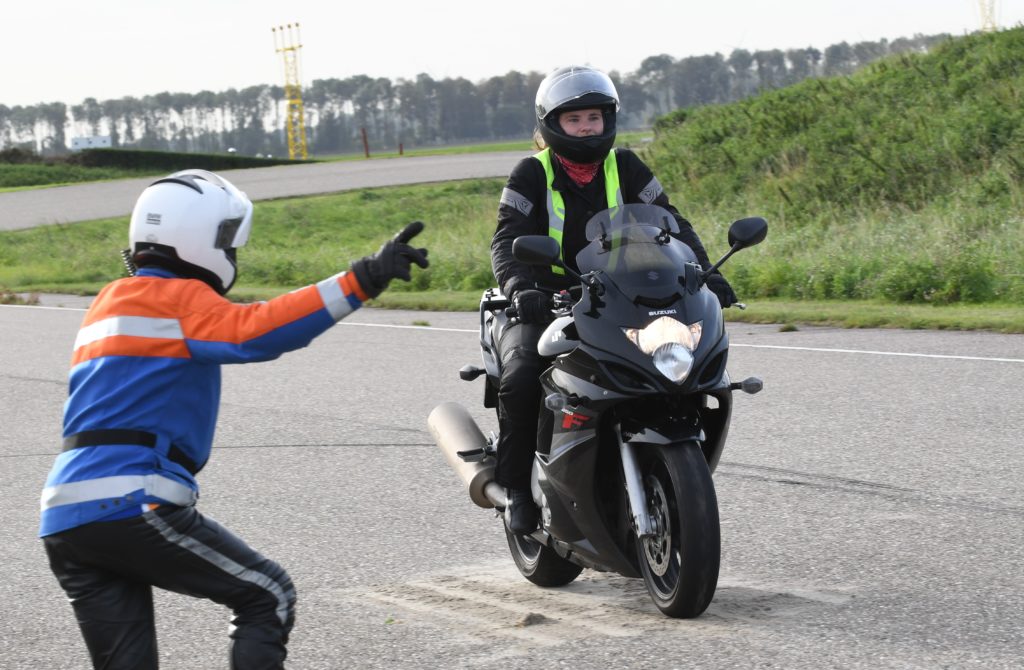

Earlier I said KNMV send riders onto grass.
Looks like they've upgraded :D
https://www.frankvangerwen.nl/abs-stress/
IIRC, https://i2imca.com/ get riders cornering through gravel.

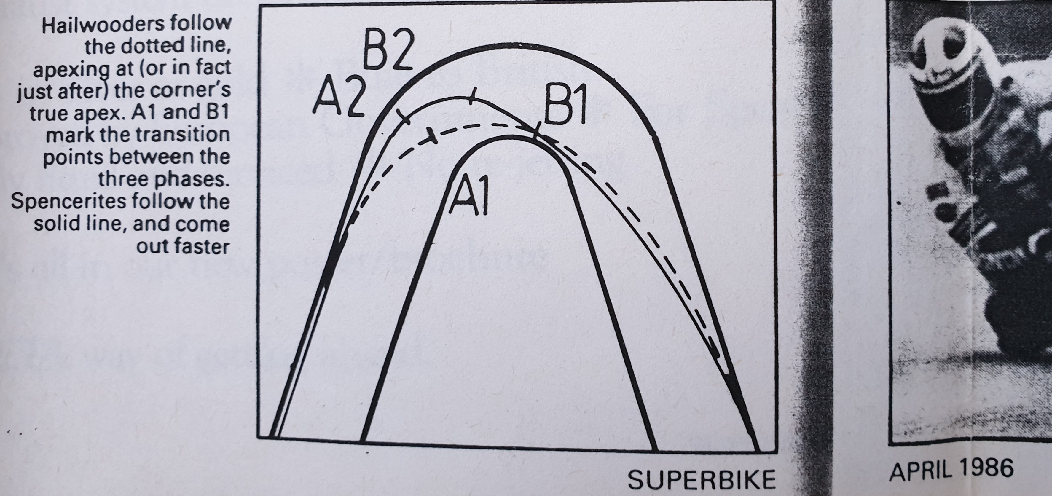

High-level racing has a very different style, think a 'rounded V' braking to turning point and driving out, rather than a smoother, classic, 'entry-apex-exit' curve.
