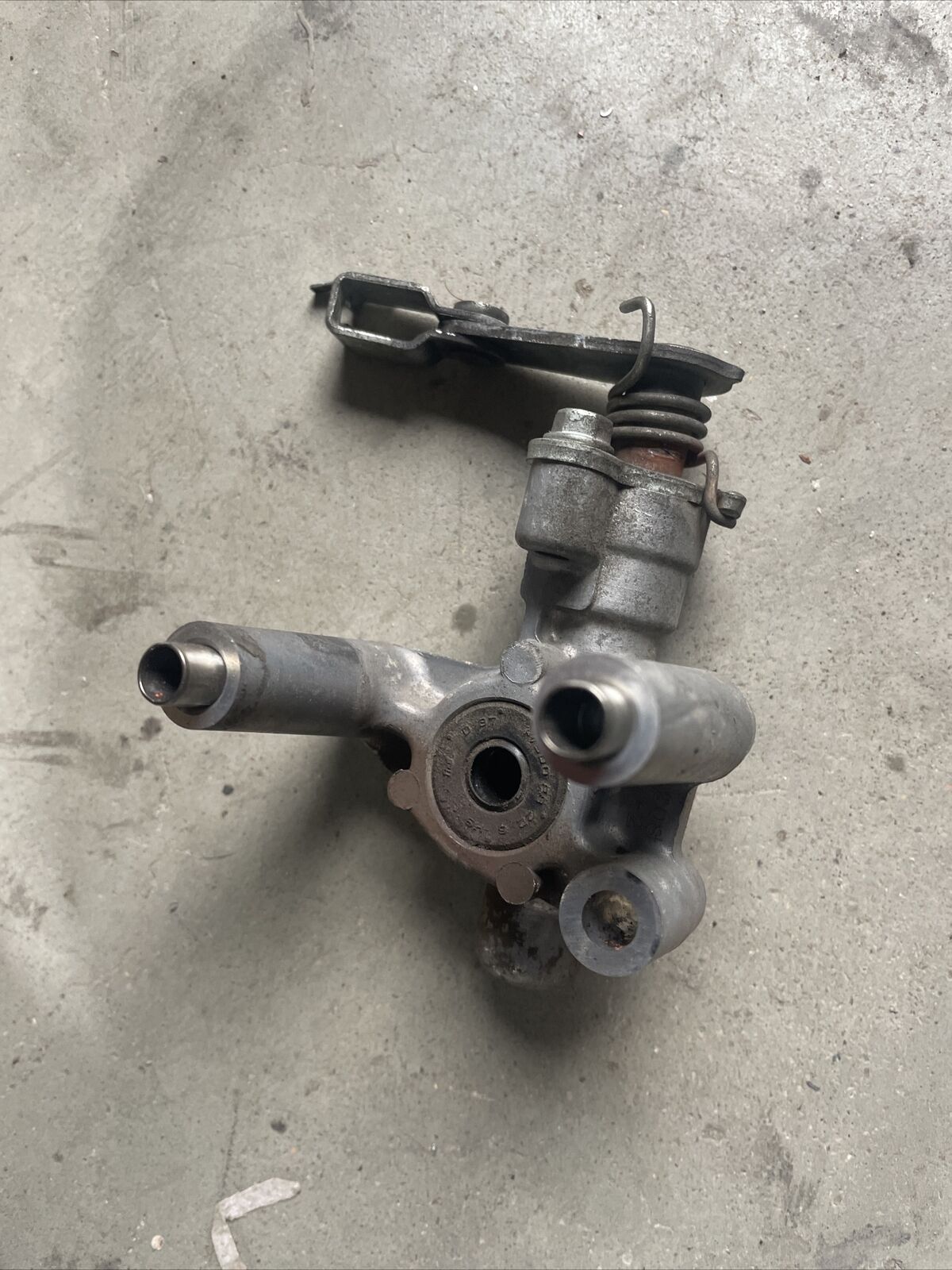

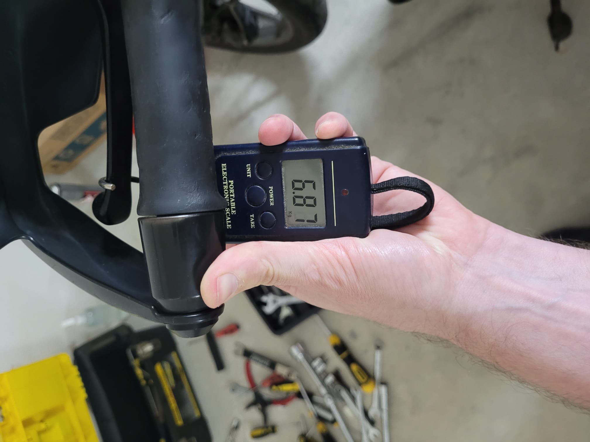

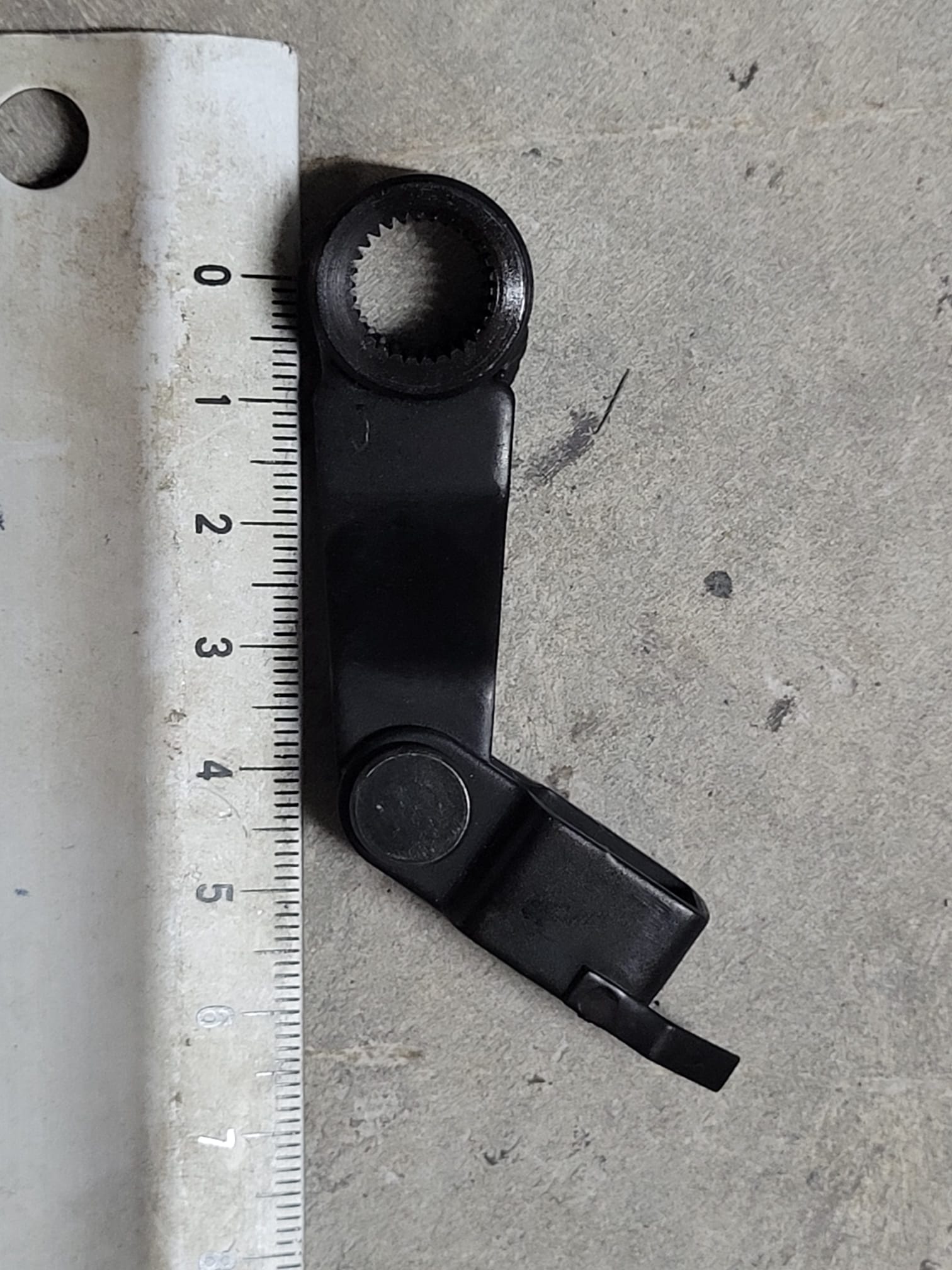

A_morti wrote: Sat Jun 03, 2023 7:42 pm I will add ... the longer clutch pivot arm from an MT-07 to lighten the lever action,
So this is an oft-mooted mod on the FZ6 group, with the overly-concise explanation that it will "lighten the clutch".
Well, we need some science on that. Right?

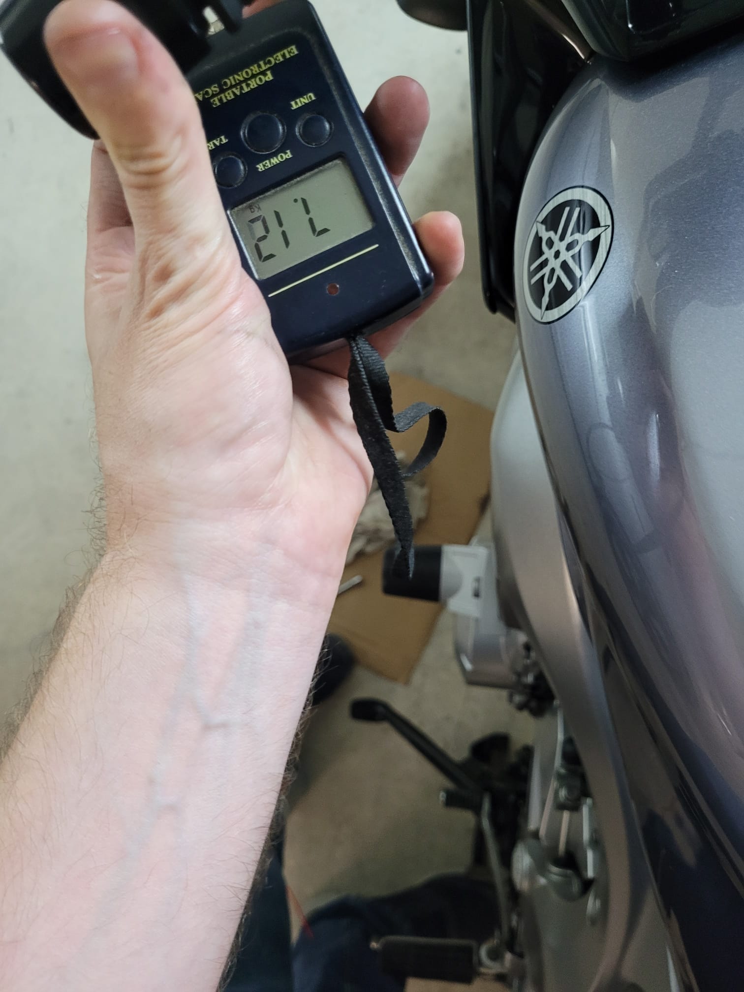

Does the FZ6 even have a heavy clutch? Let's compare to a scientific sample of one: the nearest bike to hand, my g650gs.
Clutch pull weight a little under 7kg. It's not known as a bike with a heavy nor light clutch, which seems fair. That's pretty normal.
Fz6 clutch: fair bit heavier.
Enter MT-07 clutch pivot arm.

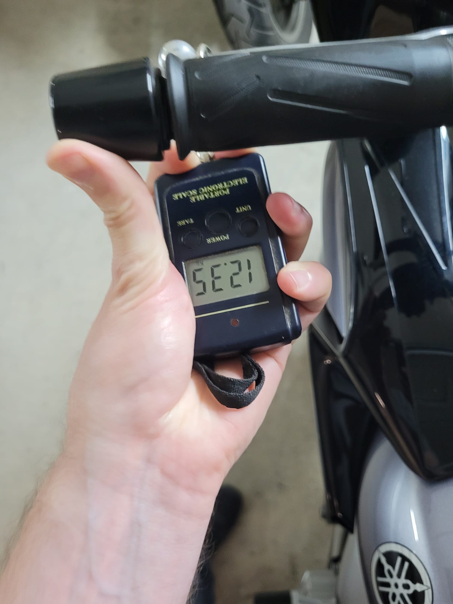

The new one is 10mm longer than the original parts.
The clutch pull weight reduces a lot by those 10mm.
That is about 40% less strength required at the lever. It's really noticeable! Also the friction/slipping zone is bigger, which is nice, because it's too immediate on the bike as supplied.
Winner winner!

Nice work. :thumbup: (I think the first two pics in the first resistance test are in the wrong order but the tank logo makes sense of them).
A_morti
Posts: 1034
Location: Malta
Has thanked: 412 times
Been thanked: 824 times
Re: FAZ 600 - Time Warp 2004 Yamaha FZ6SA
Post by A_morti »
Count Steer wrote: Sat Jun 10, 2023 9:38 pm Nice work. :thumbup: (I think the first two pics in the first resistance test are in the wrong order but the tank logo makes sense of them).
Been on the sauce this evening and can't figure out how to clear the persistent data. Might have fixed it, idk :obscene-drinkingcheers:

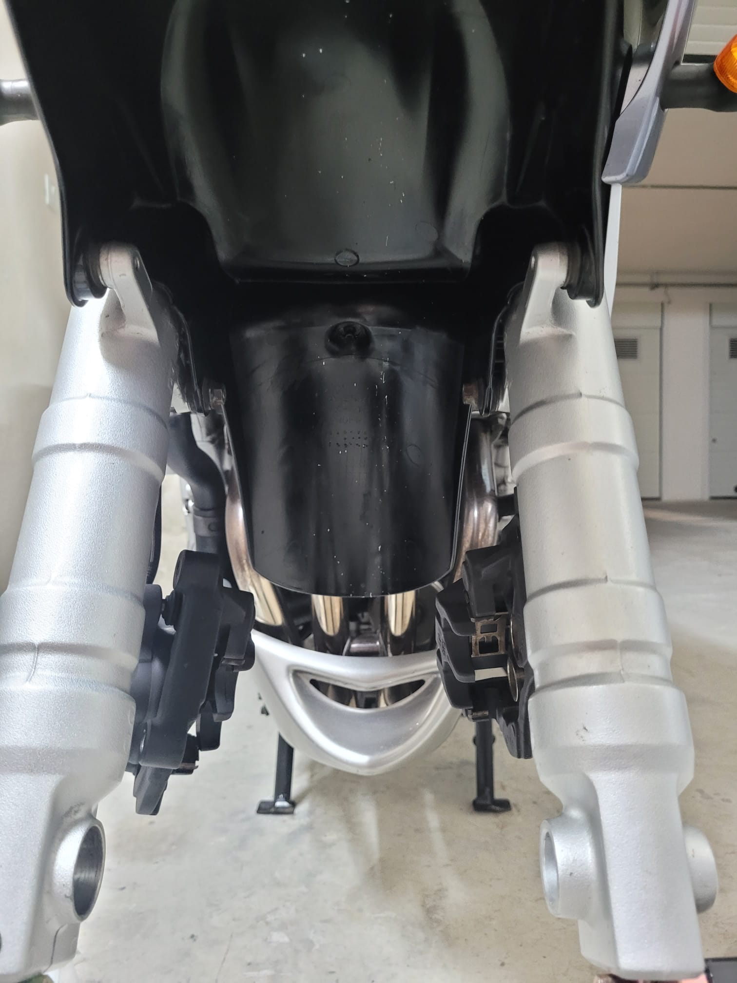

Post by A_morti »

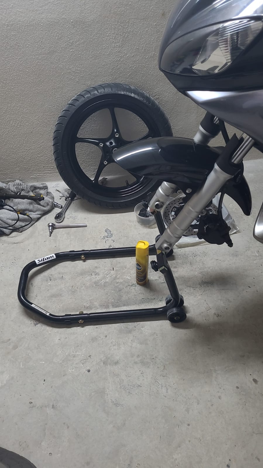

A_morti wrote: Sun Jun 04, 2023 1:50 pm Gave the front brakes a little love...
Should work better tomorrow, if not I'll get the wheel out, discs off and get heavier with the brake clean, maybe look at replacement pads.
It definitely wasn't enough. The brakes worked a bit better, but still not convincing at all. After a rainy day where I took the BMW with its single caliper and it was way better than the fz, I knew there was more to do.
Turns out my paddock stand and the centre stand are a perfect pair. I did have to get a spindle tool (19mm Allen key for this bike) but otherwise no issues.
Spent a couple of hours one evening disassembling and scrubbing the pads with a stiff brush and dish soap, baking them in the oven and then repeating the scrubbing. Then a couple more hours the next evening scrubbing the discs with a stiff brush, using a an icing nozzle brush to clean out what felt 6,000 tiny drillings (thanks to @The Spin Doctor for the idea) then a soft brush to clean across the cut outs etc, and finally scuffing the surface with a scouring pad.
I've not been on a proper test ride, but at least around the underground parking it can now lock up the front wheel pretty easily, where it just drew up with a squeak before.

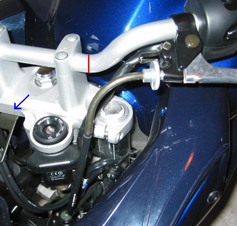

It does require a longer throw at the top, but on this bike that's a very good thing. Every review you read on the bike has something negative to say about the clutch:
Grabby clutch: https://www.visordown.com/reviews/motorbike/fz6-review
Grabby clutch: https://www.bennetts.co.uk/bikesocial/r ... value-spec
Heavy clutch: https://www.motorcyclenews.com/bike-rev ... azer/2004/
Heavy clutch: https://www.devittinsurance.com/bike-re ... zer/?amp=1

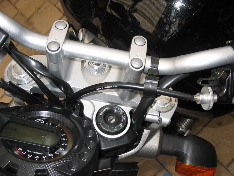

This mod fixes heavy by giving more leverage, and grabby by giving a wider slipping zone. Lengthening that lever really has no downside on this bike.
The adjuster stayed well within the usable range. Albeit I reckon the cable has about had enough after 20 years but only 9k miles. To get the cable to clear everything, they put a fairly tightly bent "noodle" at the top. Seems that when the cable is not regularly lubricated, the inner cable saws through the teflon liner, after which the inner cable drags across the inner face of the noodle.
Pictures from here show the difference between the cable on the faired one with the noodle and the naked one without it.
fz6n clutch.jpg (88.73 KiB) Viewed 2092 times
I'm tempted to try the cable from the naked one, but not convinced it'll run cleanly around the fairing stay. An OEM cable is 60€, but a replica is more like £10. Might be worth throwing a tenner at it just to see what happens, although the Visordown review of the naked version gripes about the clutch cable blocking the keyhole. Can't win, apparently!

A_morti wrote: Mon Jun 19, 2023 6:36 pm Every review you read on the bike has something negative to say about the clutch:
I always find things like this fascinating - that the bike made it all the way through development and testing without a flaw, that's mentioned almost universally once it's been launched, being picked up and dealt with!
Interesting that they had to change the cable routing because of the fairing stay. I always understood that Teflon-lined cables weren't supposed to be lubricated because oil made the Teflon swell.
The XJ6 has a metal 'bend' at the top of the cable too, though not so much of an angle.
It's got a pretty heavy clutch action too... I will get a measure out - maybe I can do the same tweak.

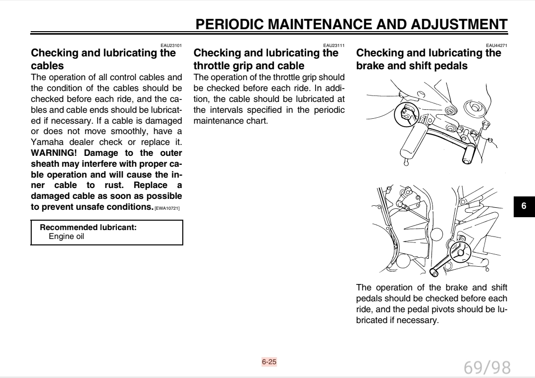

The Spin Doctor wrote: Mon Jun 19, 2023 11:45 pm I always understood that Teflon-lined cables weren't supposed to be lubricated because oil made the Teflon swell.
Same, but apparently Yamaha knows different. Or maybe the cables aren't Teflon lined?
Screenshot_20230620_123939_Samsung Notes.jpg (247.2 KiB) Viewed 2056 times
The xj6 clutch cover doesn't seem to have an actuator in it. Does it attach on the other side of the engine? In any case, should be possible to get a similar improvement if you find a longer actuator.
