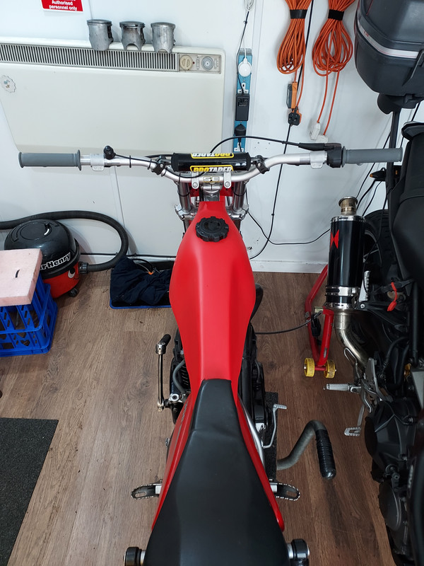

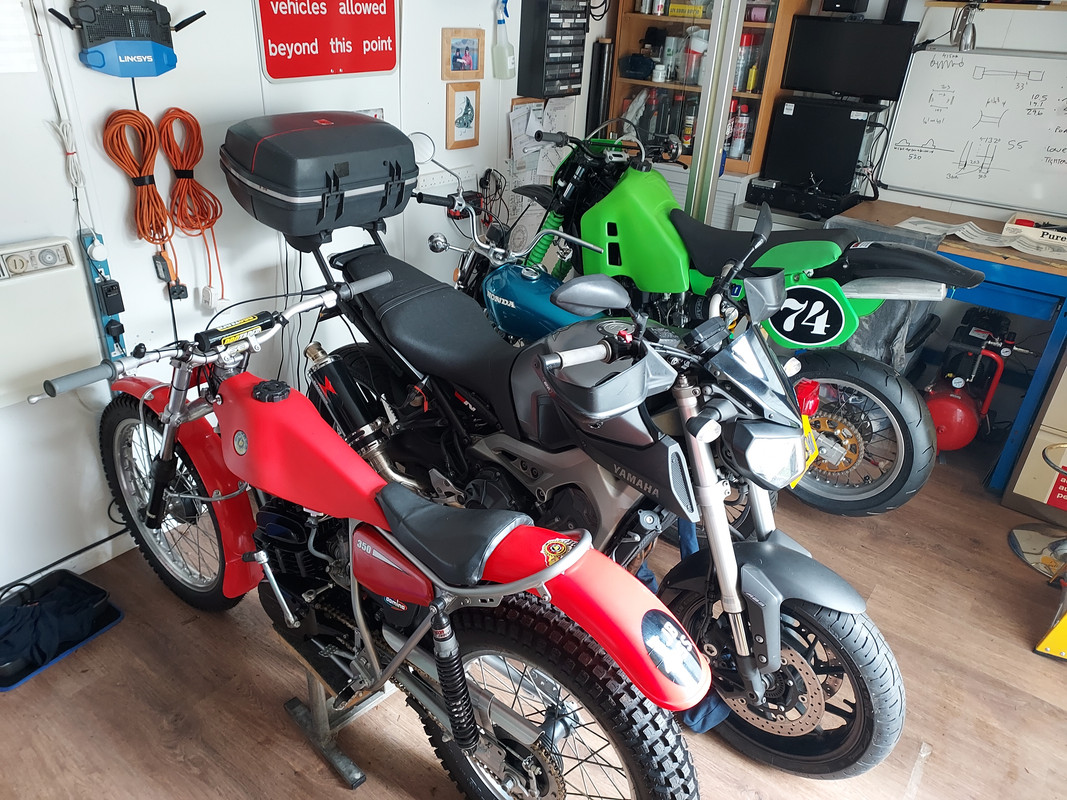

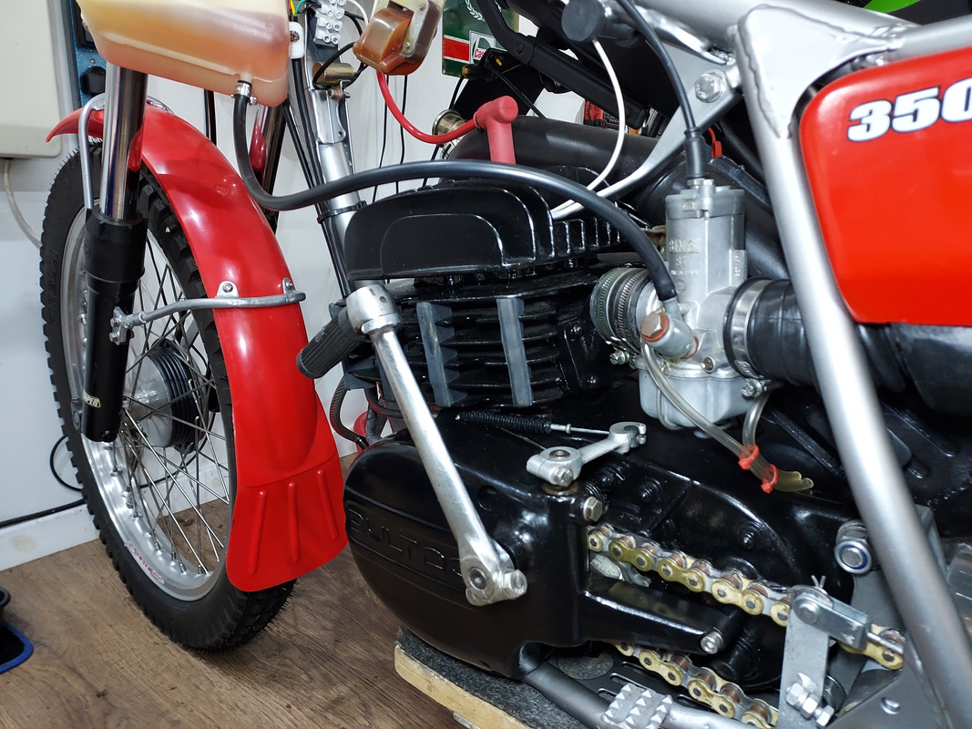

Back from hollibobs yesterday. Managed to find a .pdf of the Hayes manual and then popped into Gordon Farley's to get some fuel hose for the temp tank and some new spark plugs. Took a good look over the bike and it's pretty simple (as expected), but nothing seeemed missing apart from there were no overflow tubes on the carb so I stuck a couple on and split the ends to prevent them getting blocked with crap.
Gapped the plug to 0.4mm, set the mixture screw to 1.5 turns out and started getting to grips with the LHS kick start...and it starts and idles okay.
Tank and seat back on and time for a beer. When it's not pissing down I'll take it for a potter round the garden. Then get it insured and take the V112 to the post office to get it registered as a historic vehicle. Then...a few local byways.

Sweet, that really is in exceptional nick. :thumbup:
