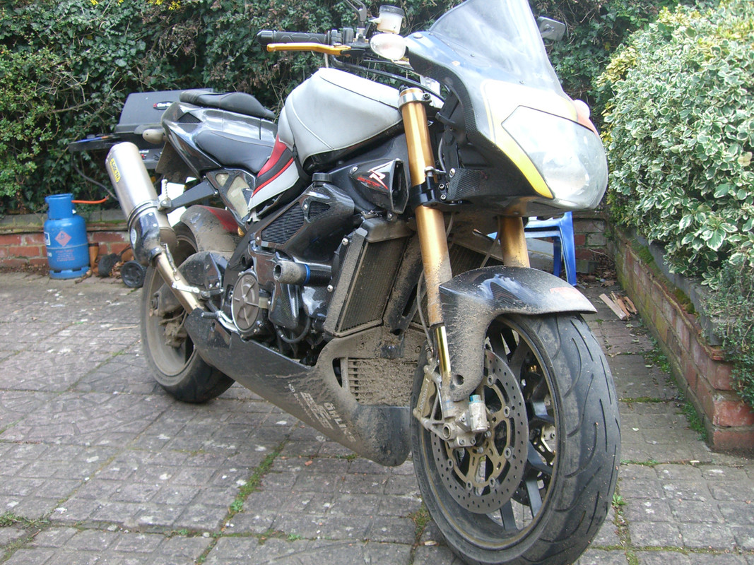

This is one of my "keepers"- well, at least it is now :) - this is is a pic of it back in 2008 not that long after I bought it , with added grippy pillion seat as I used to take my (then quite young) boys out on it.
So, a bit of background on it- I first bought it when it had just turned three years old and had very little mileage on it, from its first and then only owner, who was also the owner of a UK bike race team.
It’s one of the last Gen1 Tuonos , and a “Factory Racing” which was a limited run Aprilia produced back then – there’s more detail on them here https://www.bennetts.co.uk/bikesocial/r ... acing-2003 if you’re interested, but in short, it's a blinged up edition made specifically to try and win an Italian naked race series, and as such it came with lashings of carbon, a “ race kit” (which I still have in the boxes) which includes another carbon nose cone with no lights, additional full length carbon bellypan, race exhaust, chip for the ECU, race-shift gear linkage, and a few other cool little bits.
The bloke I bought it from back then wasn’t a fan of Aprilia’s cosmetic detailing and was a bit of a tart like me too so had it largely de-stickered, and the original white Oz wheels powder coated satin black.
He also put one or two extra carbon bits and bright gold ASV levers on it- nice quality levers but I always thought the gold was just too tarty , never did anything about it back then but have recently replaced them with the original type black ones.
Back at the time when I first bought it, I also did a few other minor mods/ replacements, including replacing the offensively loud carbon tri-oval exhaust can he had on it with the road-legal but still lovely sounding Arrow you see on it in the pics, and I also did the clutch oil jet mod and fitted an Oberon slave cylinder to make neutral easier to find and the clutch action a bit lighter.
Anyway, me and V2 ONO ( yeah corny / twatty / tarty perhaps I know, but it’s THE number plate to have on a Tuono if you’re going to have a vanity plate I reckon and I think it’s 8-) ) had a huge amount of fun over the following eight or nine years, including doing both the Wales and South West rallies on it with a couple of mates during that time.
I never took it on track as I would have cried if I crashed it as some of the bodywork is not replaceable, but mainly as I had my trusty ZX10 for that and was into chasing lap times at that time so never felt the need.

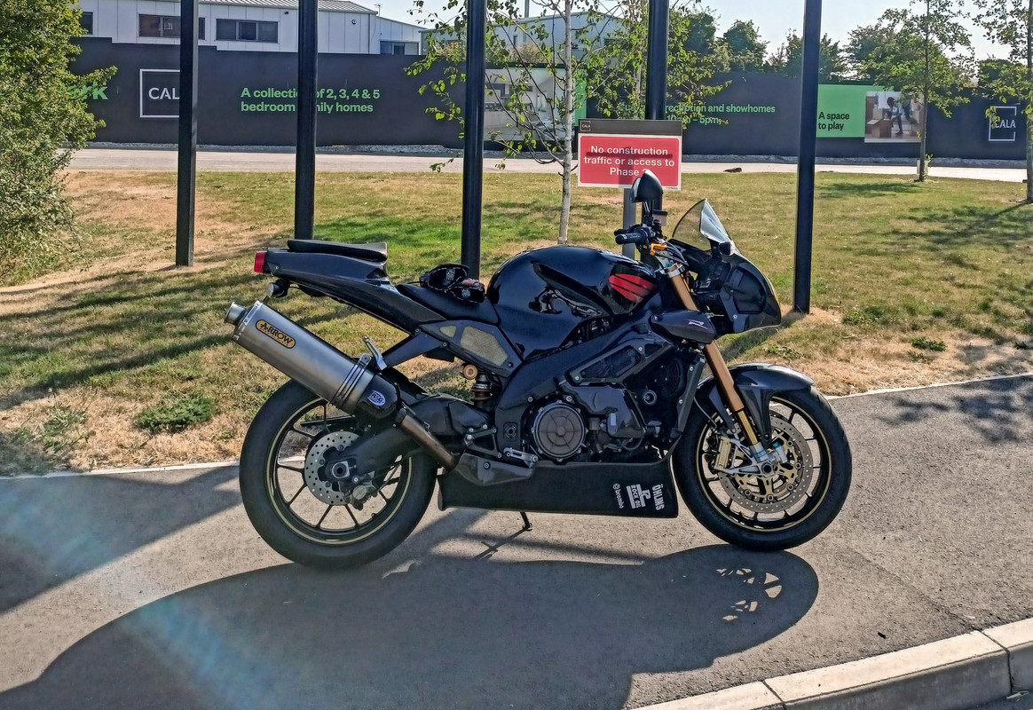

So I stuck an MOT on it last year and had a few great little early morning blasts on it, but being honest it hasn’t had much use since then, but then neither have any of my road bikes recently...
this is it autumn last year - it's got the OE Aprilia mirrors back on it, and different tyres, but apart from that, just about exactly as it was back in 2008
Anyway, with the weather getting very much better that will change and it's going to get a little bit of attention in the garage first so I’ve made some purchases- there are more bits arriving as I type but here's some of them:

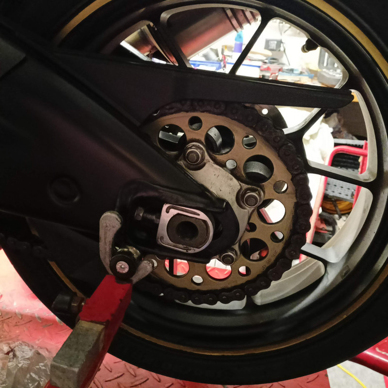

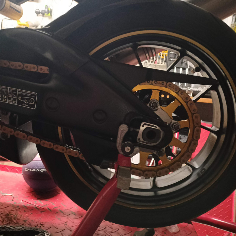

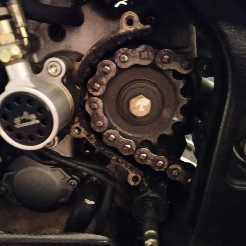

Have spent a bit more time in the garage over the last week or two, Mr Angle Grinder was brought into service and the new chain and sprockets are now fitted, and of course it's also had a good clean around the gearbox sprocket- the cover hadn’t been off for a good few years so it was pretty manky in there
I've probably said this to anyone who will listen whenever I've removed the rear wheel of any bike but why other manufactirers can't make it as simple as Aprilia do on this bike beats me- it doesn't have any special captive spacers or QD fitments, but the rear caliper just sort of acts as a nice guide for slotting the wheel in, the spacers don't fall about and you don't have to faff about trying to support the rear wheel with one arm/ legs whilst trying to get the spindle in- it's just easier on these bikes as standard than the vast majority of others. Anyway, I digress...
Now that the new stuff is on, I am in two minds as to whether the combination of the gold coloured rear sprocket AND chain is too much- my current thoughts are that it is just a little bit too Bellwood/Gixxer-boy like, so it may be changing, but well, it’s on there now so hopefully it will grow on me- we'll see :think:

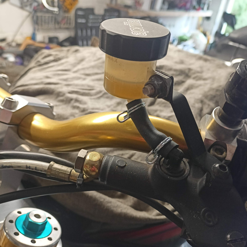

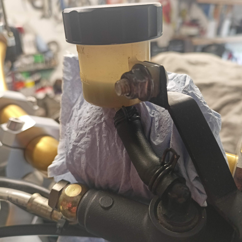

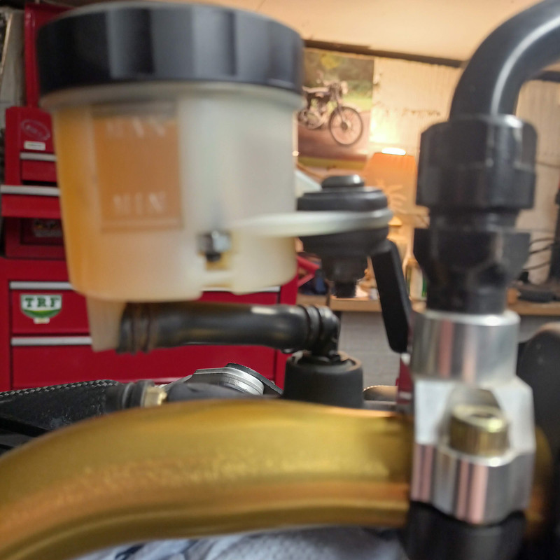

I next turned my attention to the brake and clutch fluid reservoir hoses and clips to replace these manky old ones
For the first pass I just used silver-coloured cadmium-plated clips that I’ve got a stack of, but they just looked a bit too shiney and glarey for my liking, so I bit the bullet and bought genuine Brembo black ones (at a cost of £2.25 per clip! ), which look much better IMO- tiny details perhaps , but they matter to me.

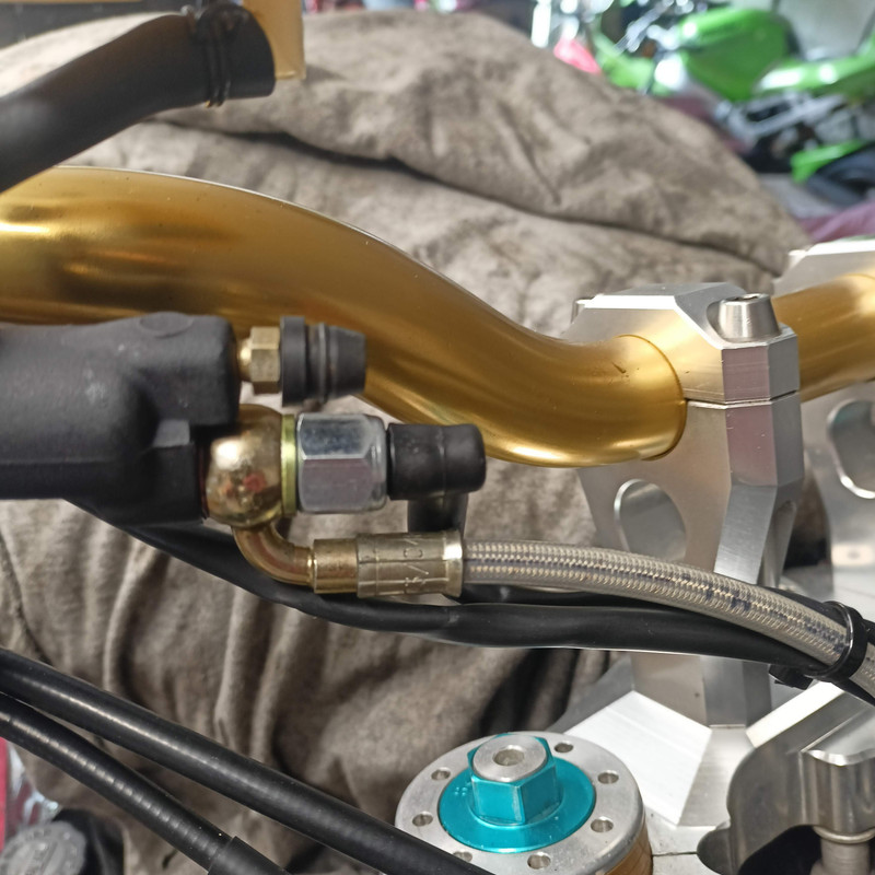

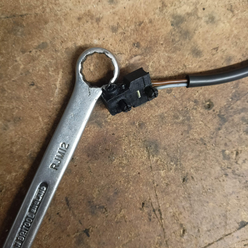

The front brake switch itself was fecked as the little plastic pin that makes contact with the lever had stuck and was broken, and although I tried, is unfortunately not really repairable.
On this, though I balked at the (£40-odd plus P&P :o ) cost of a genuine new one, especially when one for a Nissin/A.N. Other Japanese bike is typically only a tenner or so , hence it’s now sporting a (cheap and cheerful- shame it isn’t stainless, but maybe that will change) hydraulically operated one that I had kicking around- does the job and doesn’t look out of place IMO, so it will do, for now at least anyway.

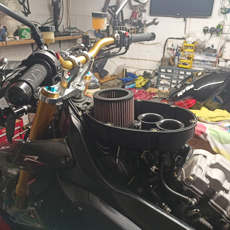

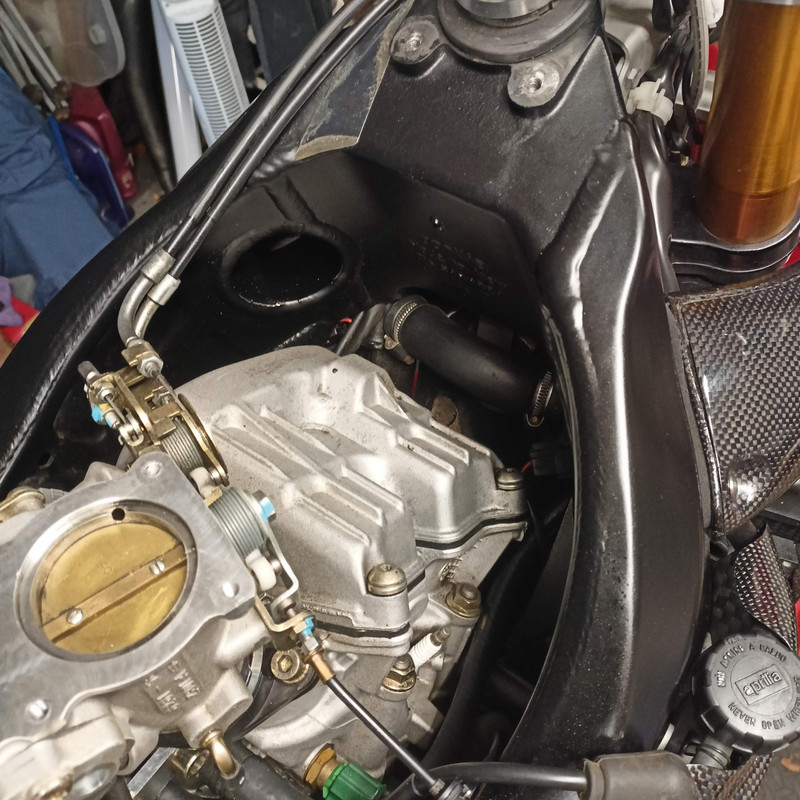

Next the tank came off to replace the fuel filter, fuel pipes, and plugs.
It’s a while since it’s been off, and it has been ridden in all weathers so was pretty nasty in places under there, so the airbox came off too and it’s had a bit of a clean.

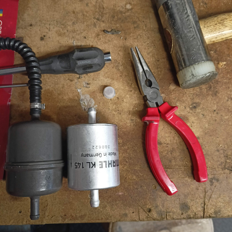

I removed the pump from the tank to inspect and replace the fuel filter and hoses - anyone who is reading this and isn't asleep yet might notice the new filter is different in appearance to the one that’s come out, which is basically just team thrifty in action again :)
The replacement is basically the one used in most BMWs and Triumphs and a fair few Ducatis too, it's a slightly different shape but same overall dimensions and just as good at filtering, and it costs £12 rather than the £43 that the Aprilia one does....
Hoses didn’t look in bad nick, but they are the originals so they got replaced too.

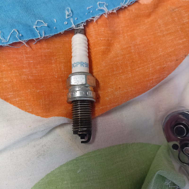

The plugs were also removed, they look fine and have a feeling they were replaced not too many miles ago, but for the cost of them I’ll put new ones in while the tank is off .
And that’s pretty much where we are at at the moment- I thought that I had a correct set of plugs ( it takes 4 total, 2 in each head) for it on the shelf but I didn’t, so the correct ones have now been ordered and once they arrive early next week the airbox and tank will go back on, I’ll replace the brake and clutch fluid and assuming we have at least one nice weather day, it’ll get a nice gentle thrashing around the A&B roads of Bucks and Oxon- it’s been far too long!

As Potter said i wouldnt change the rear gold sprocket....... they are meant to be a bit bling hence the gold bars and forks ......bit of gold at the back of the bike amongst all that black in between is a good fit IMHO

Nothing wrong with a gold rear sprocket. In my world that doesn't qualify as bling, just nicer than plain silver or zinc plate. Now if it was gold rim tape... <shudder>
