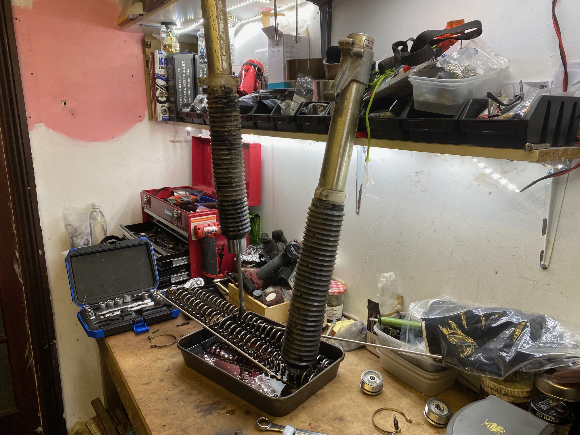

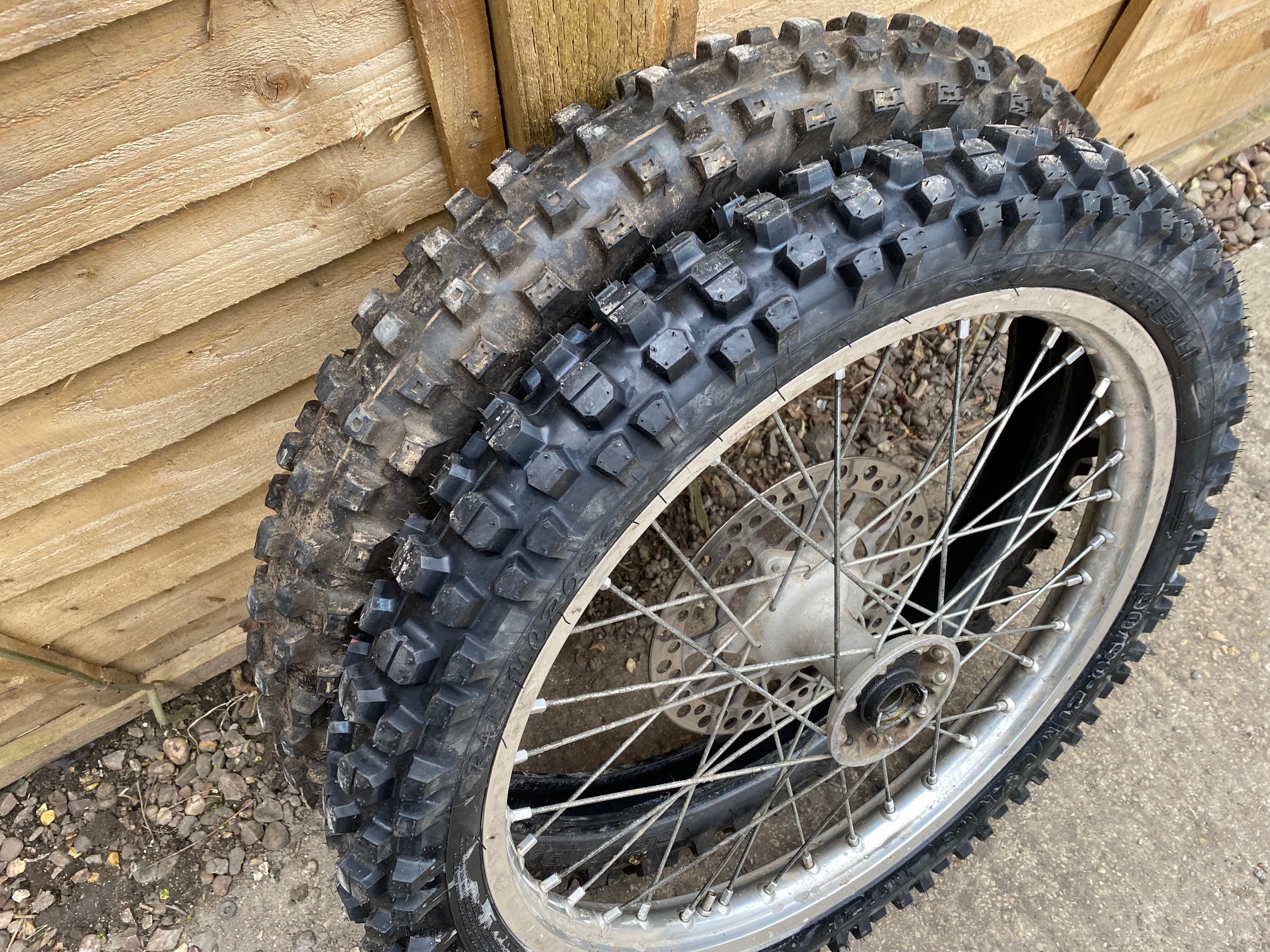

I bought this a couple of years ago I think and I've been using it for green laning locally. I took it to the ABR festival a couple of years ago and it did well although the trip there was a pain in the arse as the bike was unstable at speed on the road and just felt really sketchy. I swapped the tyres out for a Pirelli MT 21 Rally Cross - 90/90 R21 front and a Dunlop Trailmax D606 - 120/90 R18 rear which seems to be a reasonably common combination. I also changed the fork oil while I was doing it.

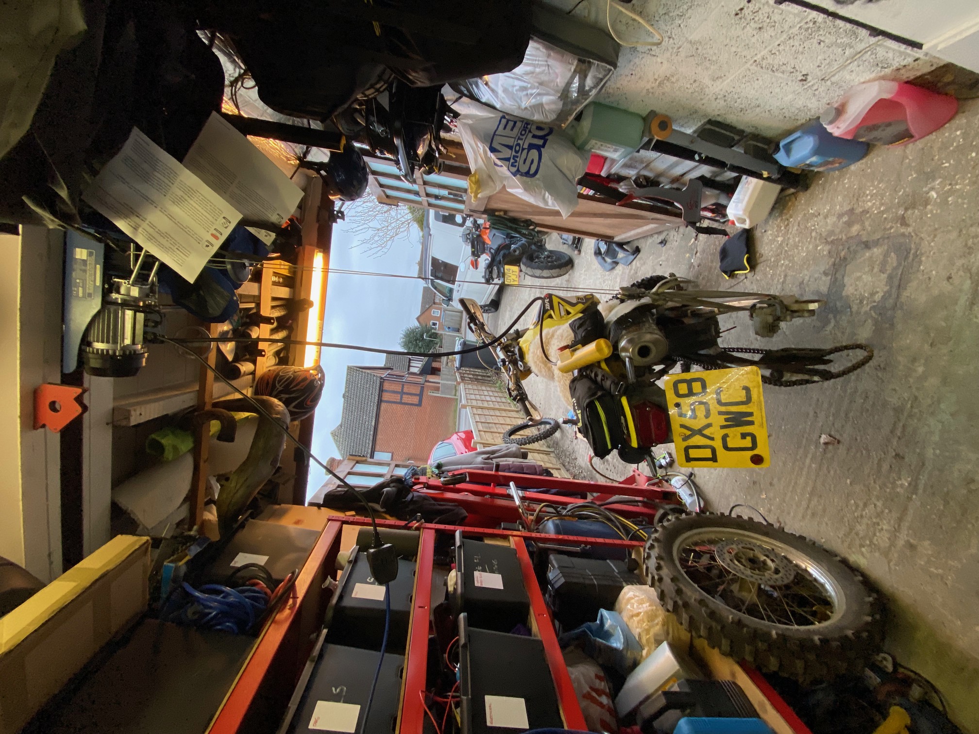

Loving the winch!

KungFooBob wrote: Sun Feb 12, 2023 6:33 pm Loving the winch!
I got that from lidl(or maybe aldi) about 20 year ago for an absolute song. I can't believe it still works but it has been so useful. Pulled engines out of cars and all sorts with it.
