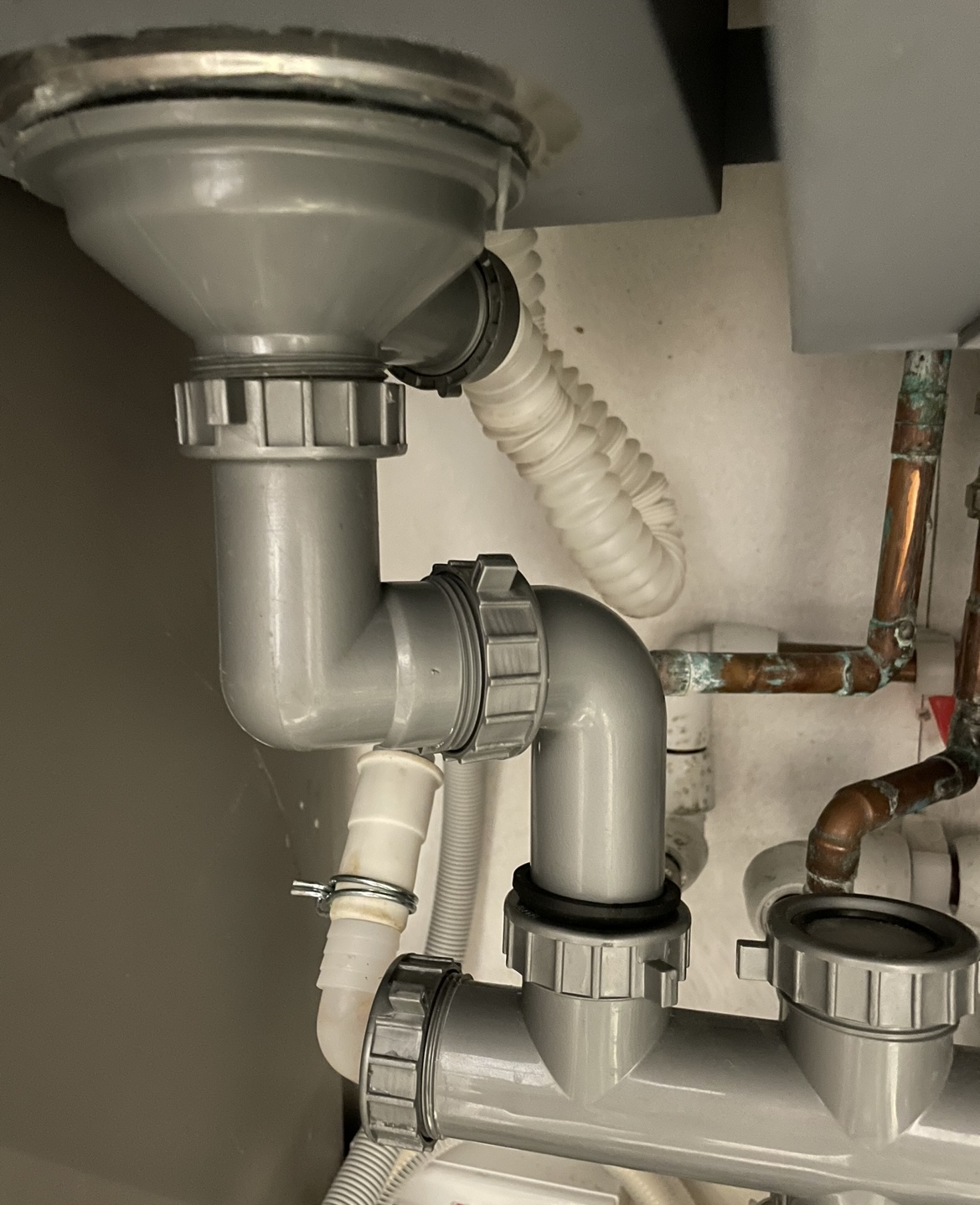

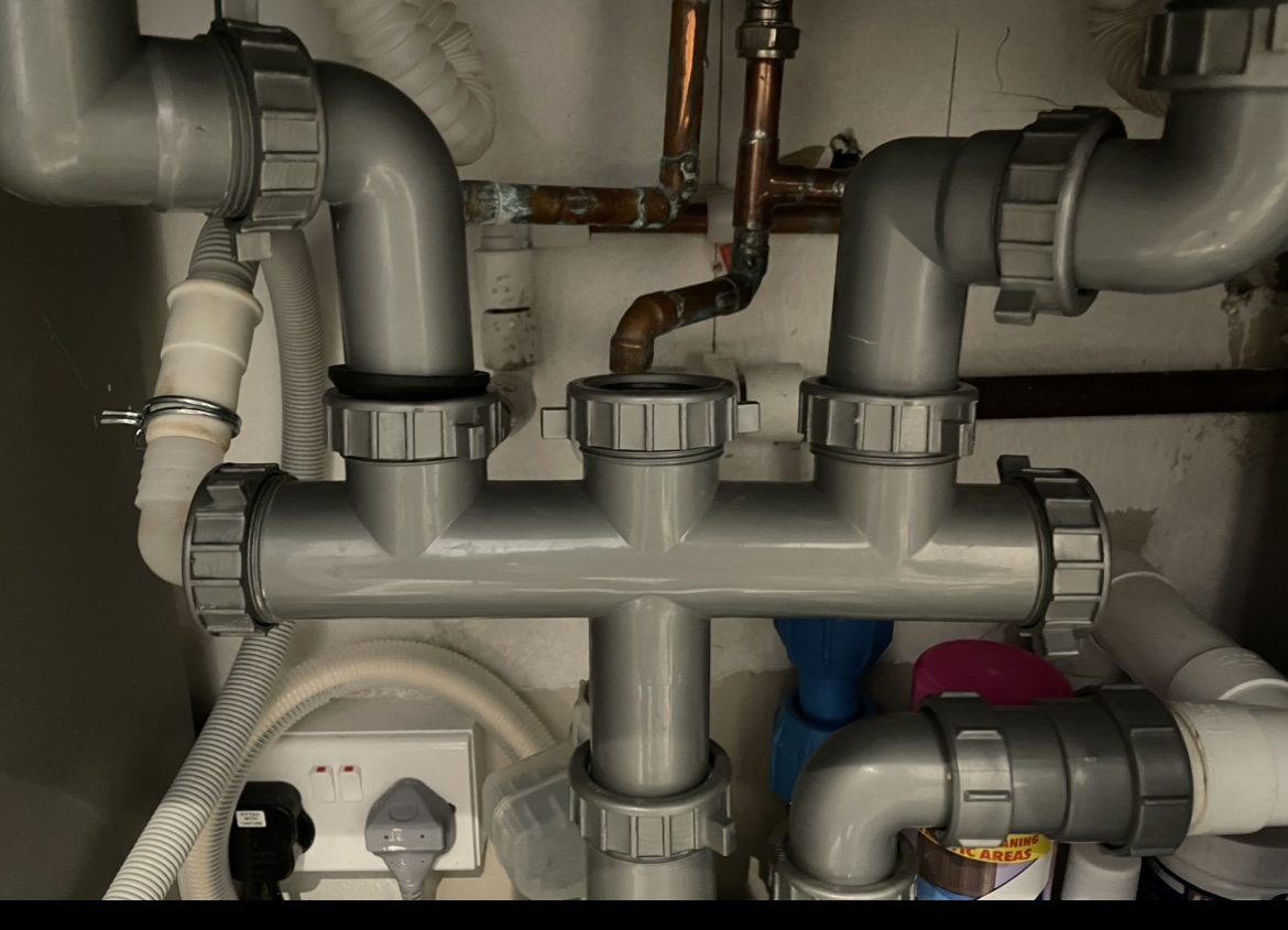

right, ever since moving in to our house, if we knock the pipe work under the sink, the smaller left hand side leaks water from the pipes.
a quick re position sorts it until next time, and TBH I can't be bothered and want to sort it,

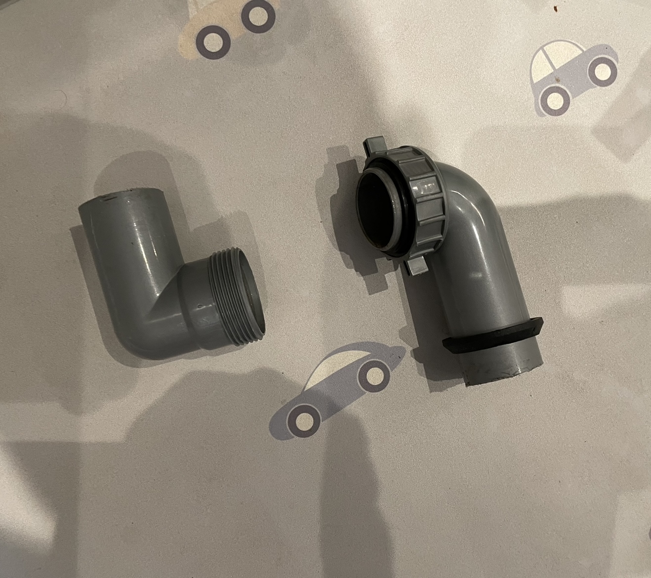

I've taken it apart and the cowboy that fitted it has cut the pipes slight too sort, so I need new pipes, ive had a quick look around and can't seem to find what I need. I can't find the brand of the pipe, any help would be greatly appreciated.

My first impression is that the rubber gasket on the LH pipe should be inside the the fitting rather than outside. The RH pipe looks right, the LH looks wrong.

the LH gasket was just put on, been to wickes and got the wrong size.
I am looking to replace the LH pipe with something

The electrical sockets are a bit close to watery stuff for my liking.

OK, but from the difference in visible thread depth between LH and RH, it would appear that the LH side is missing its gasket. This would give rise to the symptoms you are seeing. Is a gasket of the right size available, or would it not be possible to cut the wrong size gasket down to a suitable size?

I am in a new build and that's what was fitted, I took the pipe to my local plumbing place to get replacements and he said its just for the sink so did have it,
ive tried different size gaskets, the pipe needs to be another 1/2cm longer.

It looks like the length of that pipe isn't your only problem, it's at an angle (both sides are) as the horizontal part is also too short. Normally you can turn the trap slightly to compensate but they only fitted one trap for the whole system.
Fitting a trap there might be all you need but I'd buy a new elbow at the same time just in case. Plumbers merchants are usually helpful people, take the short pipe down and ask for a trap plus an elbow that size.
I don't like the power socket there, it should be somewhere you can safely switch off an appliance when there's a leak. Your RCD should prevent loss of life so not as bad as in the old days.
