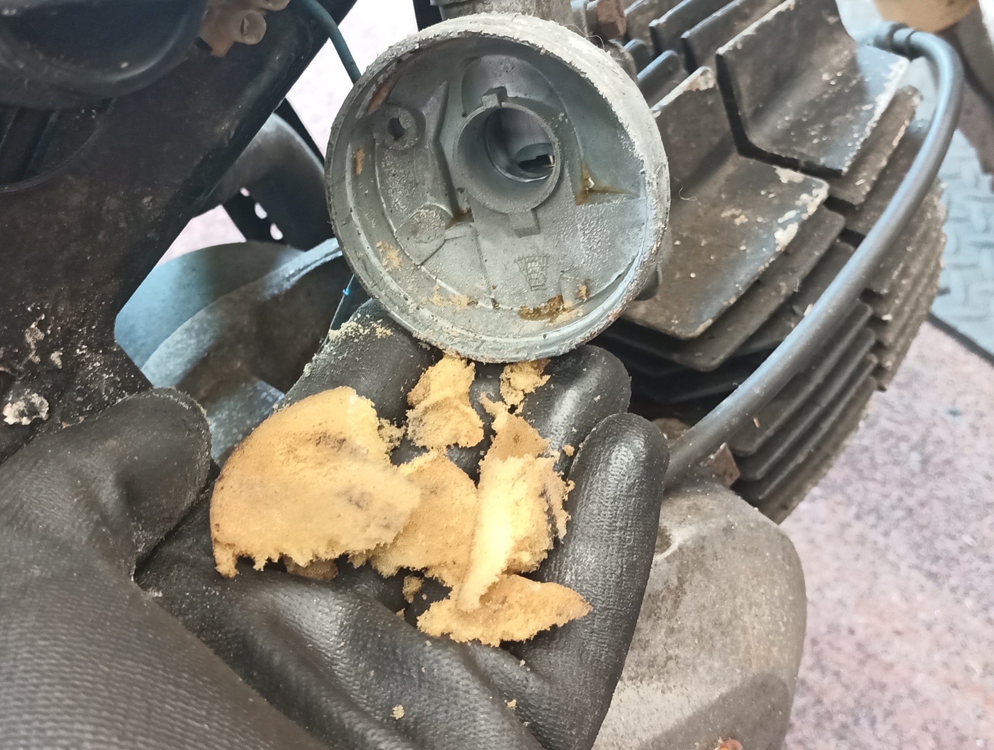

Have you tried starting it while the filter was like that?Rockburner wrote: Tue Jun 06, 2023 6:56 pm The foam air filter on the Puch wasn't very happy though!

- Rockburner
- Posts: 6033
- Has thanked: 10964 times
- Been thanked: 3995 times
Re: New Project(s)
I've been busy.....ChrisW wrote: Tue Jun 06, 2023 7:36 pm I'd been hoping you'd get on to the Puch. No offence intended!

Re: New Project(s)
Had an hour or two yesterday so tinkered with the Puch.
Definitely needing a new fuel tap....
Tank is currently full of citric acid to eat the rust and I'm going to wash some ACF50 round it afterwards to keep it from getting bad again while i sort out the carb. Should be fine, its a 2-smoke!
While tinkering i stripped the "air box" and discovered its still got the restrictor plate in. Will leave that until its fully working and then see if we want to unleash the full potential!
I also put the pressure tester on it just to see if there was any compression at all... 30psi. Not a lot, but its only a 50cc, so we'll see.... I want to at least try it with fuel in before i strip it any further.
Also ordered up some oil and ATF (for the gearbox) from Westway Oils, so, along with the carb repair kit and ultrasonic cleaner that are en-route, there is progress being made.
The JAPton is waiting for the ultrasonic as well, and I have a repair kit for the Monobloc ready and waiting, so looking forward to seeing if that makes a difference. I have also tinkered a bit with the valve gaps and i think they're better than they were!
