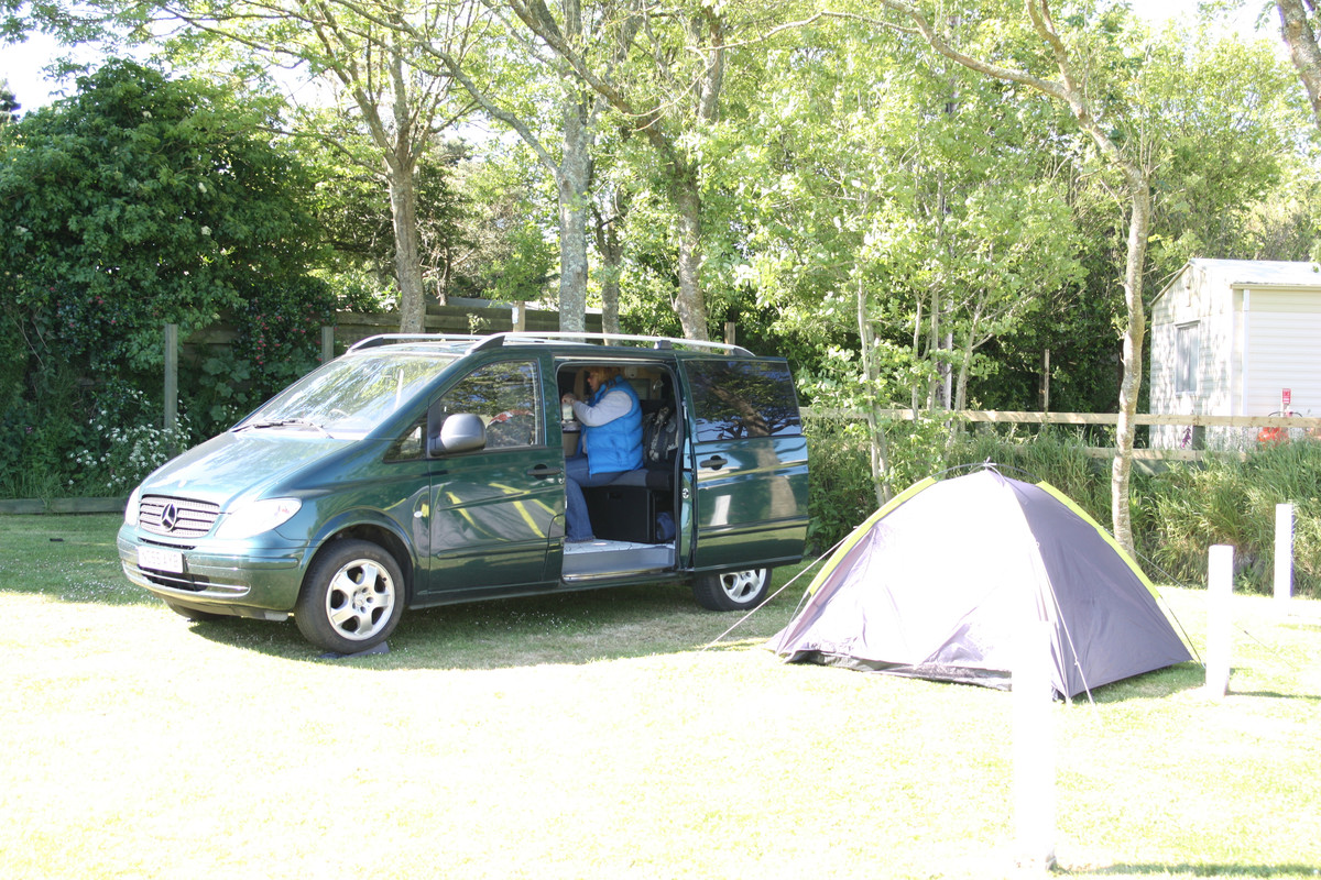

I converted a Mercedes Vito about 5 years ago, I did a build thread on TRC
https://www.therevcounter.co.uk/threads ... conversion
A Vito is about the same size as a VW Transporter, but about half the price. It was small enough to use as everyday transport and it fits down narrow country lanes and what the Scots laughingly call roads. I completed the conversion in 3 months working weekends - it was winter so too dark to work evenings, and it was all done on the drive. Any half competent handyman will have no trouble building a camper themselves. Lots of places sell flat pack furniture units, make sure they're made from lightweight ply not MDF. You can get pull tested and certified rock'n'roll beds with seat belts and children's beds that fit between the doors across the front seats. A pop top is about £1500 - £2000 and will have a larger bed in it.
The main benefit for self building is cost, I paid £3000 for the van and another £2k to convert. A similar age/mileage ready built Vito camper would have been £7-8k, and a VW Transporter £10-12k. In 4 years it did 40000 miles, took us on holidays from Cornwall to Scotland, and Wales to Germany. I sold it for £5k
Used vans are frequently high mileage and may not have been particularly well looked after. Bodywork, steering, suspension and transmission may have had a hard life.
DVLA have made it much more difficult to re classify as a campervan. This affects the vehicle's speed limit, but not the tax class or insurance.
Fit a heater, nights can get cold in spring and autumn.
Fit a roof vent, it can get really hot and stuffy overnight in the summer
SBMCC is a good website, there are quite a few self build camper groups on Facebook and hundreds of YouTube channels
