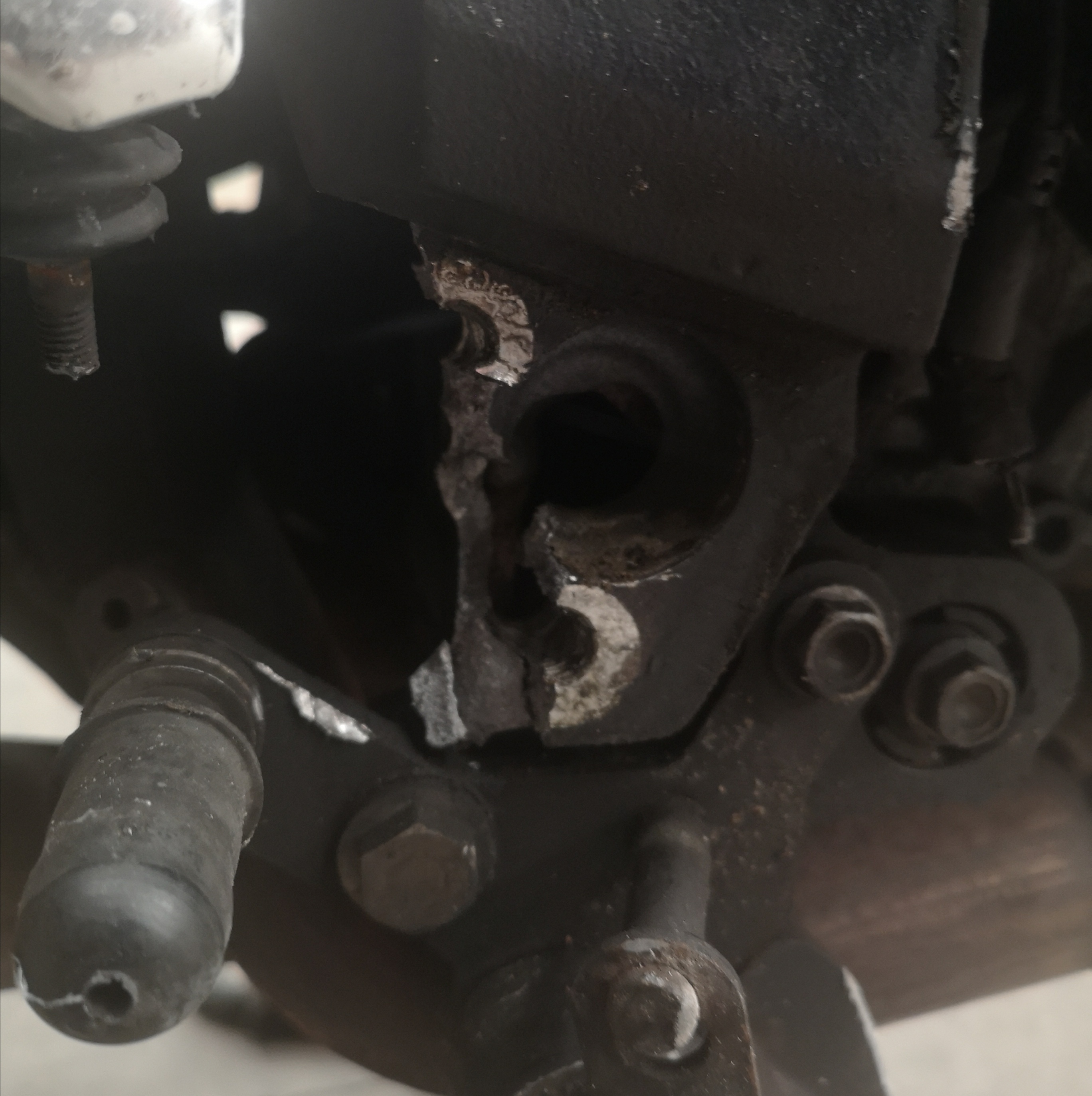

Collected the bike last week and the RHS foot peg has snapped off taking a chunk of the frame with it. There is a secondhand frame on eBay so I’m wondering if it’s possible to do a switch and then get the bike back on the road but beyond the frame transplant I don’t know what else I’d need to do. I assume DVLA have the bike listed as stolen? What are the legalities of swapping a frame and who would I need to notify?
Appreciate that breaking the good parts is an option but I’d rather keep get the bike back on the road if possible. Apart from the frame snap, the other damage is brake lever, indicator and scuffs to the crash bars - headlight, front wheel and fork all look sound and the bike rolls smoothly.

Is it feasible to get the frame welded?

No idea if it can be welded, it's a cast ally frame apparently if that makes a difference. These things are well outside of my comfort zone. The frame is missing a piece where the foot peg bolts on to it, snapped at the threads. Hopefully this photo gives a better idea than my description.

Anything can be welded, but with something like that its best to cut a whole section out of another frame and weld it in. You wouldn't weld the missing bit back onto that, iyswim?

Bit of JB weld would fix that.
Let it set, drill and tap... sorted :)

Ideally you want one sold with a UK V5C that shows the reg number, it would be a whole lot less painful, because you could just link your old engine to the new frame officially on the V5C, build the bike back up, and be done with it. For frames without a V5C then potentially you have to go down the route of MSVA, and again possibly made worse if technically the frame is considered an 'import'.
Re: Stolen crashed bike, broken frame - next steps?
That frame is easily weldable, it's non structural, it won't look especially pretty when done, but you will have a usable frame and not have to faff about with V5s (which isn't as easy as it used to be)

Have you checked the engine is running? What other damage have they done?
I would make sure I had a running bike & price up what else needs fixing before going to the trouble of getting the frame damage sorted.
If you decide that it's worth getting the frame sorted I would look at getting it repaired,swapping frames & involving the DVLA would be a last resort.

Not really sure what to advise - I've never been in that particular situation. Physically changing the frame might not be that hard*, but the legal side of it would give me the screaming heebie jeebies.
* although you are opening yourself up to endless trouble-shooting afterwards because of all the little bits that don't like being disturbed getting moved around.

- I agree with the previous recs- check the motor etc is still good, and then get the current frame repaired
