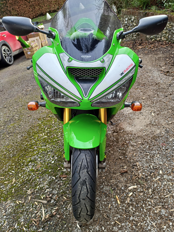

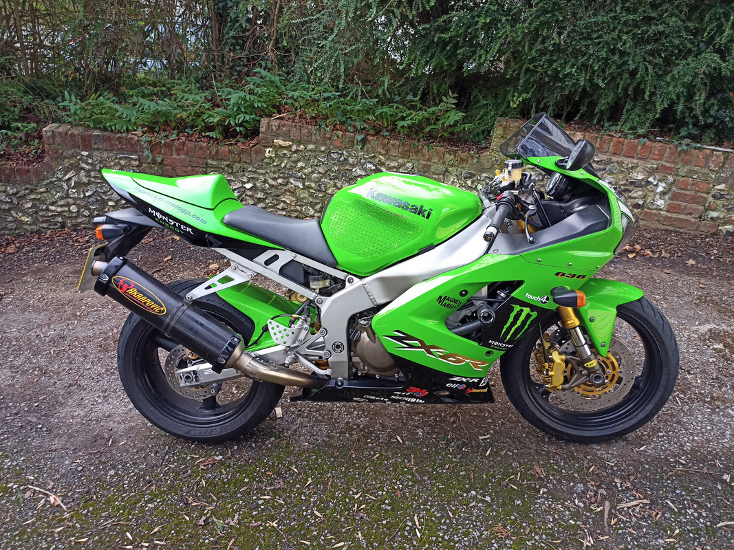

Well, in paint colour that is :D

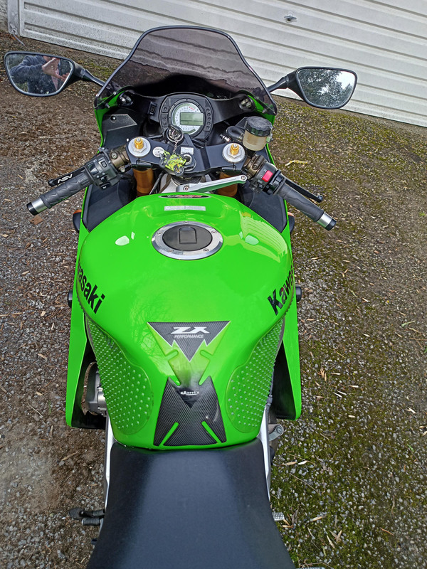

Since the H2 went, I haven’t had a Ninja in my life, apart from the food processor, and I've missed it!
Seriously though, I’ve been getting itchy since Christmas as I haven’t bought a bike for a few months, and booking a 3 dayer at Cartagena a couple of weeks back got me thinking, especially as my young (relative term ;) ), but most importantly, fast, R6-riding mate is going and although of course as we all know, it’s only a trackday, and speed isn’t important etc etc etc, I had to ride the 765 harder than I’ve ridden any bike for a very long time to stick with him at Lydden last year, he's been to Cartagena twice before (I'm a virgin) and I just know I’ll be tempted to do the same on the 890, so I decided to get a more track focussed, and cheaper bike, just in case, like, and leave the 890 at home
And this is what I bought- I ummed and arred over a few things (another ZX10, GSXR1000 and also that V4 Tuono someone linked to in MoFo’s new bike thread were all in the running), but stumbled on this little beauty at what I think was bargain money.
She’s an oldie (2003) and has a few miles up but has been cared for. The fairings are original genuine Kawasaki, but will a pro lacquered over sticker job, which I actually think looks quite cool, they’ll be coming off and replaced with trackday fairings (which I already have) as initial shakedowns aside, I don’t anticipate using it on the road, and they are too nice condition to risk wrecking
It’s had some money thrown at the suspension with KTec cartridges and springs in the front and an Ohlins rear, an Akra full system and PC , custom mapped, and a few other nice bits and pieces too, along with the standard system, etc etc.
These were cracking bikes when they came out, absolute screamers but with relatively good mid-range for a 600, they’re the lightest ZX6, and with decent and well set up suspension I think it should make a great track bike.

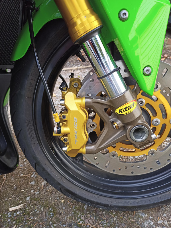

The front callipers have been professionally refurbed a year ago, and brand new front disks and lines were fitted at the same time, and it’s just sat in a garage since- I have receipts for all the work over the years and the previous owner (he has it for the last 9 years) has kept a nice record of every oil change with dates, and what brand oil and filter etc.
I’m away this weekend so not going to get a chance to do anything with it, but before I rip the road fairing and lights off and replace it with track bodywork, I’ll tax and insure it and run it around the roads over the next couple of weeks to check all’s well.
Alongside that, current plans to sort ( aside from a good going through with the spanners along with replacement fluids and filters etc) before it gets shipped off to Cartagena in 4 weeks time are:
  • Replace current Diablo Rosso III tyres- I want and will need some really decent grip, not sure I can be arsed with the whole stands and tyre warmer palaver anymore so it will likely get either Sport smart TTs, or maybe just S22s
  • Replace standard Kawa master cylinder with a Brembo RCS or decent radial Nissin etc of a current sports bike- the standard one on these is the same as the early ZX10s and is crap, a decent one transforms it
  • Rearsets. Although the position of the standard rests is fine, I am really not a fan of folding pegs on the track, so I’ll treat it to a set I think
  • New wheel bearings- they all seem smooth and fine, but she’s no spring chicken, new bearings are cheap and it’s easy to do.
  • And a Quickshifter!! - an absolute must for heightened pleasure on something like this ( despite what one or two old has-beens on here think :lol:)
I’ll also run it down to Gav @ MSG racing and get it up on the dyno to set the QS up and see what sort of power we have etc if I can too
That’s it for the moment, more to follow over the coming weeks! 8-)

Oh! Well found sir. That looks brilliant for that age of bike. Where did you discover that little gem?

She's a clean one mister. With all the proper toys too.
Health to enjoy,sir. :obscene-drinkingcheers:

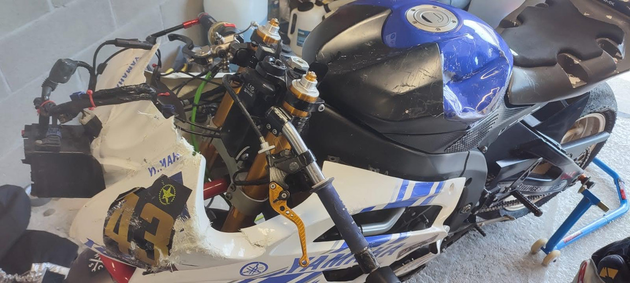

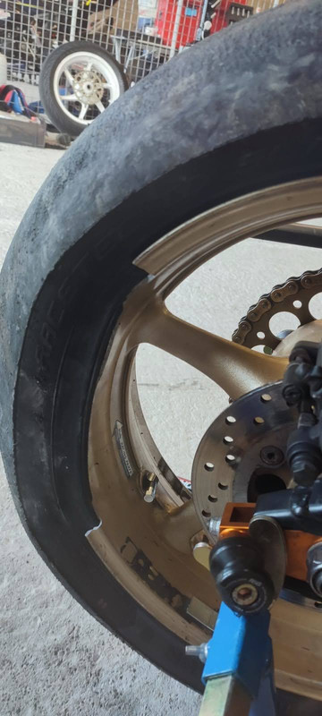

A little bit of an update- I still haven’t ridden the 636 t yet, but I’ll be off on it’s way to Cartagena in two weeks' time so I need to up the ante this week, particularly as Tim, my young( compared to me) R6 riding fast mate may end up needing it- he did a Crescent Yamaha 3 dayer (well, it turned in to just under 2 dayer for him :shifty: ) at Alcarras a couple of weeks back, hired James Hillier for a day who helped him get a shit load faster until…
He found the limit :o
It was a fair speed off and unfortunately, it flipped when it hit the gravel trap, but no damage to him ( apart from his wallet), so it could have been a lot worse and was for this Panigale owner in his garage.....
The R6 is back and stripped, as a fair bit of damage but most new bits seem to have arrived this week so tomorrow I’ll be helping him nail it all back together – this is it’s the current condition

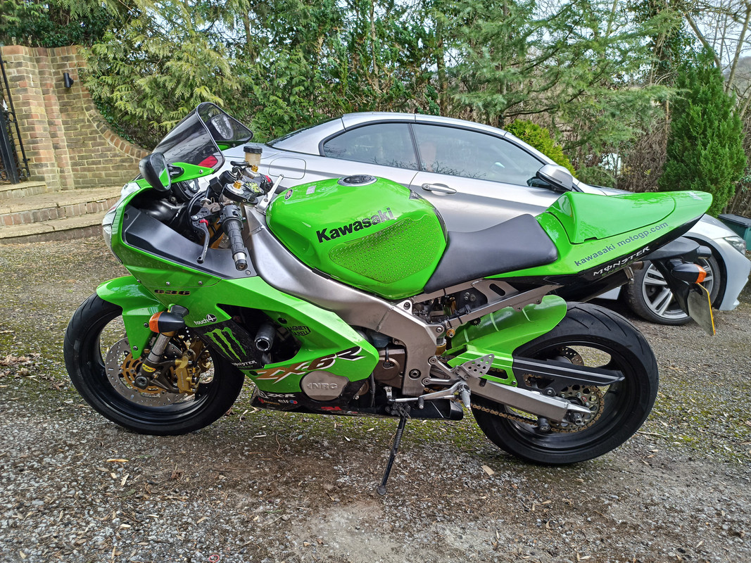

it has had some attention in the garage over the last week or so, and I of course started with the most crucial part of any track bike first- adding a quick-shifter 8-) ;)

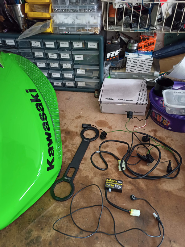

@2xtwins made me an offer I couldn’t refuse for the Healtech that was removed from his Z1000 (after it fecked the gearbox :lol: ), so I set about fitting it.
Is very straightforward in terms of installation, just going in-line between the standard Kawasaki loom and coil packs, with the same sort of sensor that I have on my 390s going into the shift rod.
It was missing the conical spring washers so installation is not yet fully complete as it just needs the sensor installing, but I’ve ordered some up and it’ll be a 5 min job to finish it off as soon as it arrives.

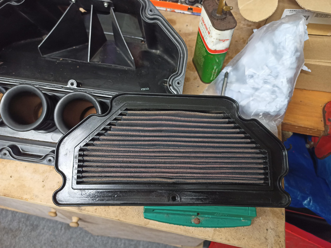

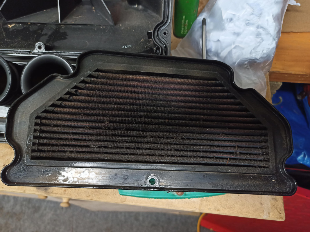

As of course the airbox has to come off to get to the coil packs, I had the plugs out for a look ( which all looked fine so went back in) and pulled the air filter whilst I was there- was pretty cruddy, but it’s a K& N so a few taps and a blow-through with the airline and was good as new.
Before
And after

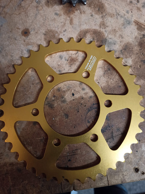

Next on the list were sprockets. Chain and sprockets are good quality and in excellent nick, but it’s on standard gearing, and never going to get close to pulling that on most circuits, so I thought that 1T down on the front is a good starting point, and I treated it to a nice lightweight Talon gold rear whilst I was at it, as I’m a tart, and of course took the opportunity to give the inside of the swingarm, hugger and shock linkage a good clean whilst it was all out, admittedly not that it needed much.

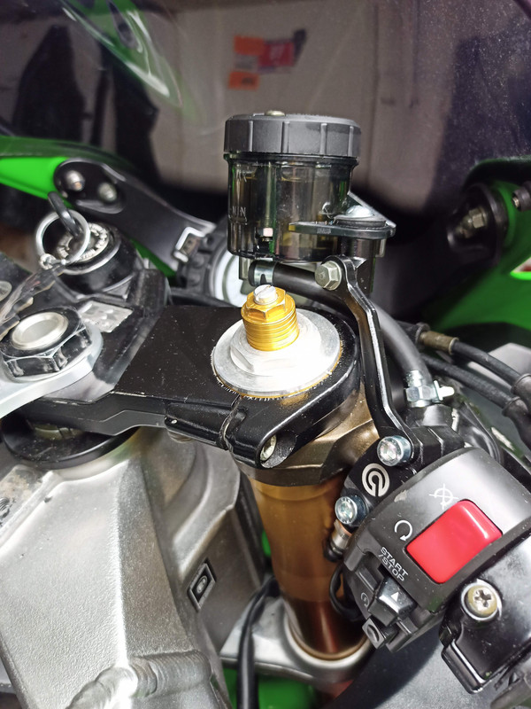

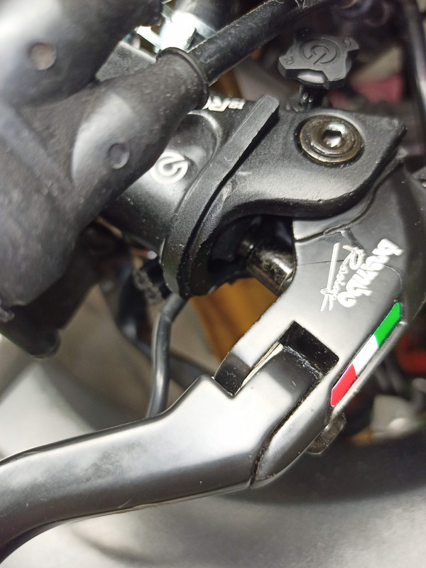

Next, I moved on to the front brake. Whilst it’s very recently had new discs, pads, and professionally refurbed calipers, it’s still on the original MC and the action at the lever is spongy. Standard is 16mm, but with 4 x 32mm pistons, a 3/4” (19mm) is more applicable, and a 19mm Brembo RCS made a massive difference on my trusty old ZX10 so that’s what I went looking for.

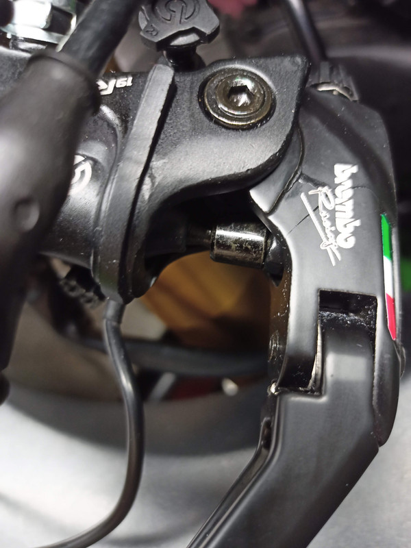

Along the way I found this- for the massive sum of £42 delivered all the way from China, including reservoir and folding lever.
https://www.ebay.co.uk/itm/165183654085
I’ve heard a lot about how shit the copies are, and I was never contemplating having it on a track bike, but for £42 I thought I’d order one just to see if they are really as bad as I was expecting
First impressions were not bad, although I was shocked just how blatant they are with the branding :shock:
I put it onto the ZX and quickly bled it up with no problems just to see, and immediately had a big improvement in feel at the lever- nice and firm .
Looking a bit closer though, the engineering is, frankly shocking.
The pushrod mechanism is very basic with no ability to swivel and as a result when you pull the brake on, although at first it’s bearing down nice and straight on the piston, as the lever comes further back it’s pushing at an angle- not sure how well these pics illustrate what I mean, but suffice to say, it's something that’s not going to wear well or and definitely not something I’d like to have to rely on at the end of a straight on a track

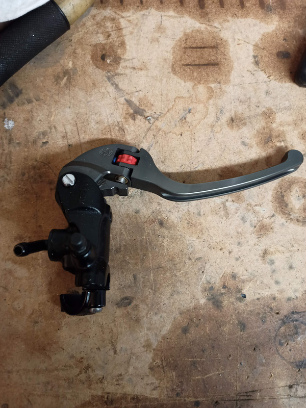

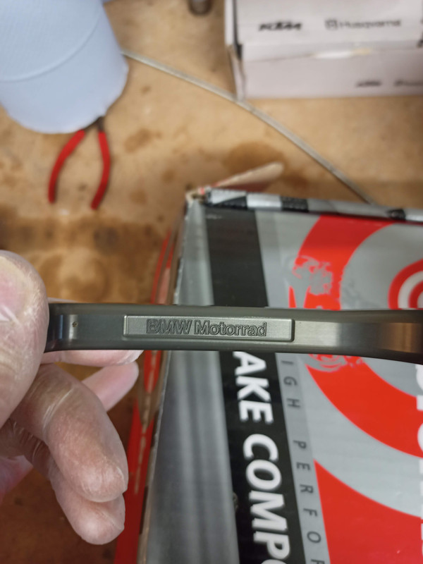

So it’s come straight off, to be consigned to the bin, and is being replaced by this one, a nice 19mm Nissin off a brand new current model Bimmer S1000RR
With a lovely blingy folding lever as standard
The hose connection thread is a 1.0mm pitch rather than 1.25 on the OEM Kawasaki and Blembo, and I didn’t have a 1.0 double banjo, so that’s another job that’s not completed yet, but I’ll pick one up this weekend and the job’s a good un.

Just wondering why someone would have a brake assembly from a brand new S1000RR available? If they've bought a new bike and swapped it out, what have they replaced it with (and why)? It looks like it has never been used and it's not exactly a cheap and nasty piece of kit.
Other possibility, binned it already and breaking for parts? :shock:
