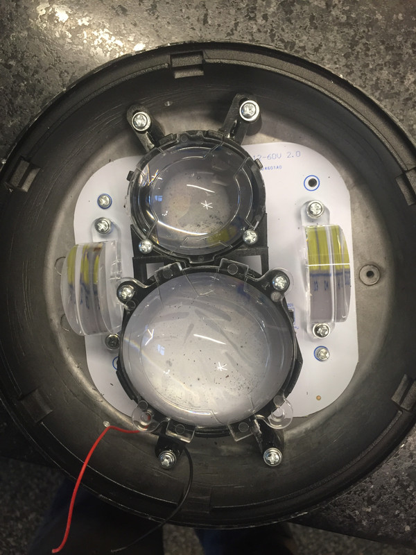

Went round the join between the body and the clear front with a knife and prised them apart.
The LEDs that come on for full beam are behind the round lenses. Everything is just screwed on. Tried angling the lenses up, individually and together, but that sent the beam shape haywire.
Next experiment was to slide the lenses upward. That appeared to do the trick.
So I slotted the screw holes, to hold the lenses up, about half a hole. The two half-moon lenses are the dipped light.
Posts: 4442
Been thanked: 1228 times
Re: LED headlights again.
Now the full beam lenses didn’t line up with the holes in the black plastic mask/pilot light holder, so I attacked it with nippers.
Also found this masking segment and sawed it off.
It’s back on the bike now, stuck together with silicone. Looks much better. If the weather calms down, I’ll try it out after dark.
