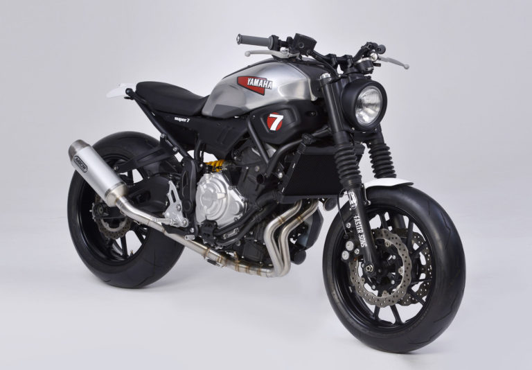

I'm also a fan of the Faster Sons XSR700 and there was a touch of similarity which I decided I might try and emulate.
So armed with ideas I joined a few T300 facebook groups and started reading up and looking at other peoples mods and asking a few questions, keeping my eyes peeled for spares and tips.
