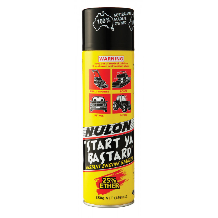

Some work today, when it came home it wouldn’t start and run. A few attempts but nothing. One of the lads in the yard wonders over with a can of deodorant and sprays it in the air intake and it fires and runs lovely while the can is sprayed lol. Not worried so I dump it inside.
Had an hour today to have a look, someone had joked it was prob the fuel pump and someone else said they don’t have one. But soon as the tank was off there it was and it wasn’t running. A quick check and no volts at the terminals. A couple minutes bypassing the relay and the pump works. Back on with tank and it starts first time and runs smoothly. I do like the whine very NC30 like. Happy with that I stripped all the road gear off lights indicators etc. Also removed speedo and modified clock bracket. I’ll refit tank tomorrow and take for a base dyno run at some point. Big box of stuff arrived so plenty to be getting on with now.
