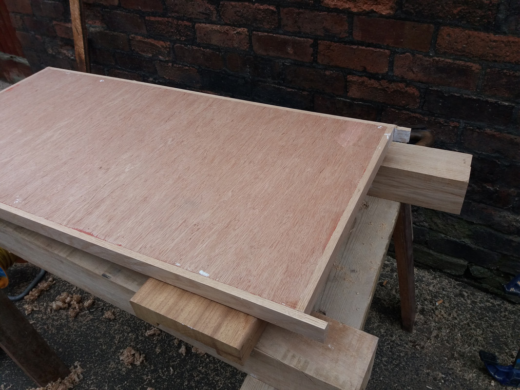

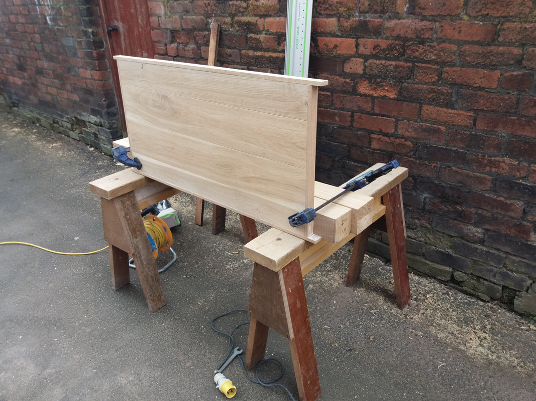

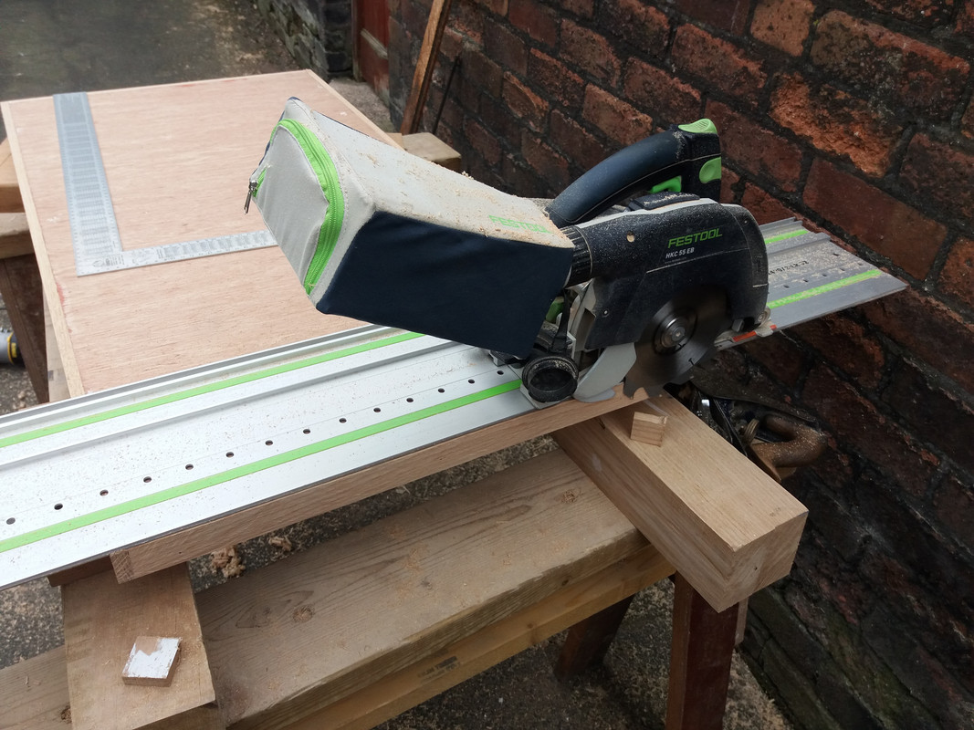

After planing it I cut it to size from the underside with a circular saw to stop it from spelching through to top surface, to be fair its a guiderail saw and the cuts are very clean but no harm in doing good practice to make it as good as possible.
Then I've glued some slightly over width oak lipping on the ends, let it go off, routed the end lipping to the same size as the tabletop, cut the lipping ends and a little bit off the width down to size.
Lipped the sides the same way, its longer that it needs to be as well as extra width (the ply and boards add upto 32mm and I'm leaving the lipping at 35 mm til its glued on. Can rout it with a flushcut bearing guided cutter.
You can see where I've pinned the lipping on with three pins on each section, I used a brad nailgun shooting through a bit of wood with a slot cut in it, that leaves the pins sticking out of the lipping so I can pull it out with a pair of pincers when the glue goes off.
Here it is clamped up.

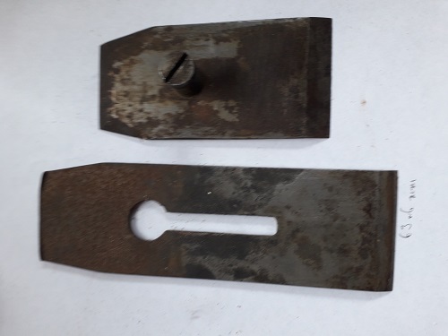

As a side note, I've been using one of those Mujingfang High Speed Steel tipped plane blades in my No3 handplane, I had to attack it with a grinder to get it to fit the lateral adjustment mechanism as its designed for wooden planes not Record No 3s.
It's ugly as feck, HSS brazed onto mild steel but the HSS holds a hell of an edge, way better than standard blades and it cost about the same.
People chuntering on about O1 toolsteel really need to give it a try, I sharpen it on a diamond hone and strop it on a bit of green compound charged MDF. Dead easy.

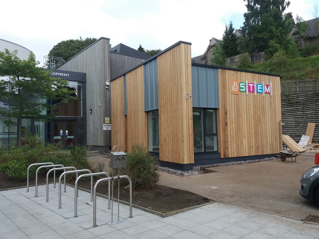

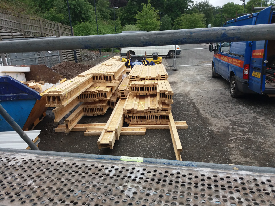

I hardly ever get to do it, its more often I'm just working on sites building stuff like this, a recent eco room extension I did to a college over the border.
With the frames made from that heap of wood, the company I was working for seemed to think it all came in large panels as I'm damn nearly positive they underpriced it. No crane on site and it all needed sealed up to passivehaus levels.
Oh and the college had a bloke filming me for almost all of the build, must have a fair bit of footage of me scratching my head and swearing.

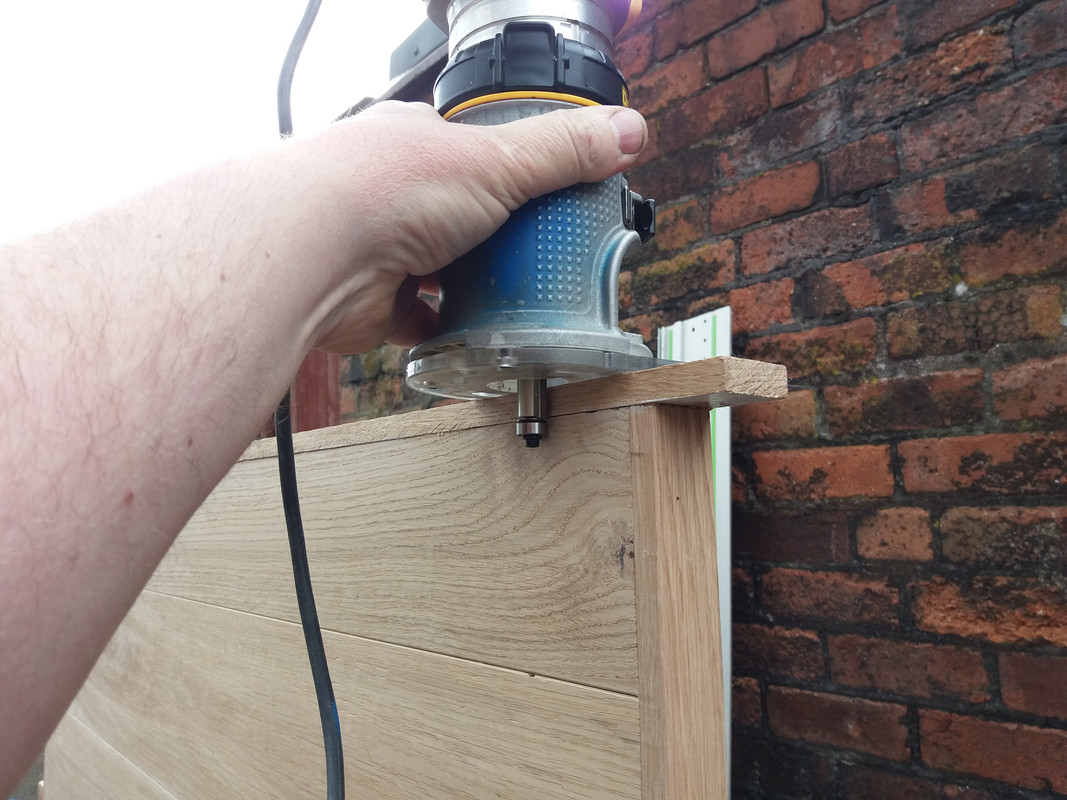

So, after leaving the glue on the oak lipping to go off I ratched out a better flushcut router bit cos the one I was using the other day wasn't so clever.
Clamped the tabletop up so the router was simpler to use.
Fitted the router base and routed the lipping flush, its one of the rare occasions where I do a climb cut cos sometimes the oak splits knackers the lipping otherwise.
Not exactly me doing it but I only have so many hands.

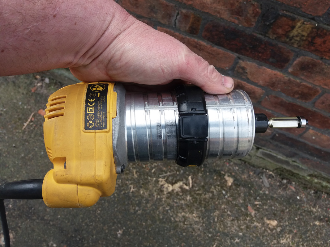

Looks like we have the same router, although mine probably has a different designation for Turkish sales. Mine is a D26200. This afternoon I'll start cutting pieces to make a small table for it and make it a bit more useful.
I also have a smaller Makita RT0700C which is a bit more powerful than a laminate trimmer but is ideal for hand held use on thin plywood which I do a fair bit of.
Well, maybe just a bit, hidden in the toolsafe but I just don't like the finish it gives.
Yeah, same router. I also have the plunge base for it which make it more usable when using a hinge jig to do lots of hinges if I'm on a big site.
Its a really nice size for me, great for rounding off inch MDF when I'm making window sills.

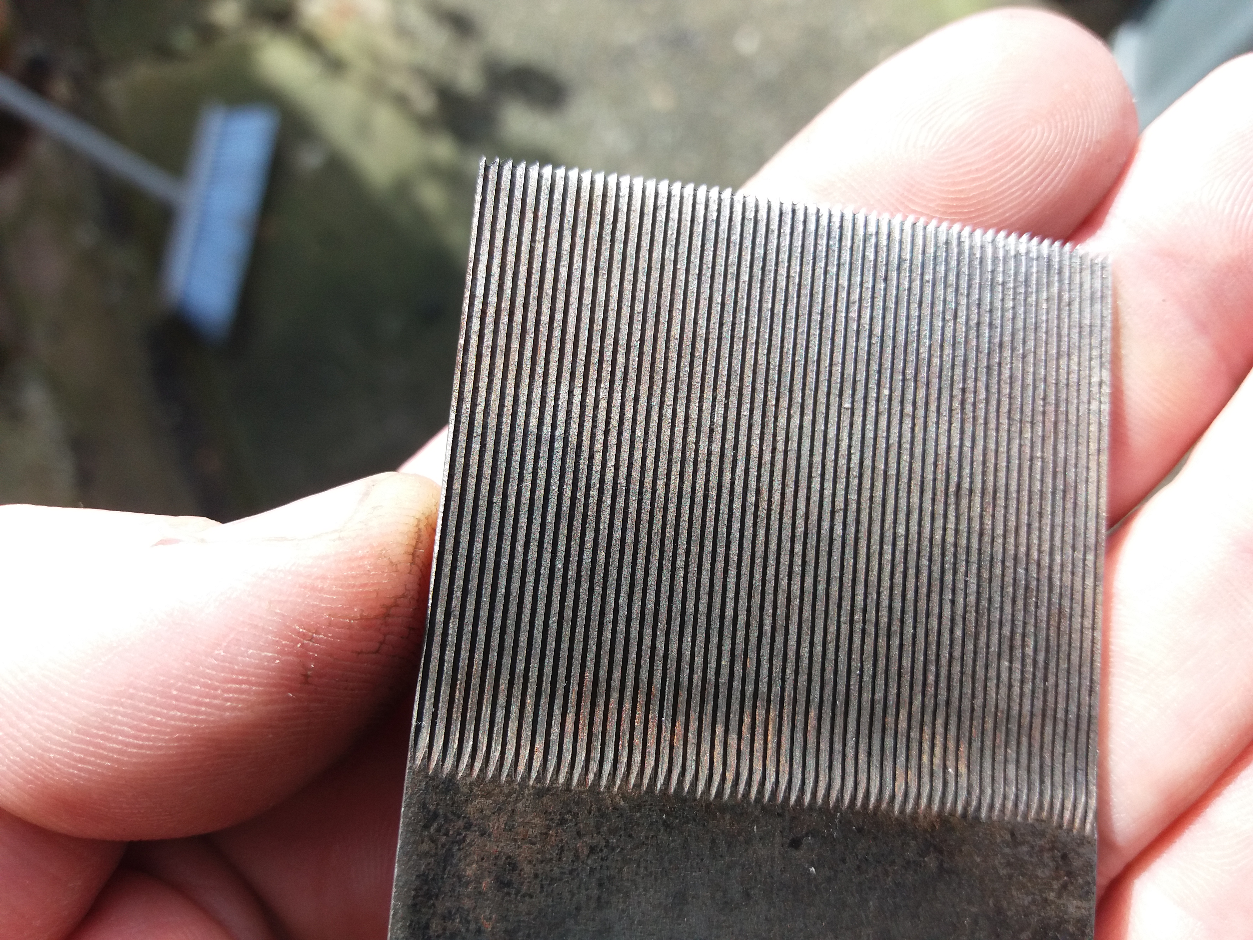

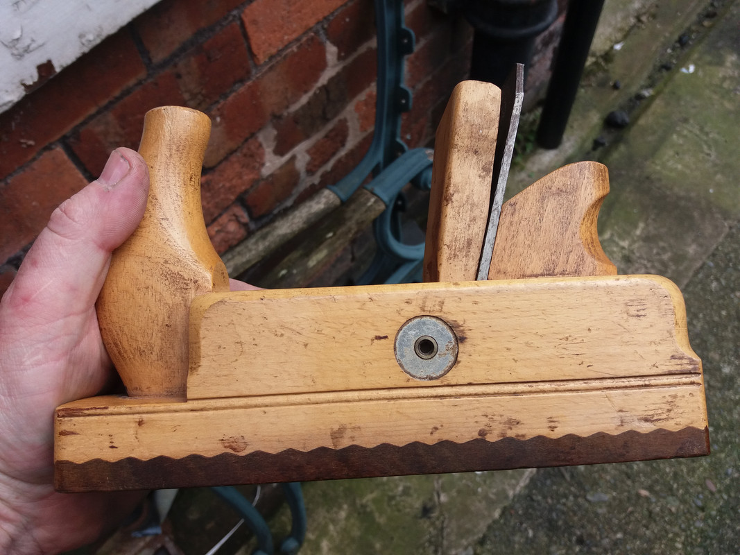

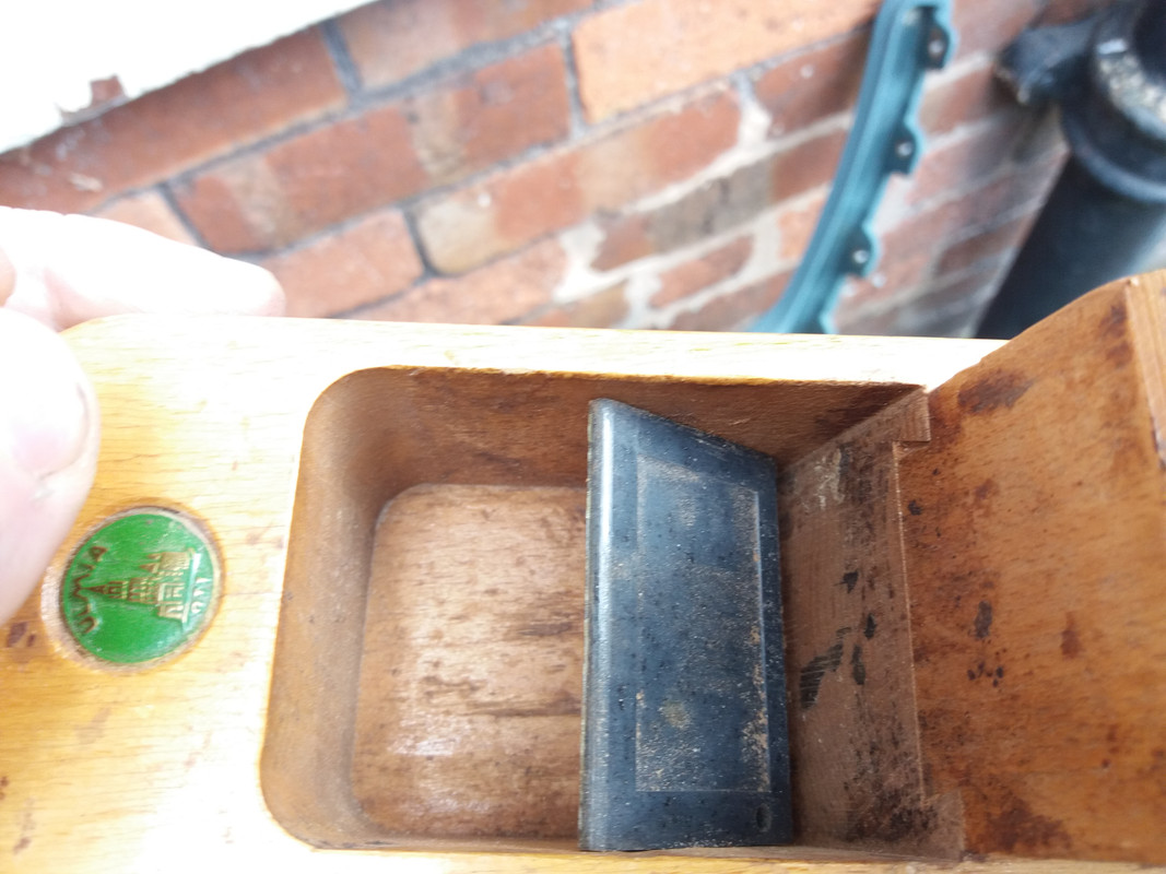

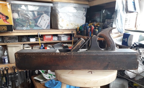

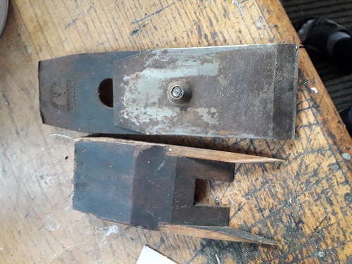

Ulmia toothing plane.
It's kind of one of those tools I just wanted to have a bash with so I bought one off Ebay for 20 something quid. Seems I landed on my feet cos it's a right posh one with a Lignum Vitae sole and a laminated blade so the steel on the cutting edge is harder than on the bevel side.

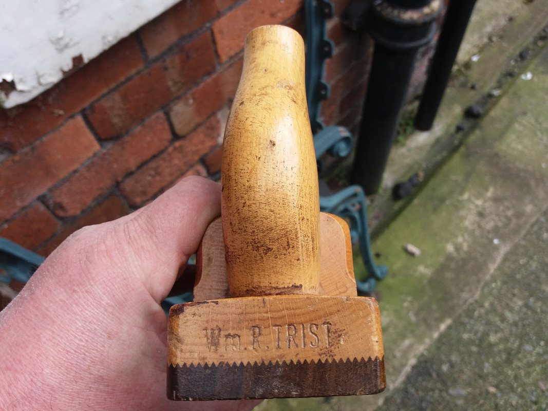

The sole has had a weird sort of finger joint going on, looks like its been done on an angle by the larger waves seen from the side.
I'm not called Wm R Trist by the way but whoever he was he looked after his gear so who am I to scrub his name out.

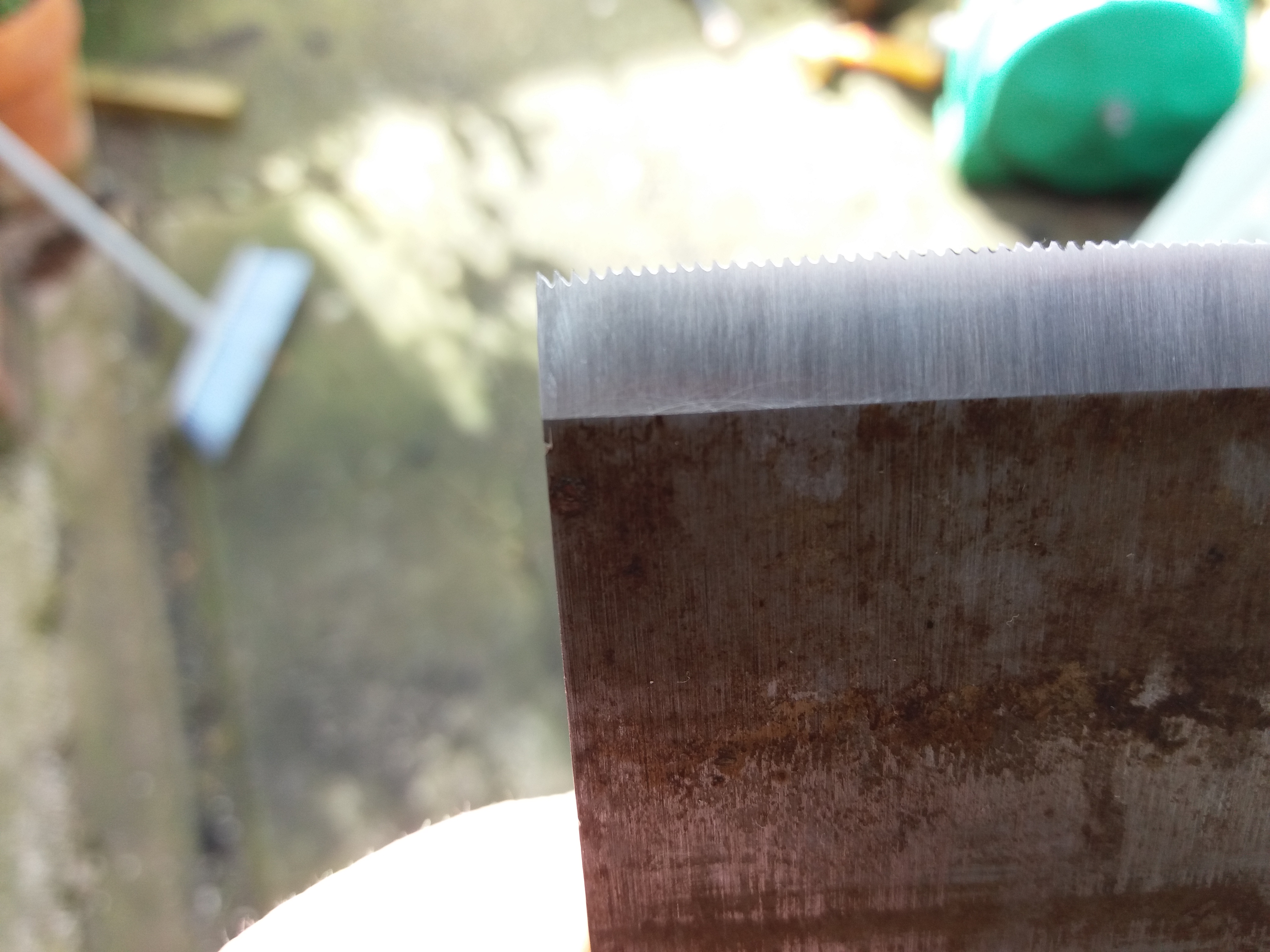

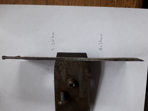

Then there's the blade, which has shallow grooves in it so it cuts tiny grooves, this can sometimes be useful for either increasing surface area for glue up, ensuring theres a slight clearance for some glues or in my case they allow me to plane in virtually any direction and not get tearout, then afterwards scrape it to flat.
Now it's not very visible but if I squint just right I can see the line (maybe 3mm back from the cutting edge) where the harder edge metal has been forge welded to the softer backing metal, its easy to see in real life but a bugger to take a photo of.
This means it holds a good edge but the softer backing on the bevel side allows the user to sharpen it faster.

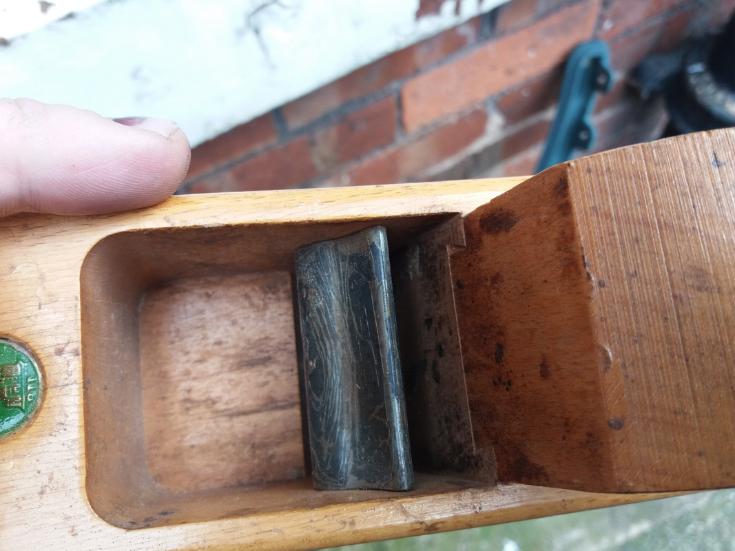

Then there's the way the wedge is retained, there's a pin going through the body of the plane with a spinny plastic thingy (it's a technical term, honest) that means the wedge doesn't have to be an absolutely perfect fit into the more common wedge mortice like old British wooden handplanes have.
Its a good system, not fussy.
The plastic bit looks like its all pattern welded steel but its not it's some kind of hard engineering plastic.
Shown here with the wedge retainer spun round slightly.
Just a well thought out way of reducing the amount of time it takes to make them whilst still working as well as the traditional wooden plane wedge/blade mortise.
Oh and wooden planes? Surprisingly nice to use. I expected them to be harder to setup.
There's a learning curve but I'm just dicking about in my spare time here, its not work.
As long as I'm willing to just wait to pick em up cheap I can get some decent kit without breaking the bank.

I'd like to see that old wooden jointer if you fancy firing a picture up?
- GuzziPaul
- Posts: 418
- Location: Chelmsford
- Has thanked: 59 times
- Been thanked: 195 times
Re: Oak tabletop for my granddaughter.
Been out to the garage and pulled the plane out from behind my DT175. Can't read the name on the blade at the moment. But the plane 22 inches long. It needs a good clean up so that will be a nice little project, not that i have a use for it at the moment. The top of the blade is a bit turned over where its been hammered in so that needs filing off and I'll give it a sharpen with my new MDF wheel, then oild the blade and BLO the wood.
The photo is taken on top of a stool one of my daughters is making (with my help) from her old Uni desk (which I made).
The blade, you can just make ot the burr at the top hopefully-

That plane is almost identical to the one I bought recently, mine has a Sorby cap iron that looks the same as yours but the blade on mine (often called the Iron but I think that calling something thats made of steel an Iron doesn't really help explain things) is made by Norris.
The blade is about 2 1/2" wide (64mm give or take a bit) and by eye I'm guessing its about 4mm thick so its a fair hunk of steel.
I very much doubt my blade is original but I suspect the Sorby cap iron is.
As a matter of interest, is your blade tapered in thickness with its thickest point being just behind the bevel then thinning back slightly to the top of the blade where its been hit with a hammer to adjust it?
My blade is parallel.
There's a point on the front of the wooden plane where its been hit a good few ti.es with a hammer when the owner has been adjusting the blade back. To advance the blade you hit the blade, to pull it back you hit the plane. Sounds more violent than it is and its surprisingly quick to pick up the basics.
I'll fire a couple of pics up at some point but it looks like yours has a better body than mine.

Got some more pictures and even stuck some dimensions up. Yes it does taper botton to top.
The DT is a DT175MX, Y reg Monoshock with the rectangular silver swingarm.
And the area in front of the blade has several hammer dents in it, I wondered why it had been hit there.The DT is a DT175MX, Y reg Monoshock with the rectangular silver swingarm.
