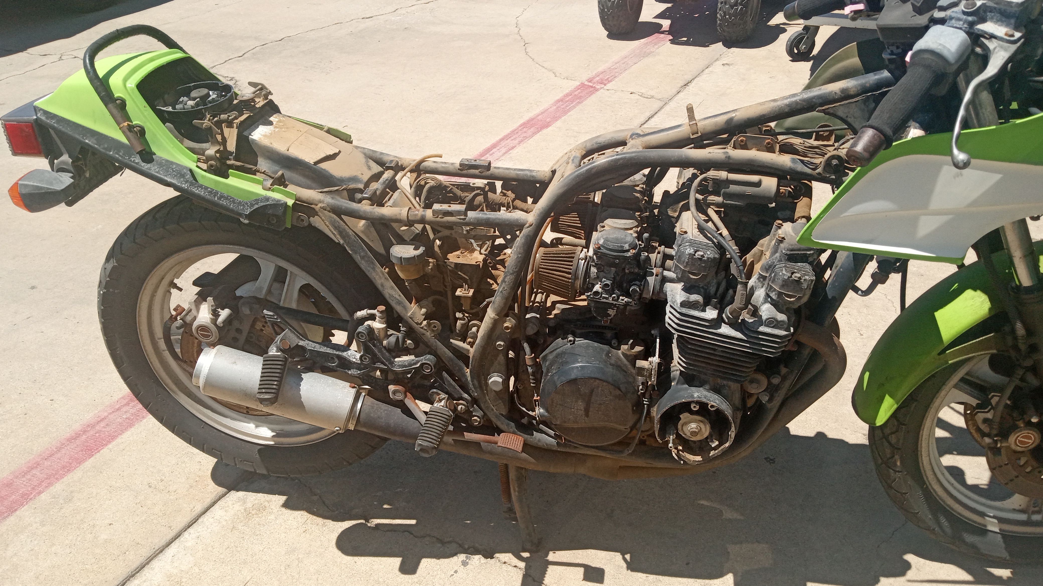

Picked it up today.
The good: It spins over & has compression :)
The bad: Everything else.

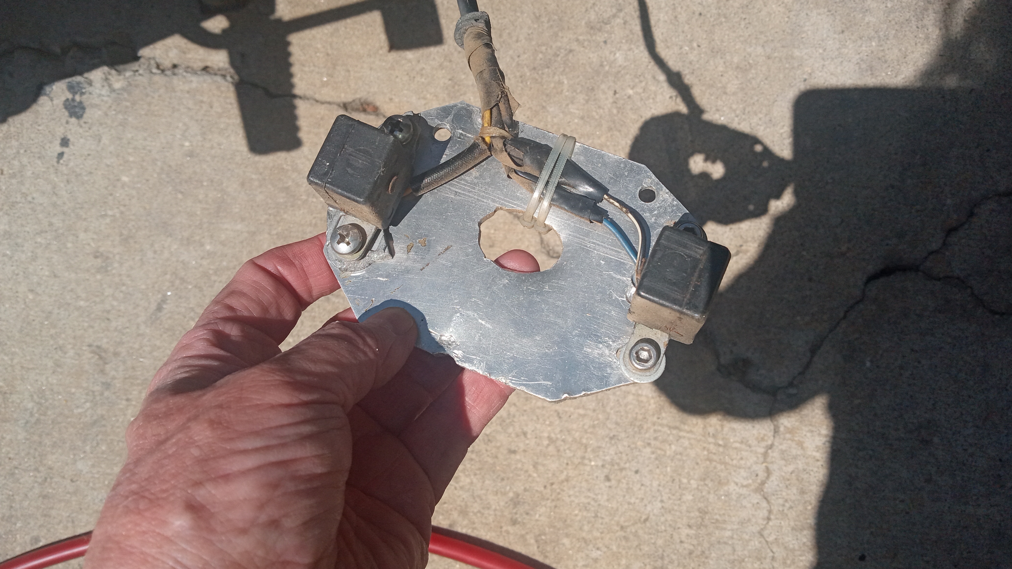

The ignition stator & pick up coils etc are buggered & two of the three mounts are fucked. Time for some TIGgery pokerery... and the oil pressure switch is missing (behind the ignition at the bottom of the housing)

Immediate needs:
1, Kickstand spring (found, ordered)
2, Complete ignition gubbins. (wish I knew what crate my left over GPz750 stuff was in, will look this week)

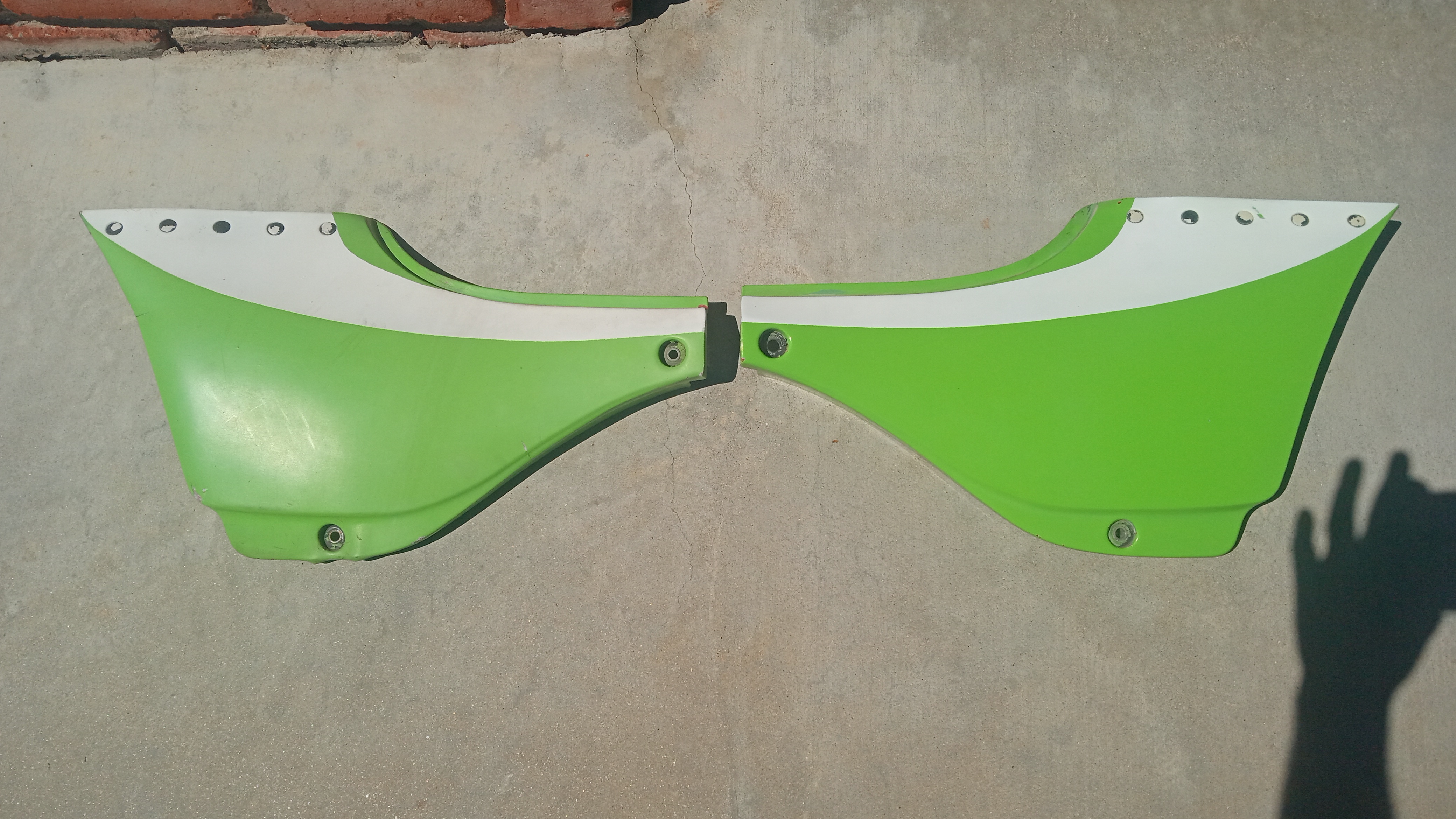

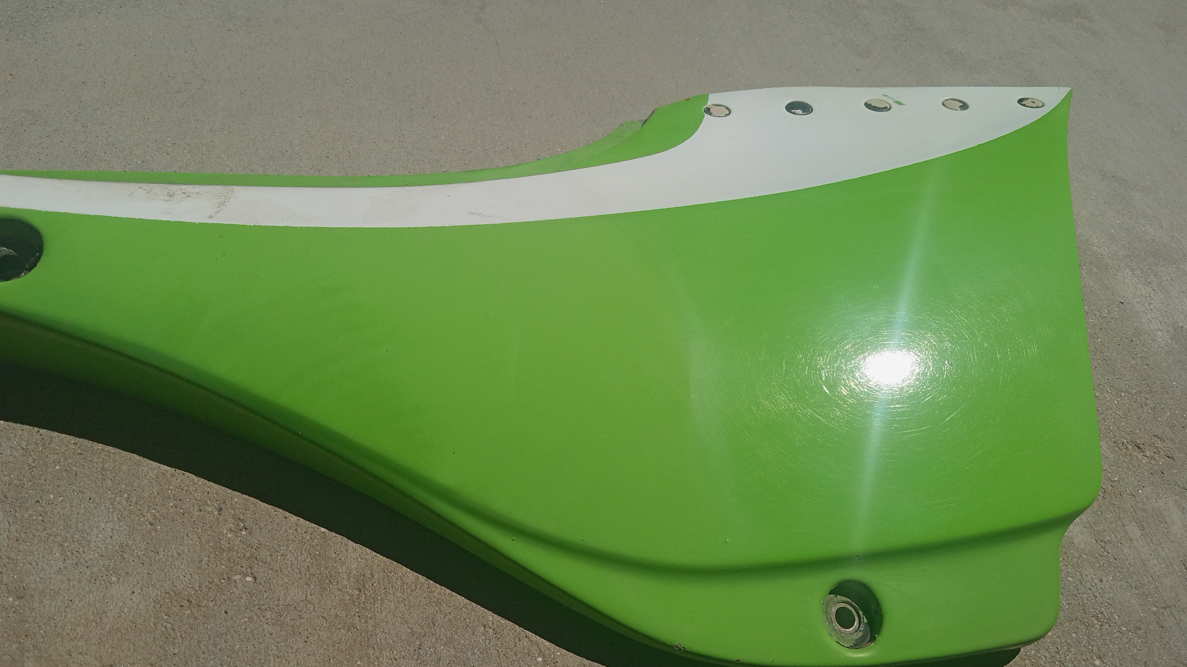

Bought home the side covers. Gave one of them some attention with the buffer to see how it responded just for shits & giggles. Paint job will be one of the last jobs, along with the seat rehab...

Gonna wet sand the other side cover before buffing... altho I have some Diamond Cut somewhere, you could put a shine on a paving slab with that stuff.

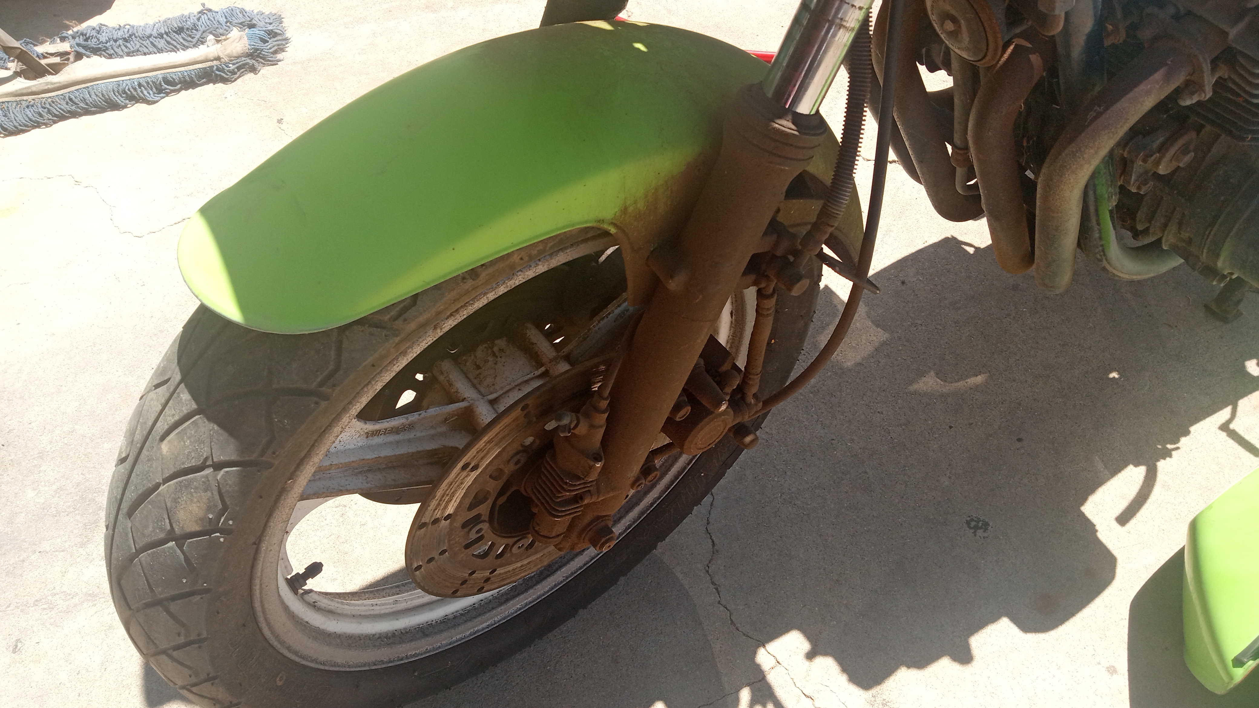

Other good news: The tires hold air.
Bad: The rear brake lever is seized solid, stomping on it produced no movement at all. Ditto the gas cap lock. There was a lot of WD40 dispensed today. It will be getting the AeroKroil treatment next time I visit. Engine will be coming out so it can be tipped on it's side for the upcoming TIGgery pokery.
Rear pegs are all wallowed out & drooping like whisky dick, it will likely get some from one of the ZX11-C's.

Decided on JB Weld for the ignition repairs instead of TIG. The original formula stuff will do the job, so just ordered that from Amazon.
I also need to build up the missing piece of the crankcase which also has the lower cover bolt doodad & it can be used for that too, done that a few times. There's gonna be some Dremel engineering.

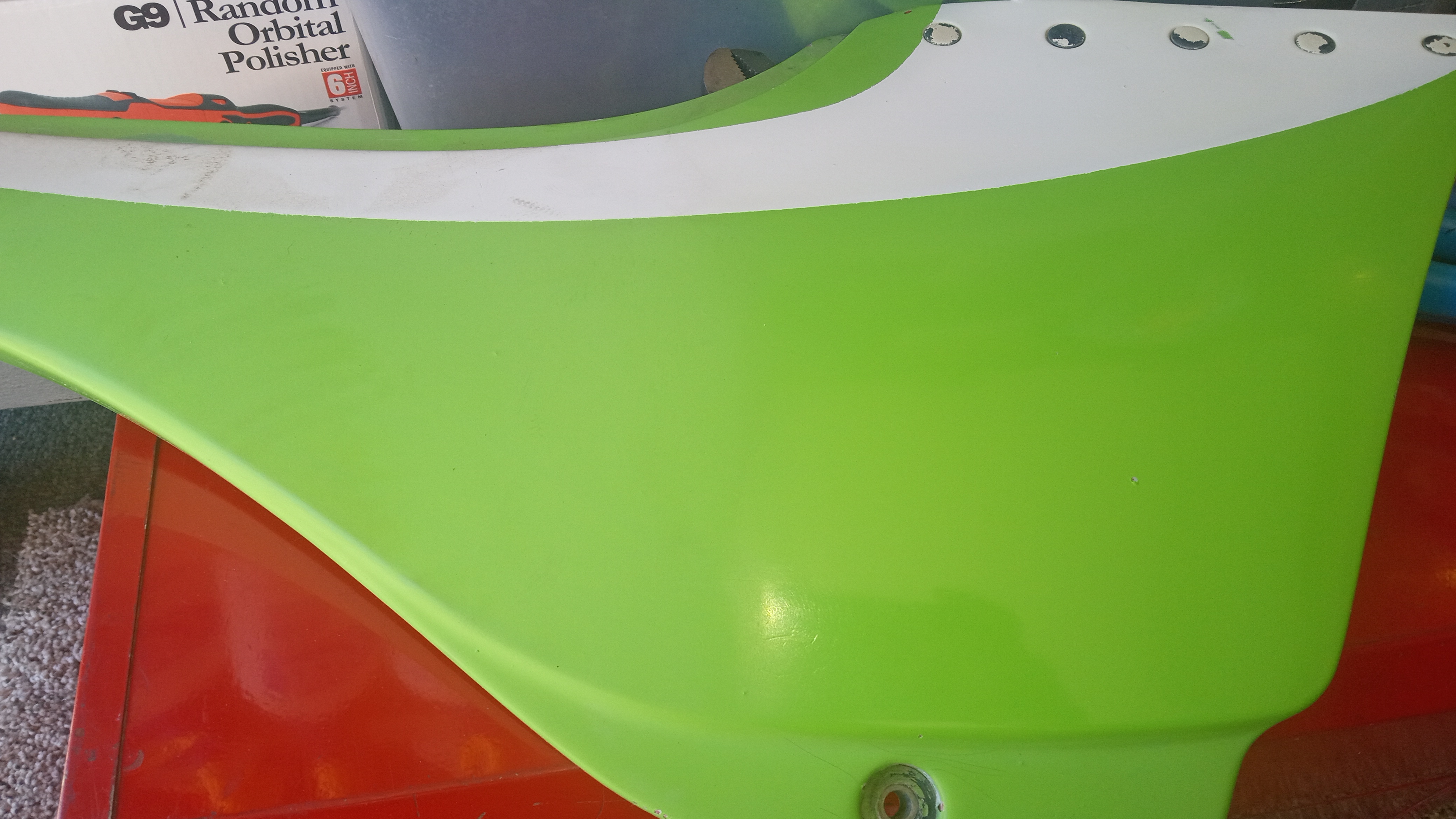

Gave the side cover some attention with #1500 wet & dry, then buffed it again.
Still not very shiny, lots of fine scratches still there, I think it was painted over a #360 sanding job, so will need taking down with #400 & starting over, but my paint mate will be doing that when it gets the WRR paint scheme... altho with that said, I could hit it with #600 to #1500, but that will likely remove the green/white. There's no clear-coat on it.

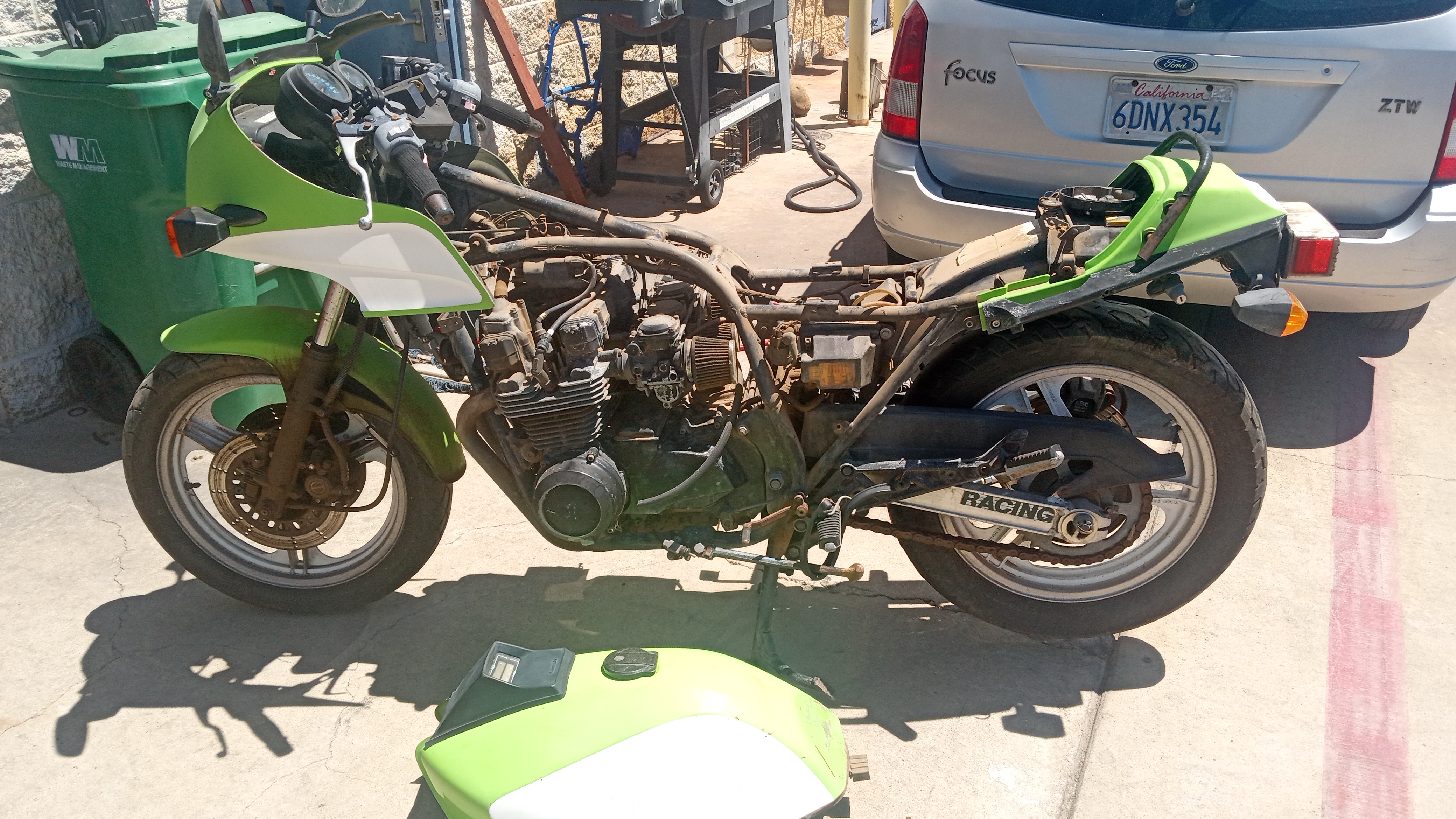

Pressure washed it, removed tail, strakes & r/h footrest mount/rear m/c etc.
