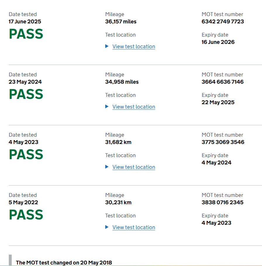

How to they work/know MPH from KPH? I cant see it being different clocks apart from the face is that would be expensive. Is it in the drive at the wheel? Reason i ask is, My bike is a Dutch import and previous owner told me the clock was changed to MPH by his previous owner but the ODO still reads KPH. Looking back at MOT history this may be correct as it did 31700km back in 2023 and in 2024 it had done 34960 miles.

I am pretty sure the speedometer needle is accurate. Go through to many speed cameras and when say at speed limits i dont seem to be any faster or slower than other traffic but its more the ODO counter i am curious about. You can see here what is making me think it could be counting KPH. First two UK MOT's are in KPH.

Easy enough to check, ride it for 3 miles and see if the odometer has gone up by 3 or 5
