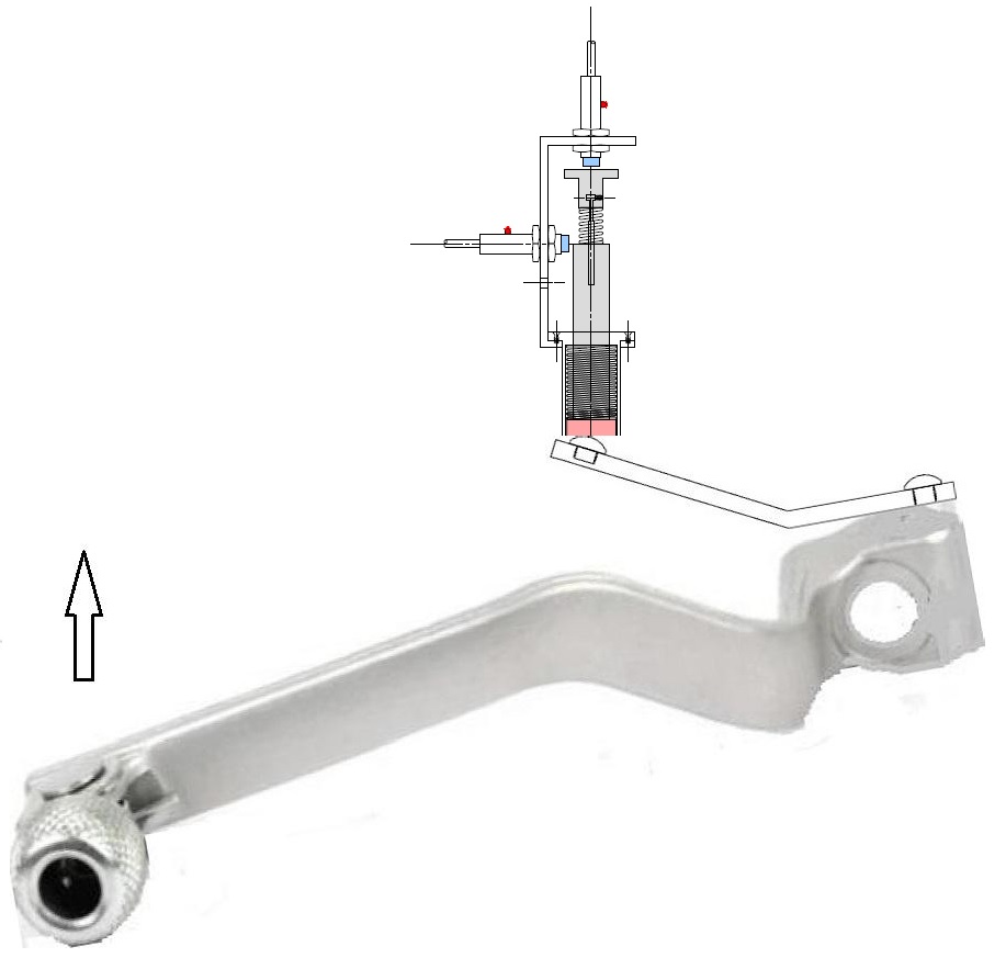

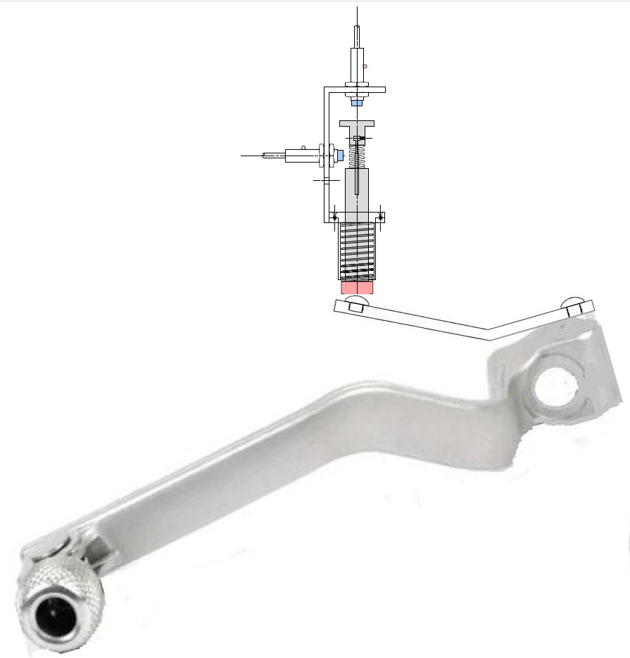

Here's some quickshifter information that I put together after I'd fitted it to my Fantic Caballero 500. No reason why it couldn't be used on other single cylinder bikes. Hope you find it interesting!.
Quickshifter mech at rest.jpg (61.05 KiB) Viewed 533 times
Quickshifter mech gear up.jpg (58.93 KiB) Viewed 533 times

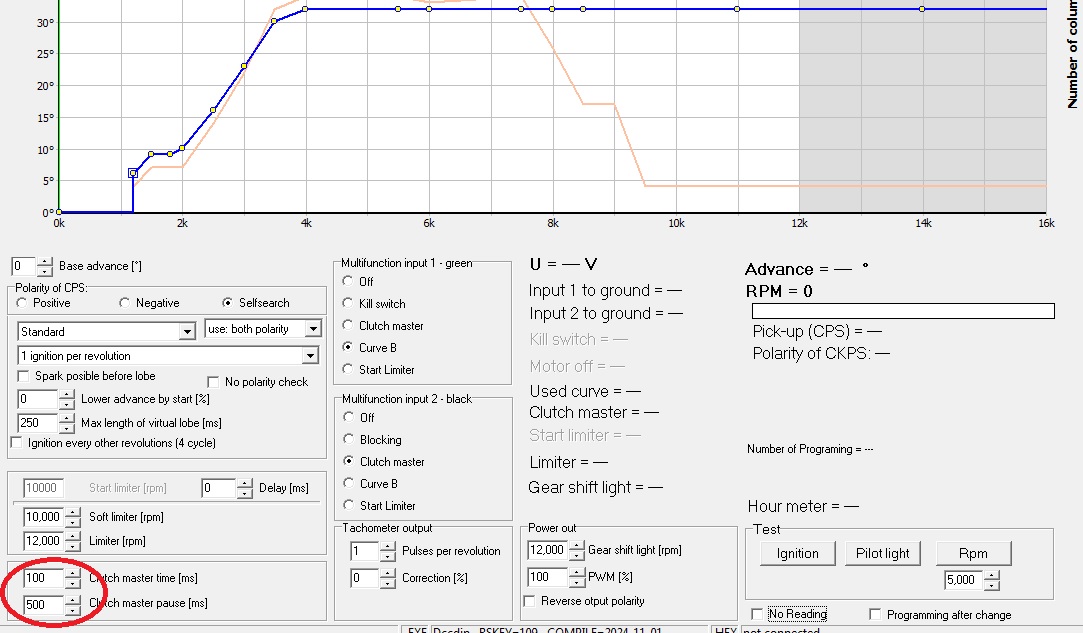

A quickshifter does a bit more than just move the great lever, stuff like cut the ignition during the shift. If you want it to work on the downshift you'll need a slipper clutch as well. There's probably a bit more to out as well.
On the bikes I've ridden that were fitted with a quickshifter I've found them best used at higher revs, they're not for around town use.
Dave G
Posts: 143
Joined: Thu Sep 18, 2025 5:55 pm
Has thanked: 88 times
Been thanked: 71 times
Re: DIY Quickshifter
Post by Dave G »
Pirahna wrote: Tue Feb 03, 2026 4:14 pm A quickshifter does a bit more than just move the great lever, stuff like cut the ignition during the shift. If you want it to work on the downshift you'll need a slipper clutch as well. There's probably a bit more to out as well.
The one Iv'e made works just on upshifts and cuts the ignition for a time period setup in the Ignitech CDI.
