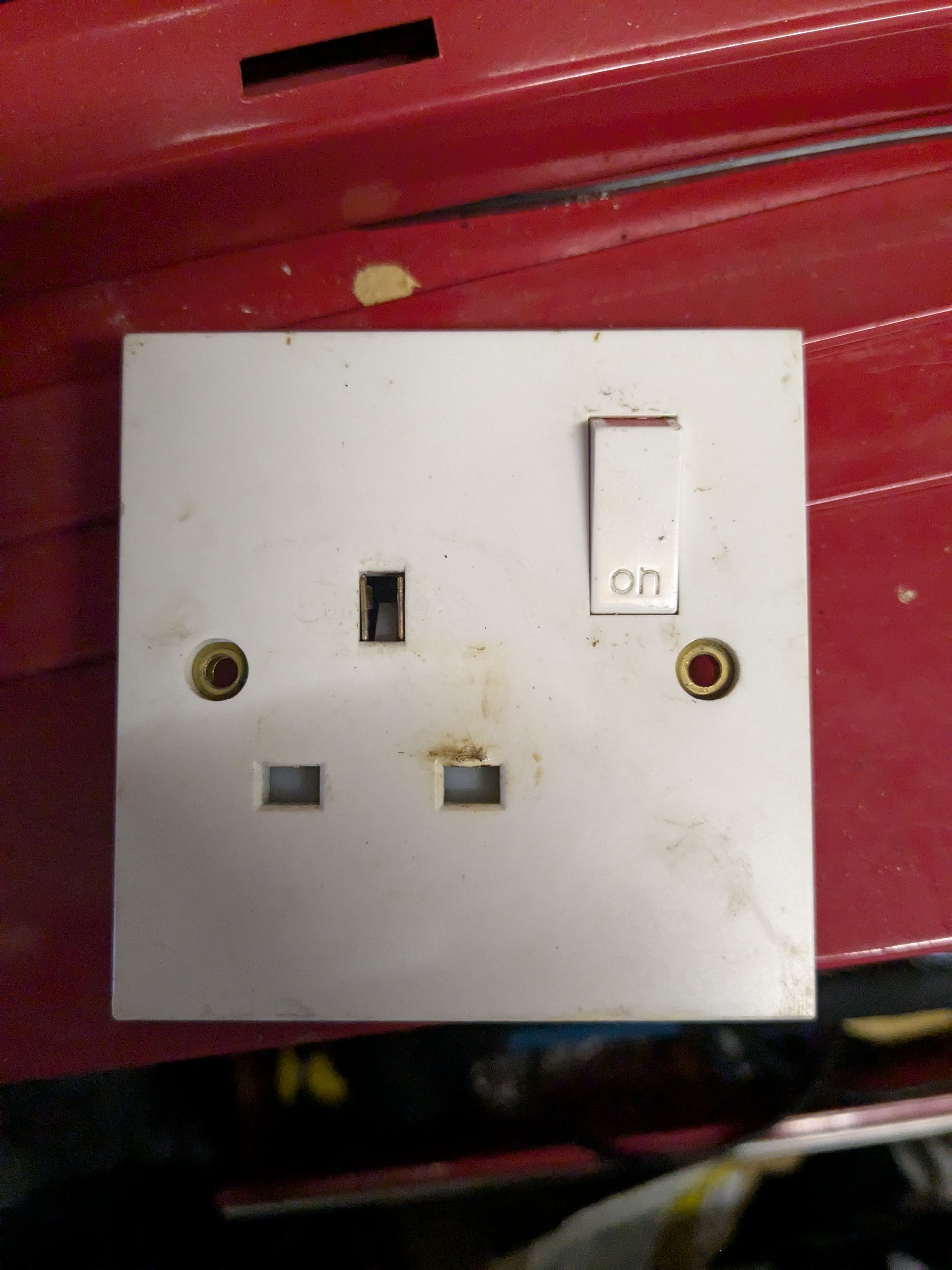

I thought I'd try my granny charger today, had the car two months and had never had it out the bag.
Got an alert from the app that charging had stopped after 10mins.
Checked the charger and a red thermometer was flashing.
Good job these chargers have temp sensor in the three pin plug part ...
Fitted a different face plate I had laying around and it's done the same (this is a socket in the garage near the main door).
Assume I really just need a brand new decent quality socket and it's nothing to do with the wiring?

No.mangocrazy wrote: Sat Oct 04, 2025 5:42 pm Hmmm, so £1000 was too spendy, so you decided to do it yourself?
I've not done anything except change a face plate when the first one melted.
From using the 13a granny car charger.

In which case I'd suspect the granny charger is pulling more than the rated 13A. You might also check the wiring to the socket to see if that has overheated.
- Posts: 17499
- Been thanked: 9495 times
Re: Replacing an old fuse box
The wiring all looked good and cool, the first face plate was full of dead spiders when I took it off and to be fair, there was always slight discoloration near where the live pin enters.mangocrazy wrote: Sat Oct 04, 2025 6:16 pm In which case I'd suspect the granny charger is pulling more than the rated 13A. You might also check the wiring to the socket to see if that has overheated.
The 2nd was one left over from when I ripped the kitchen out, so was also 20+ years old.
I think I'll buy something much newer and try dropping the rate in the car from 13 to 10 amps.
