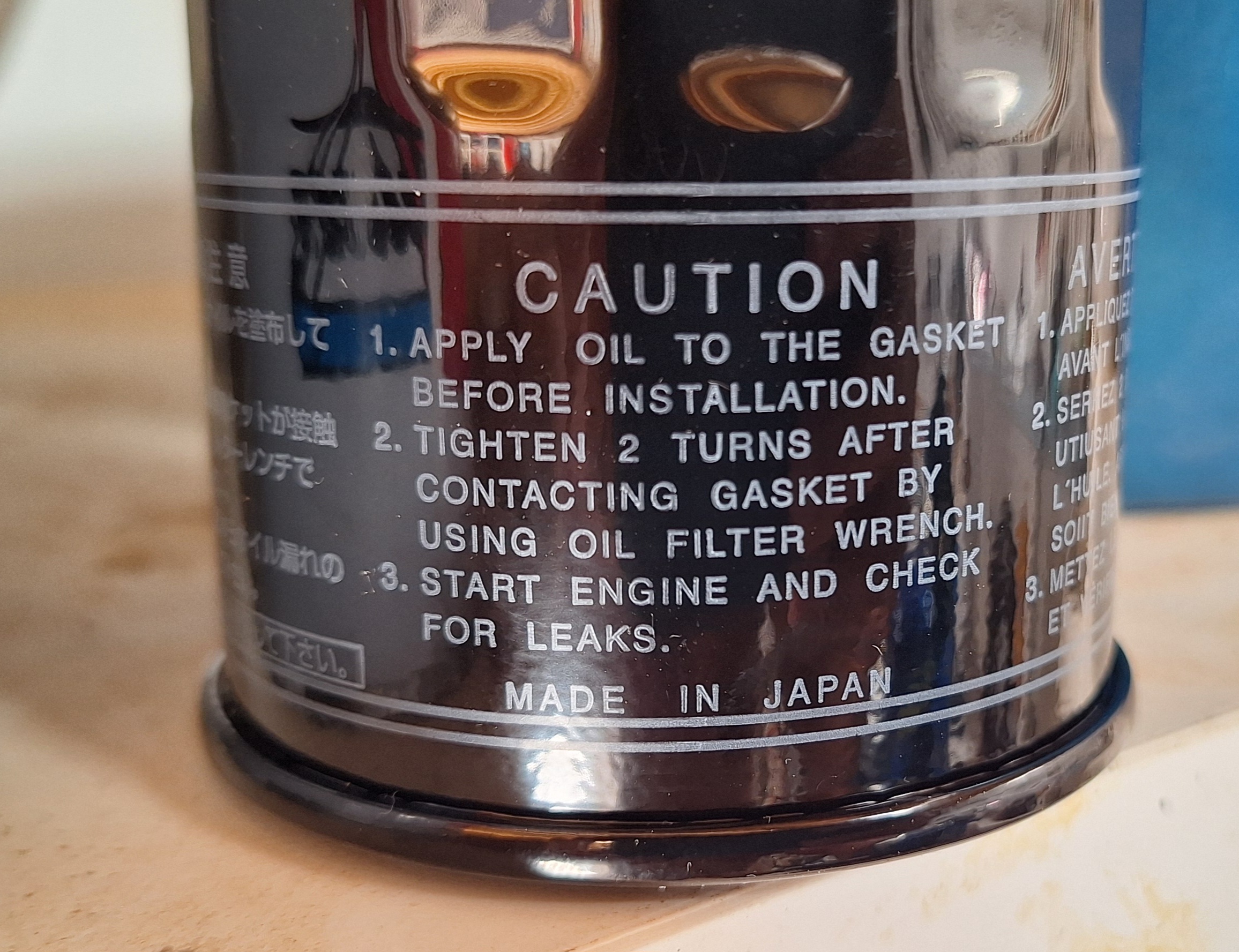

Just dumped the oil and checked the genuine Suzuki Oil Filter.
It says 2 turns after touching gasket.
Blimey 720 degrees sounds a bit much. Does it seem OK to you lot?

After a Google it was 2 turns.
I managed 1.25 turns by hand. Then fashioned a tightener.
Wound a strip of ratchet strap round it. Grabbed with Molegrips. Twisted thru 180 then was able to get another half turn when it gripped :)

Good luck getting that off next time. Two full turns? Sounds like product liability lawyers are writing the manuals these days.
Posts: 12162
Been thanked: 4529 times
Re: Suzuki Oil Filter
Two full turns sounds fine to me, surprised it doesn't have a torque to tighten it up to. You can buy large sockets that fit oil filters, they're not expensive, I don't understand why anyone would use a strap wrench on one, the Honda one is particularly good as it has a threaded bit that makes getting the filter out of the socket lots easier

2 turns is the same as the GSXS as it's the same motor. On the GSXS forum there's been a lot of talk about it, from people who do hand tight only to those that use a torque wrench. The torque setting is 20nm. I don't have a torque wrench (well I do but don't trust it from experience) so last time I did hand tight and then another half turn with the socket. I bought the HiFlo filter with the nut on the end. The HiFlo filter says hand tight only, unless specified in the bike manual. There is also talk that the HiFlo one has a different gasket vs the OE so needs less turns...bugger knows if true.
Anyway hand tight plus half a turn didn't see an leak for the last year. The OE filter, fitted by St Neots Suzuki, I took off wasn't overly tight.

If it's any consolation, last time i changed the oil/filter on the Yamaha, I managed to undo the filter by hand.
The whole point of the big thick O ring is to seal and grip the mating face. Too tight is just as bad as too loose!

I tested it again today and was still tight as hell.
Did 50 mile ride and no leaks.
Reckon it's OK. Thanks all :)
