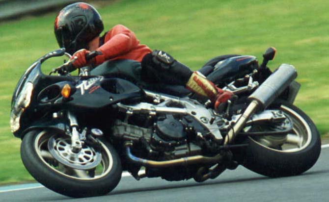

Well, every day's a school day. Never knew about that. In fairness I only kept my TL1000S for 2 or 3 years, as I needed to sell it to put food on the table without going deeper in debt (out of work for 15 months). I've posted this before, but this is me on the TL at Oulton Park, Old Hall corner.
