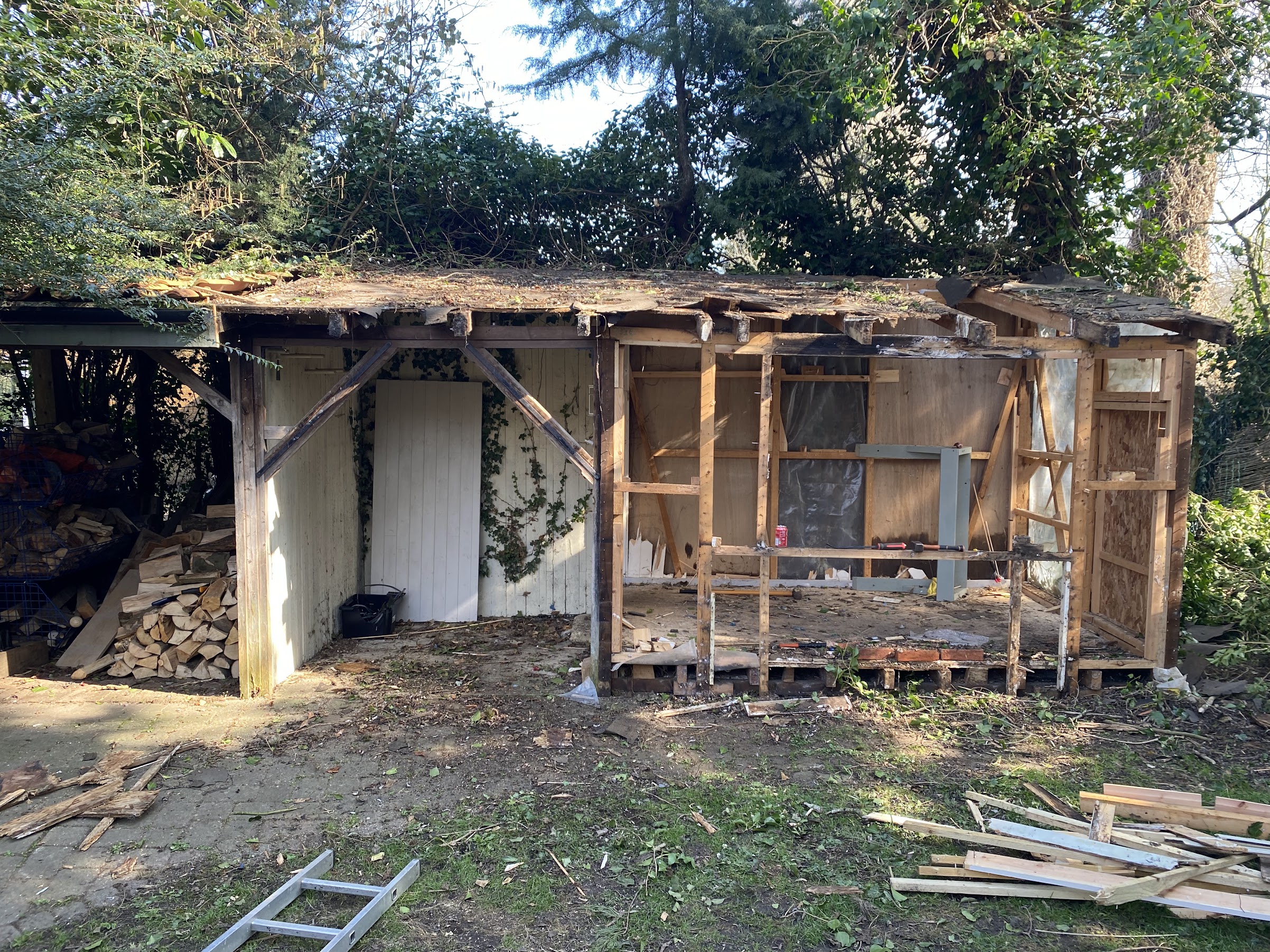

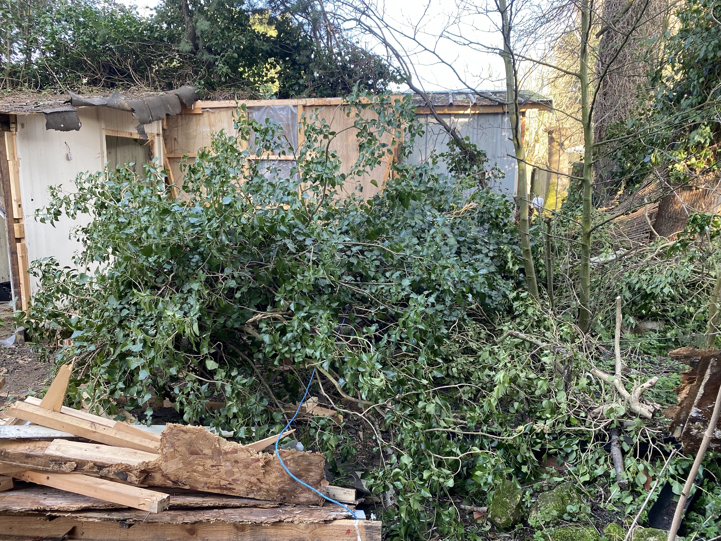

Anyway, this is the building being demolished, not a great picture but the only one to hand...
This is part way through removing the cladding and the wiring. The goal is to remove the right most room, the middle covered area and retain the area covering the firewood. It feels like there's enough support in that third to standup by itself.

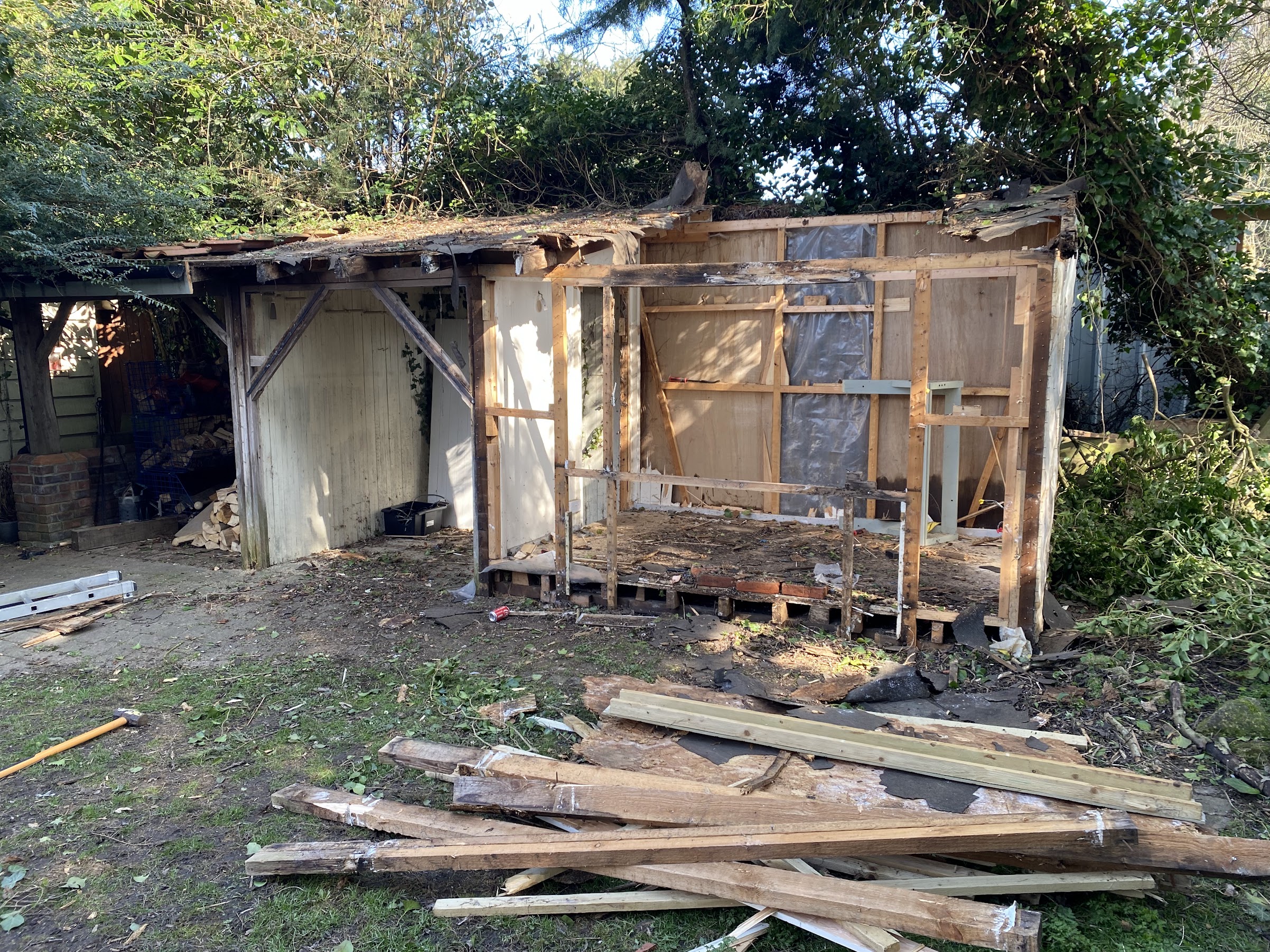

As an aside the back wall is timber framed with ply on the outside and cladding on the inside. The opportunity to insulate it wasn't taken and mostly weirdly/stupidly they built the double layer wall and only then decided to put lights up so the wiring was fed through both layers and along the wall on the outside of the building!
Here you can see the start of the removal of the tiles which was made more difficult by some of the roof being solid and able to hold my weight and some less so. You can also see a tree at 45 degrees and at the point it's unclear as to whether the shed is holding up the tree or the other way around.

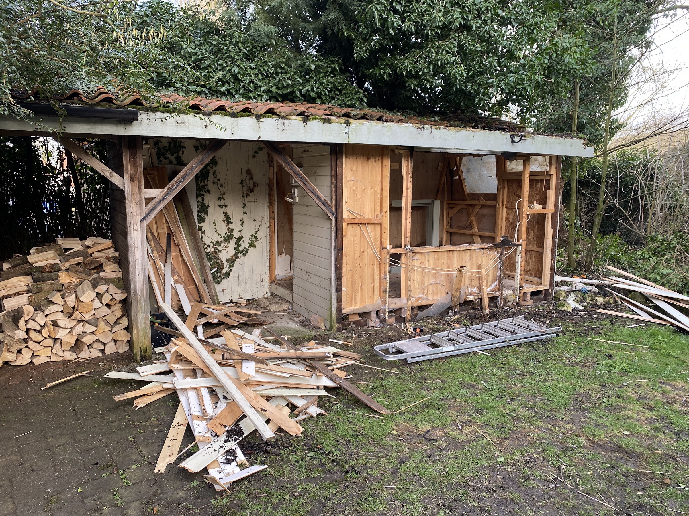

Taking the roof off was a lot of work as it was tiled, there was roofing felt, osb board and then some kind of plasterboard or particle board on the inside...

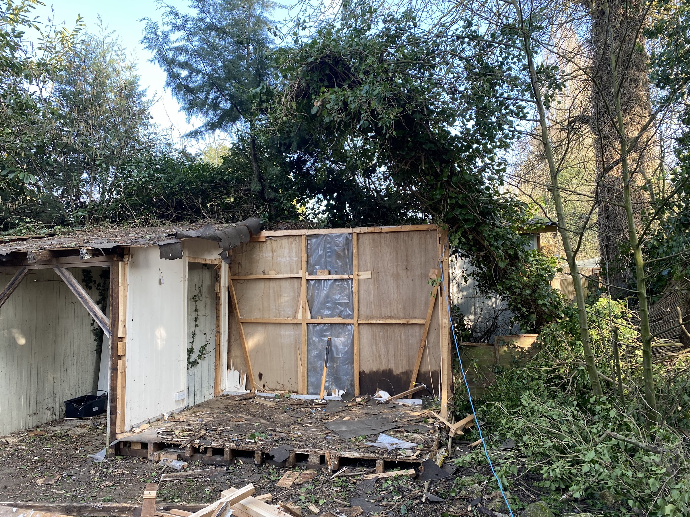

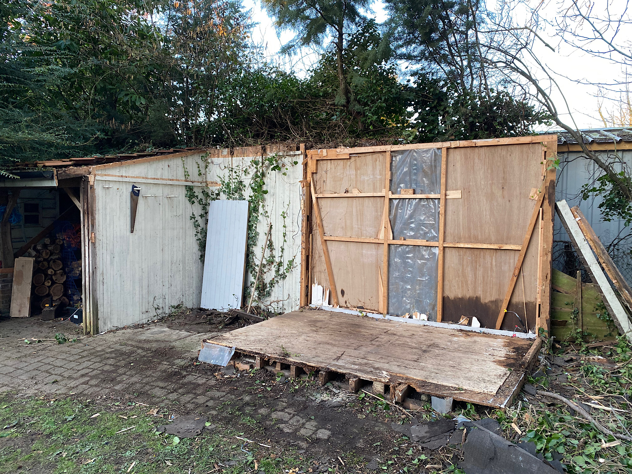

So I get to this point and it's clear that although the tree can move somewhat independently of the shed wall, bring the wall down carried a significant risk of it falling down on me. I readied the chainsaw, tied some magic blue rope to the tree and then found I could just pull the tree over...
Then I could just cut up the tree with a chainsaw. While I was doing this I found that the tree killed a rat by falling on it... heads up buddy. This is where I currently am. I have two more weekends before the new building is delivered.

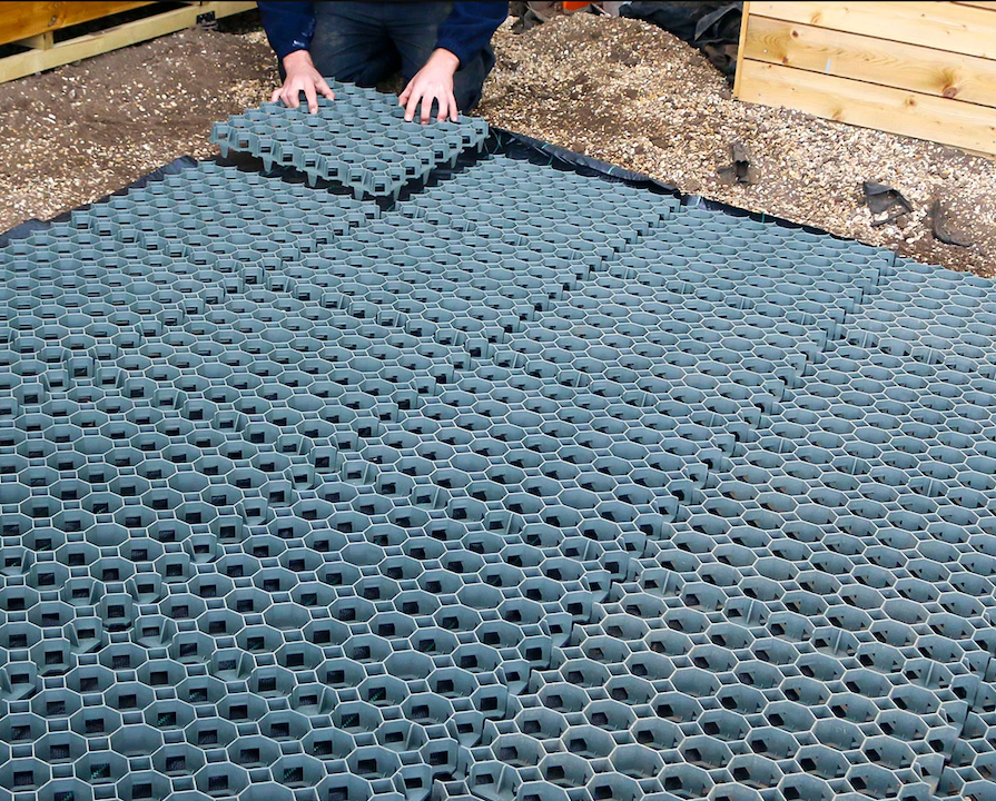

The first office I built at the previous house was on a slope and the company provided plastic grid sections that you filled with pea gravel and built the floor on metal pads that you could adjust the height of. Like this...

I really liked this system and it worked really well for a slight slope.
The new garden is level so I've ordered Dunster House's new system of grids that cover all of the base that you fill with pea gravel to spread the load. I need to work out a way to get this level with the concrete or just take out the concrete. Doesn't look too difficult though.
I've got that stuff on my drive at home. It means I can have a crunchy crunchy gravel driveway that I can park on, but it all stays put and the ground doesn't end up with two tyre tracks where you always drive. You can't even see the grid unless you know it's there and look for it specifically.

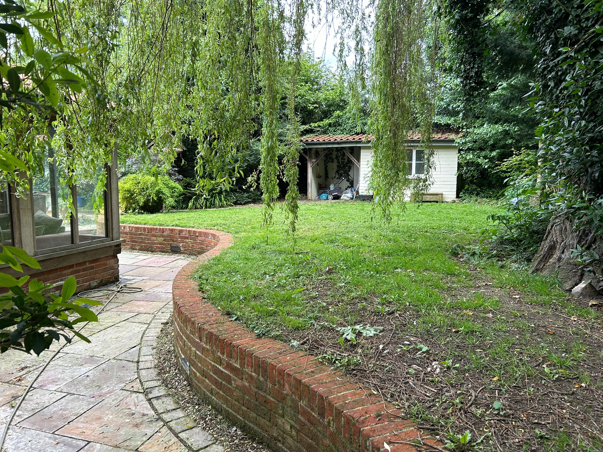

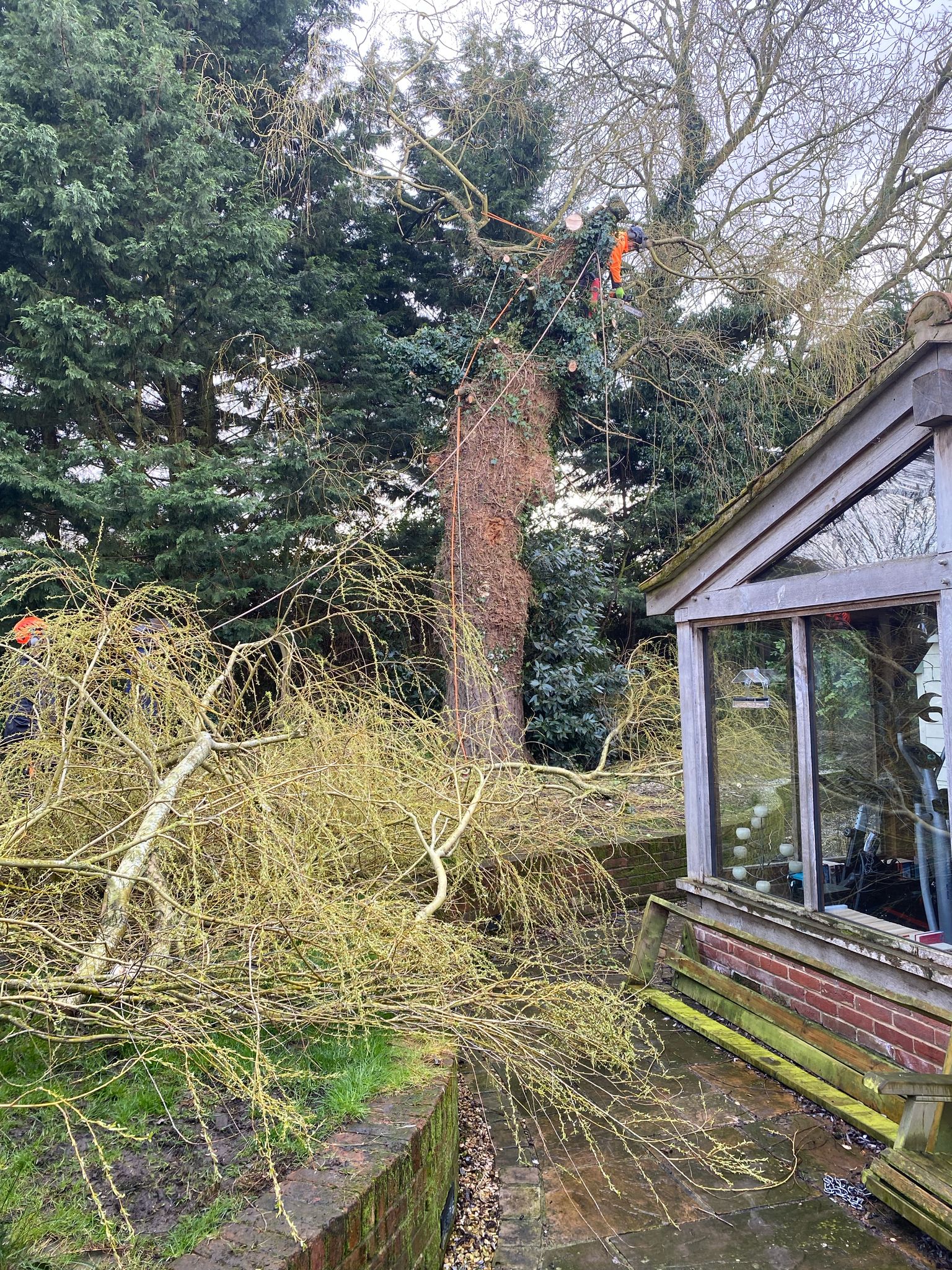

Bonus picture of the willow tree from the first picture being dismantled. A few weeks ago I cut all the bases of the ivy on all the of the tree and the willow looked pretty sketchy. We had it inspected and decided that it needed to come down. The top was healthy but the base was rotten... borderline safe to climb rotten. It had been pollarded some years ago and then just left to its own devices by the previous owner. Still, should get plenty of firewood out of it.

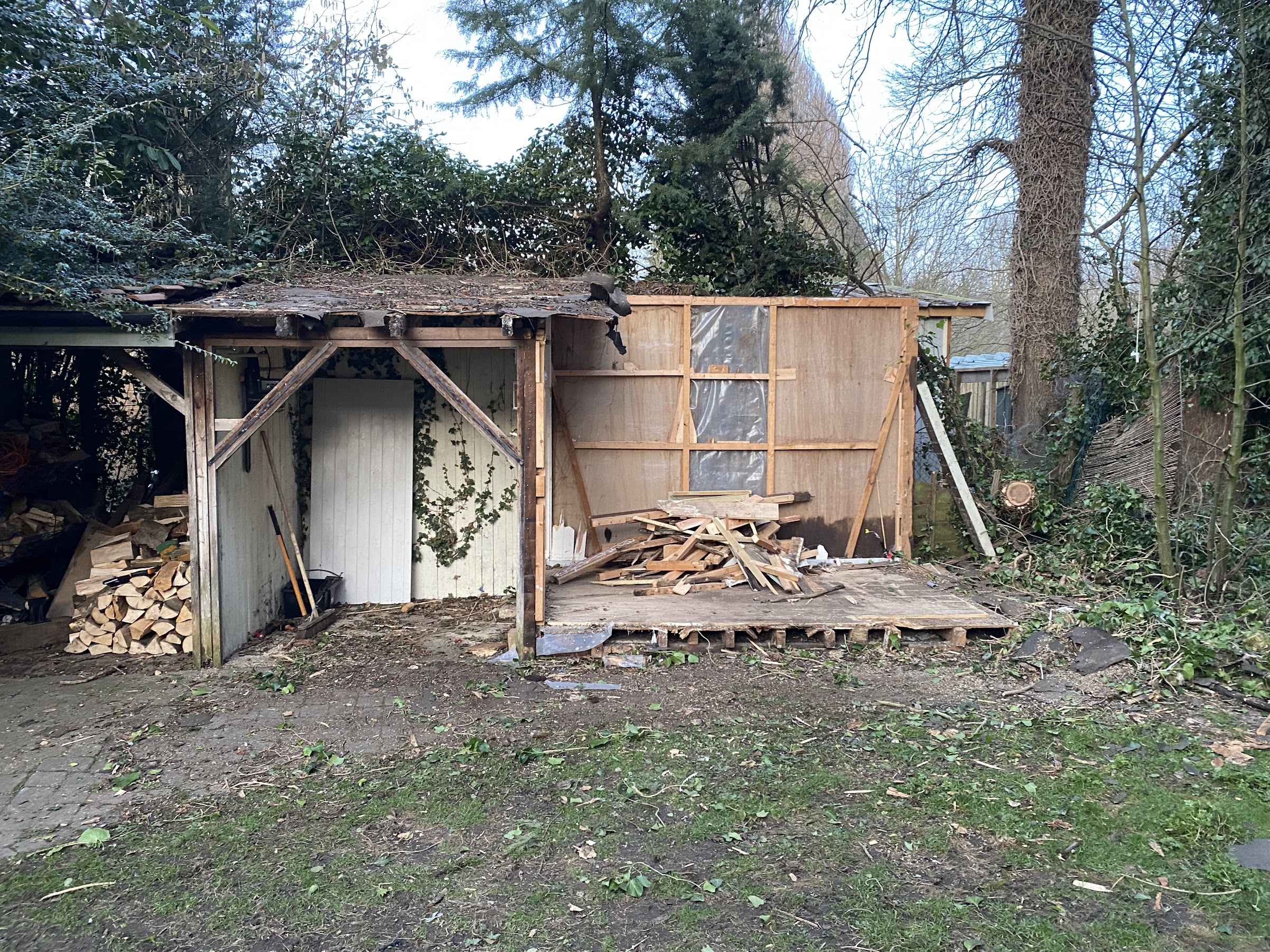

More progress…
Will start to take the back wall out tomorrow and as much of the floor as I can.

Progress at the end of the weekend...
