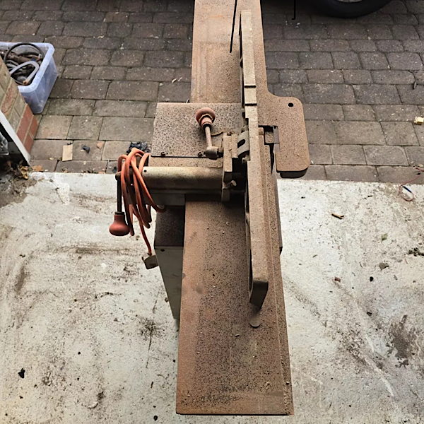

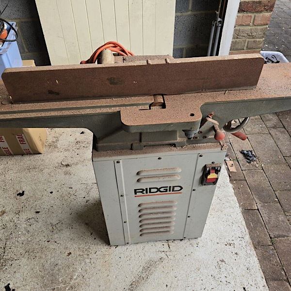

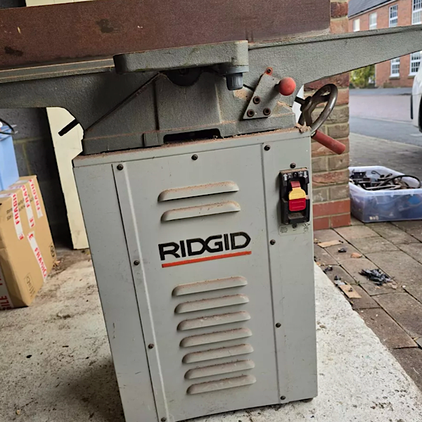

As posted on the new tools thread, I bought myself a RIDGID Jointer via eBay locally from a chap who was moving house. He bought it new a few years ago while living in California and brought it it back with him. He said he spent 16 months living in the US and that was one year, three months and thirty days too long, I didn’t enquire as to his thoughts on US politics at this time.
The jointer is a 6” 1100w jointer which can be configured in 120/110V or 240/220V depending on supply, I have seen it running on 240V so I don’t think I need to poke around there. It has cask iron tables (roughly 4ft from end to end) and fence (45°-90°). The cutter block has 3 resharpenable / replaceable blades and apparently it is possible to retrofit a spiral cutting block with indexable TCT blades but that is very spendy for a machine that set me back £80.
Photos from eBay
As you can see, all of the machine finished cask iron is covered with surface rust which will need sorting. I’m also tempted to change the on/off switch for a no volt release (NVR) switch, add a soft start module and see if it is possible to duct the waste chute into an dust ex tractor.
Photos from eBay

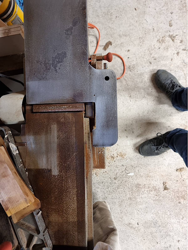

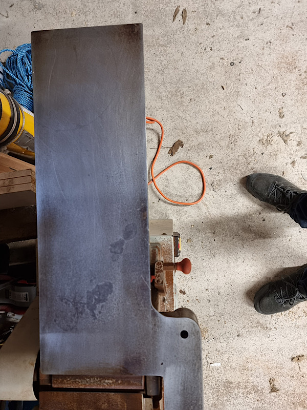

Stage One - leaning up the tables.
Yesterday, I took some 240grit dry ‘wet & dry’ paper on a block of timber to the whole table top which took are of the majority of the surface rust off without too much both and after brushing it down, it felt reasonably smooth to the touch. Once I’d finished tinkering for around 30 mins, I brushed everything clear before liberally coating the freshly sanded sections with WD40 and covered the jointer with a dust sheet.
I had 20 mins spare early so I took the same 240grit paper to the infeed table with a liberal application of more WD40 as a slip medium before wiping everything down with ethanol based hand sanitiser (liberated from the post Covid office supplies) before drying carefully and applying more WD40 to hopefully prevent any rust reappearing:
Very pleasing when compared to the simply sanded outfeed bed whose clean patch is from where the fence was positioned. Next job will be to repeat the same on the outfeed and fence before moving onto the cutter block.

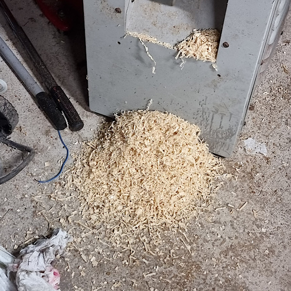

Spookily I have just set up a cyclone on top of a 25l paint can attached to 30l Titan wet & dry vac with power outlet via 38mm hoses for hand power tools to save on the number of paper bags I get through. I can throughly recommend the Cen Tec (CTS) dust hose adaptors as they allow seemless switching of the hose to the next tool etc.
Time will tell to see how much debris the cyclone bucket catches and how much ends up in the vacuum bag, I’ve not cut a huge amount today but it looks like it a good amount so far. I’m tempted to attach it to the Evolution table saw and mitre saw to see if it copes but I don’t think the power take off on the vac is rated high enough for their motors but I’m sure there is a solution out there
I think 4” hoses are considered the minimum for planer thicknessers / jointers etc so I may be sweeping up wood chippings for a while unless something comes up on eBay / FB marketplace which takes my fancy.

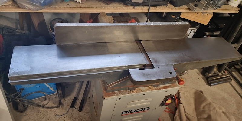

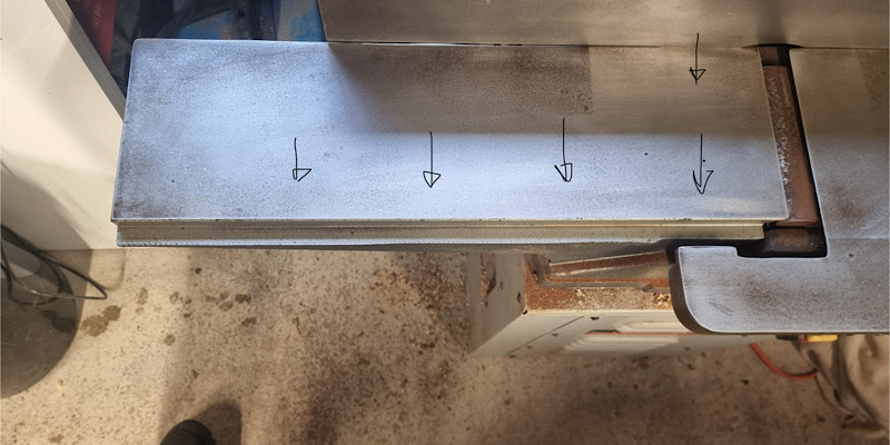

A bit more progress on the tables and fence
Not surgically clean but now rust free and smooth to the touch. I couldn’t find the paste wax I thought I had so covered it all in WD40 and a dust cloth while I source / find some wax and read up on how to adjust the outfeed table which dips in the areas show by arrows below. I used a 4ft level and a sheet of paper (couldn’t find feeler gauges either
I’ve got the original English and Spanish manuals (sadly been stored in a damp shed) so I’ll refer to them before braving the cold to search for feeler gauges and wax, before seeing if I can tweak the outfeed table towards being co-planer with the infeed which is surprisingly flat and level.
You can just about see the rust on the cutter block which I’ll attend to once I’ve trued the outfeed table.

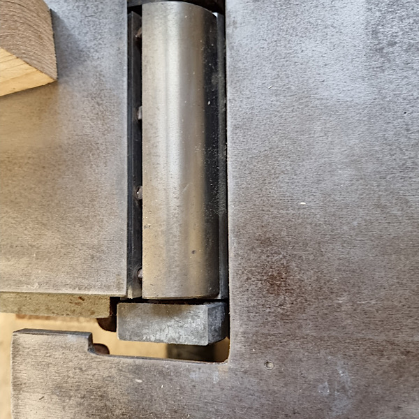

Very little progress this week as I felt pretty rough over the weekend. Both tables and fence have been liberally coated with Briwax and buffed to a shine.
I’ve wound the outfeed table up and down a couple of times which appears to have solved the co-planer issue as I suspect the jointer has been picked up using the tables which as altered the seating in the dovetails, it needs a cranking handle / wheel with I think 1/4” square drive to make that task easier.
With both tables wound right down, there is plenty of room to access the cutter block without necessarily having to remove it, so I’m hoping the Jenolite Rust Remover gel I’ve bought will take care of that task on the block and knives so I can look at either sharpening the existing knives or replacing them for the princely sum of around £20 for a set of three.

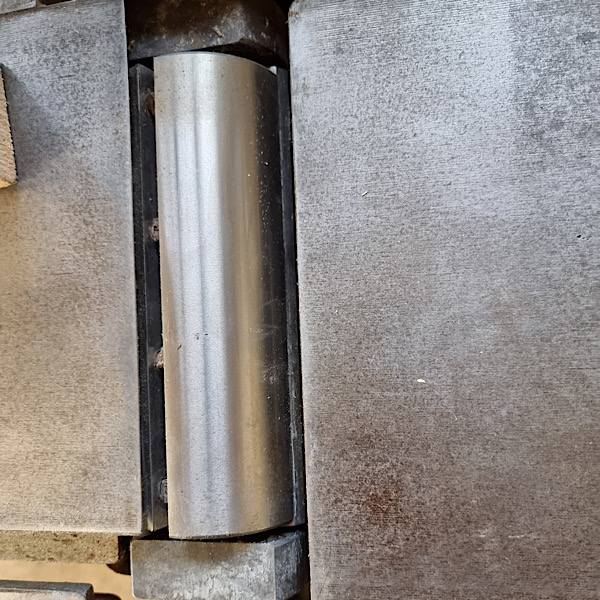

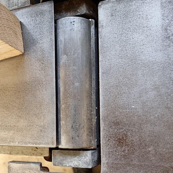

Just finished the rust removal from the cutter block, using Jenolite Rust Remover which has done a pretty good job, although I did go over the worst third with some wet & dry to speed up the process. I’m left with a cutter block like this:
Two of the knives polished up nicely, the third (worst) is still a bit scabby but I gently cleaned up the cutting edge with some 400 grit to clear the worst of the surface rust. All waxed and polished up.

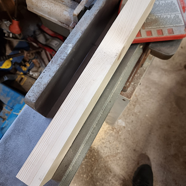

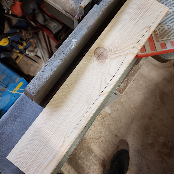

I took ZRX61’s advice after cleaning up the cutter block, wedges and blades and through a length of 4x2 CLS through it on face and edge.
There is a fair amount of tear out from either the huge knot or from blunt / poorly set up knives. I did them using a piece of timber on the outfeed table setting the to just above flush with the surface (as per manual) but they made need fine tuning a touch. I set the fence to 90° to the tables, outfeed is now bang on co-planer to infeed and I ended up with:
Face
Edge
Resulting corner is exactly 90° as far as my engineer’s square, daylight and eyesight could tell me, with no rocking of the square anywhere along the length of the corner.
Face
Edge
