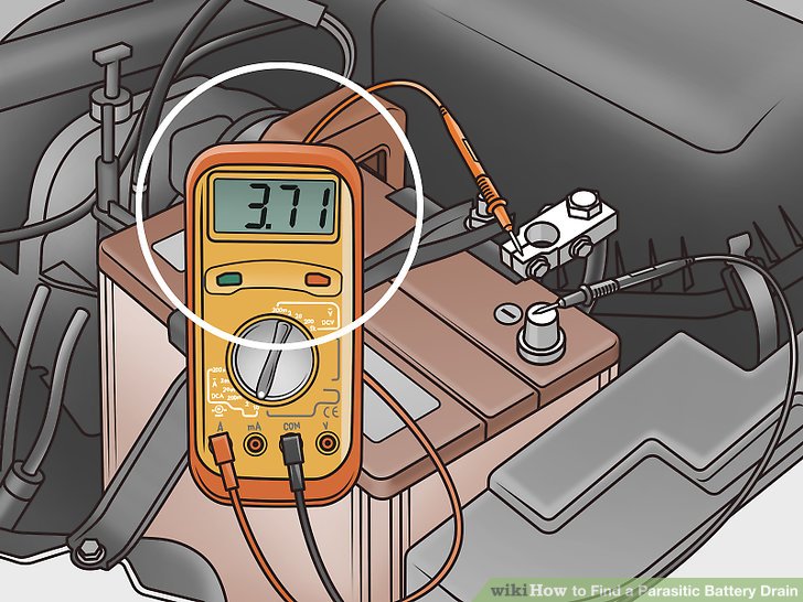

What is this meter telling me. Is that 3.7 milliamps? I need to go hunting for a Parasitic drain tomorrow but not 100% au fait in using the meter.

It all depends on the range you've set your multimeter to, I think. In the illustration above the switch is set to mA - milli-amps.

Wiki says up to 50 milli is OK as you have radio clock, alarm and the likes taking a bit power. I had a slight loom fire in the camperbus what i thought i sorted but my start battery died quite quick this winter. The fire seemed to be in the window wiper motor wiring all at the fuse box what i bypassed but as i just put a new battery in i want to double check that that setting is just a low 3.7mangocrazy wrote: Sat Jan 18, 2025 10:44 pm It all depends on the range you've set your multimeter to, I think. In the illustration above the switch is set to mA - milli-amps.

I'm not sure what an acceptable level of parasitic drain would be. The drain in the picture above wouid be 3.71 milli-amps, which is a lot lower than what Wiki says. But to be honest I wouldn't know what's a 'good' amount of drain or a 'bad' amount. You need to ask someone like Mr D...

They say between 20 and 50 is OK. I dont have a radio but now i am thinking about it i do have a soundbar on the dash running through an Inverter. I must check i never left that on and the soundbar on standby. I may have bought a battery for nothing

Shouldn't the wire be plugged into the "mA" socket in that pic? So the pic shows 3.71A not 3.71mA.
You can look for parasitic drain in the fusebox BTW, standard automotive fuses have a set of terminals on the back too put there for precisely this reason. I haven't actually watched this vid, but the pic shows the idea. Maybe the content is accurate too!
Bear in the mind that the (hopefully!) tiny reading you get across the fuse isn't the loss in the system, it's just the drop across that fuse. You'll be reading volts not amps too. You then need to consult a table to see what that reading corresponds to as an overall draw. For the most part you're just looking for an 'on/off' level of assessment though, so any reading other than zero shows you've got a 'leak'.
It's not really possible to say if 3.7A is a lot or not BTW, it depends entirely on the circuit. I wouldn't have thought an electric window circuit is designed to draw 3.7a continuously, so the fact you had a fire isn't surprising. What constitutes "too much" current is a factor of time as well. 3.7A for 10s is quite different to 3.7A for 2 hours of course!

Ah that looks a better idea. I never made it down to my bus today and a also know i dont have them fuses but i may just go order a mixed bag and swap them over as i test them. Saying that them in the video look like the little micro fuses. Hopefully then come like that for the larger standard version.
