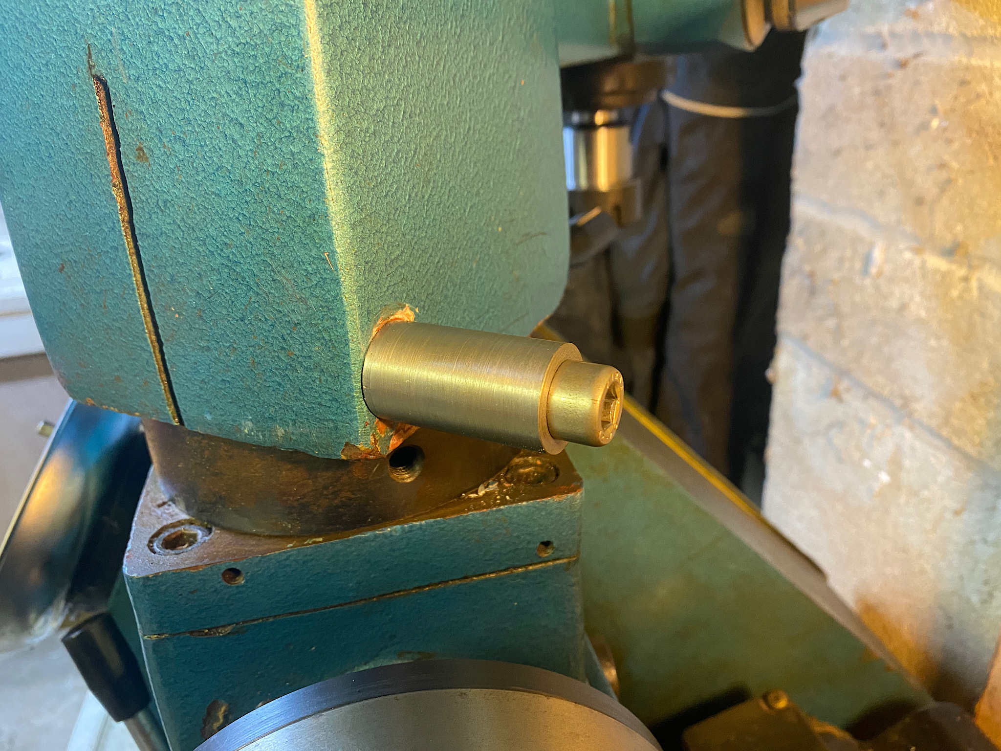

There was no lock on the milling head to stop it swivelling so I fashioned something from an m10 cap head bolt, a washer and an old socket and that now locks in place. This feels like something I can make on this machine when I know what I'm doing but for now this is ok.

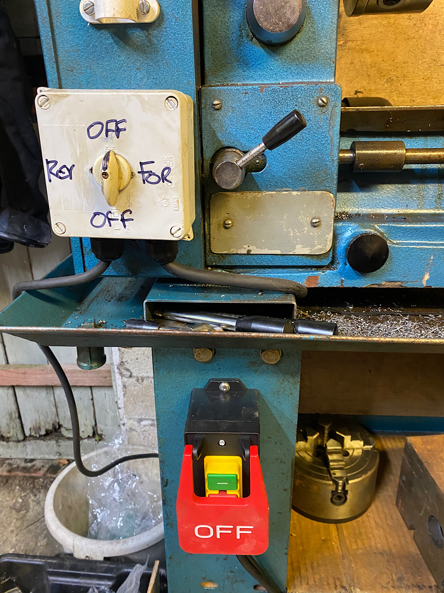

There's no e-stop on this machine so that's something I need to address pretty quickly. I also need to make sure that it doesn't restart after a power outage... there's a term for that switch but I've forgotten what it is.

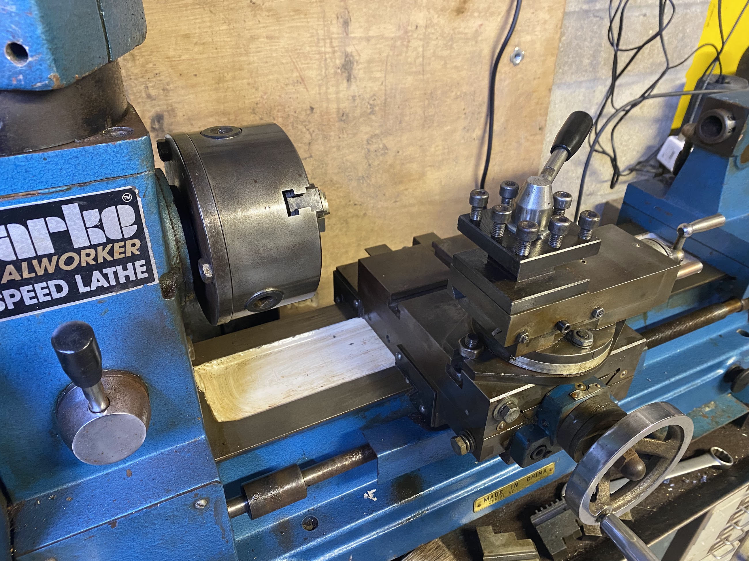

I was nervous about starting 'making chips' but there's no time like the present. I started off with the tooling that was with the machine and did some facing and turning down of some BS 4360 43A 25mm steel stock I bought and cut down. I just ran the machine on the speed it was set at which was 400rpm I think and I have no idea if that was right or not. It felt ok and I was pleased that everything seemed to be working.

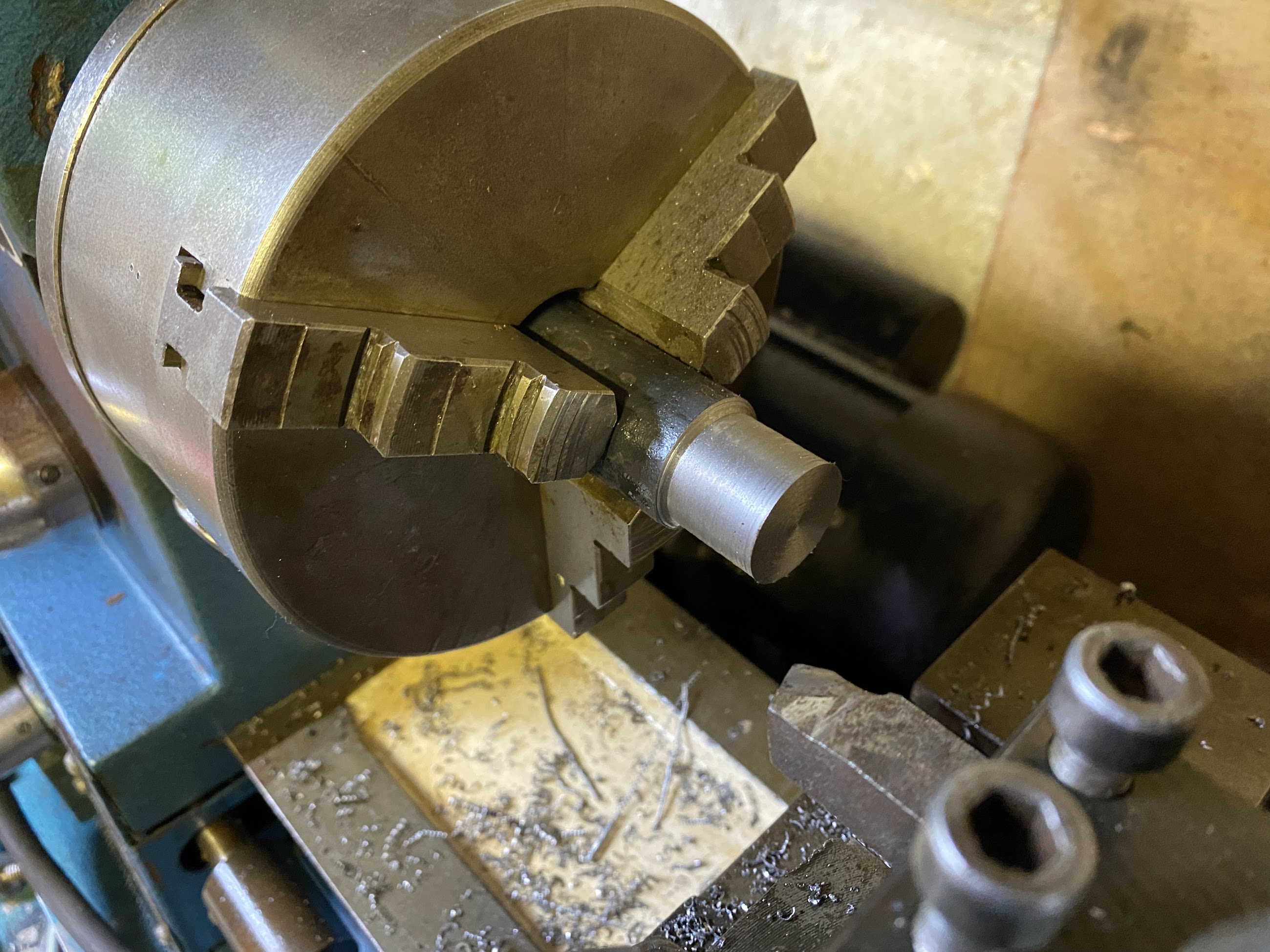

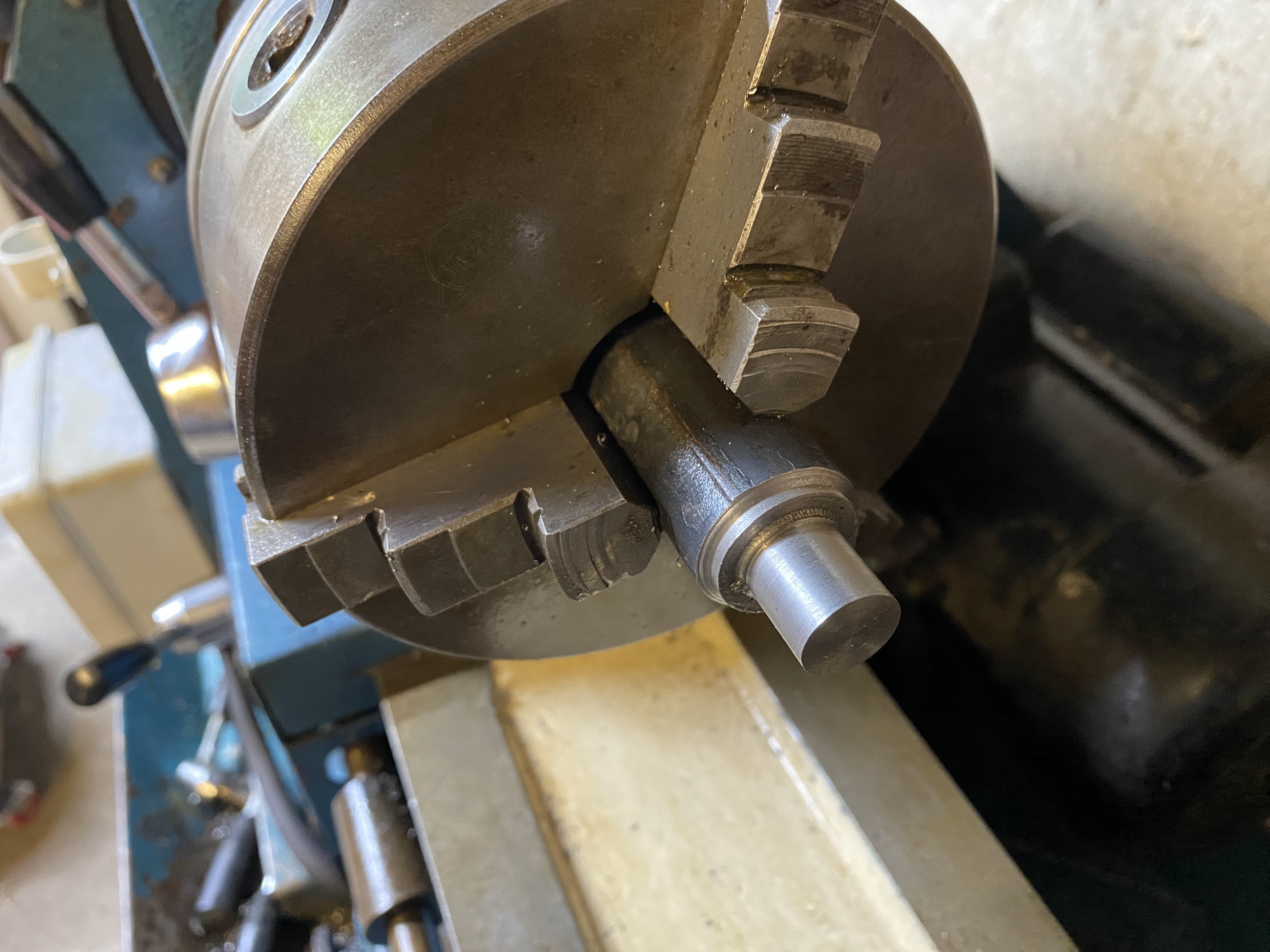

I had a load of 6mm hss blanks and thought I'd try making a left hand and right hand simple cutting tool to turn down the piece and to face it. This wasn't too hard to do on the grinder and actually the tools felt a lot nicer to use. They weren't making the same disconcerting noises and the cuts seem to be better. They look the same in the pictures but the sound was better. It was satisfying to make some tooling though.
Surface finish obviously leaves a lot to be desired but I need to understand what the lathe speed should be at. I'm also using the driven feed on the slowest speed and I don't know if that's right. I also don't really know how much I'm taking off each run but it feels like about 0.5mm. I need to read the manual and understand what the markings on the machine actually mean.
I'm using cutting oil by the way.
I did try and part the piece with a parting tool that the previous owner had made but broke it. I'm pretty sure I hadn't aligned the tool sufficient well, used enough cutting oil and was running at too high a speed.
I'm very pleased so far though and very encouraged to do more. I have ordered a proper parting blade with holder though.

The emergency stop / don’t restart button you are looking for is an NVR (No Volt Release) switch. I can’t help with any lathe specific stuff as I was at school the last time I had the pleasure of using a lathe and milling machine.

Looking at your pictures I'd say try: up the speed on the chuck and take lighter passes (0.5mm is removing quite a lot of metal), and your lathe isn't really heavy duty. (Not putting you /it down).
Parting tools are fussy and the cause of many rejected components. Make sure it is sharp (easy if you buy an indexed tool). Absolutely square to the machine. Absolutely at the right height (which may take a bit more to achieve than it appears). Dont let the tool project even a tiny bit more than you need. I never use the cross feed when parting - i much prefer the feel you get from advancing the cross feed manually. Go slow, both feed and rotation. Maybe start with some lumps of delrin which is a whole world easier?

I installed an nvr e-stop switch. Ii was able to get an external one that saved me messing with the wiring and it works excellently.

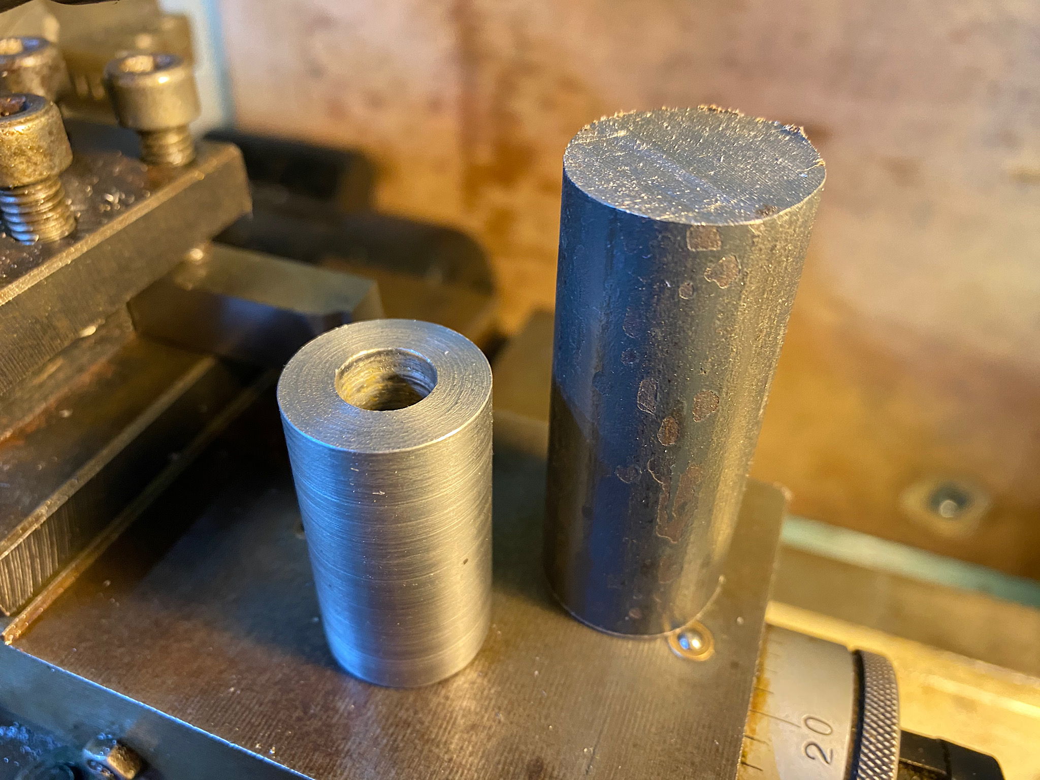

I made a spacer for my lathe. The only dimension that mattered was the through hole so making things to dimension is the next challenge. I made my own hss tools for it out of 10mm hss blanks. I drilled out using the tail stock. This is the second attempt at the spacer and have improved surface finish loads by using a live centre support. Learning loads. Changing speeds on this lathe is a pain in the arse though.
This is in mild steel.

I made a clamp that fits over the lathe ways, that acts as an end stop but also holds a dial gauge so it is easy to measure carriage travel. It helps that I found a dial gauge with 50mm range. So that sets longitudinal travel.
For cross feed travel I have an irritating and (one day hopefully to be improved) painful arrangement comprising a magnetic stand (sometimes doubles to hold a perspex screen) holding a dial gauge. A dro would be nice. On my previous lathe I made a fixture that held a vernier caliper to do the same thing - a kind of poor man's dro. I should do something similar. One day. I seem to spend more time making tools and fixtures than I do doing jobs....
From the photo I'd try upping the speed and slowing the feed rate, but much depends on the design of your tool. There's so much to learn that i sidestepped tool grinding by going the indexable route, one massive learning curve avoided. But: boring large/deep holes in mild steel like that is no small deal in itself. All good. Assuming the size is close enough to what you need :clap:

Brickie wrote: Mon Jan 06, 2025 6:14 am From the photo I'd try upping the speed and slowing the feed rate, but much depends on the design of your tool. There's so much to learn that i sidestepped tool grinding by going the indexable route, one massive learning curve avoided. But: boring large/deep holes in mild steel like that is no small deal in itself. All good. Assuming the size is close enough to what you need :clap:
Cheers. At the moment, due to the fact that I’m missing a belt, I’m limited to 400rpm at the chuck. I’ve got some new belts coming this week and then will have access to 630, 1000 and 1600 rpm.

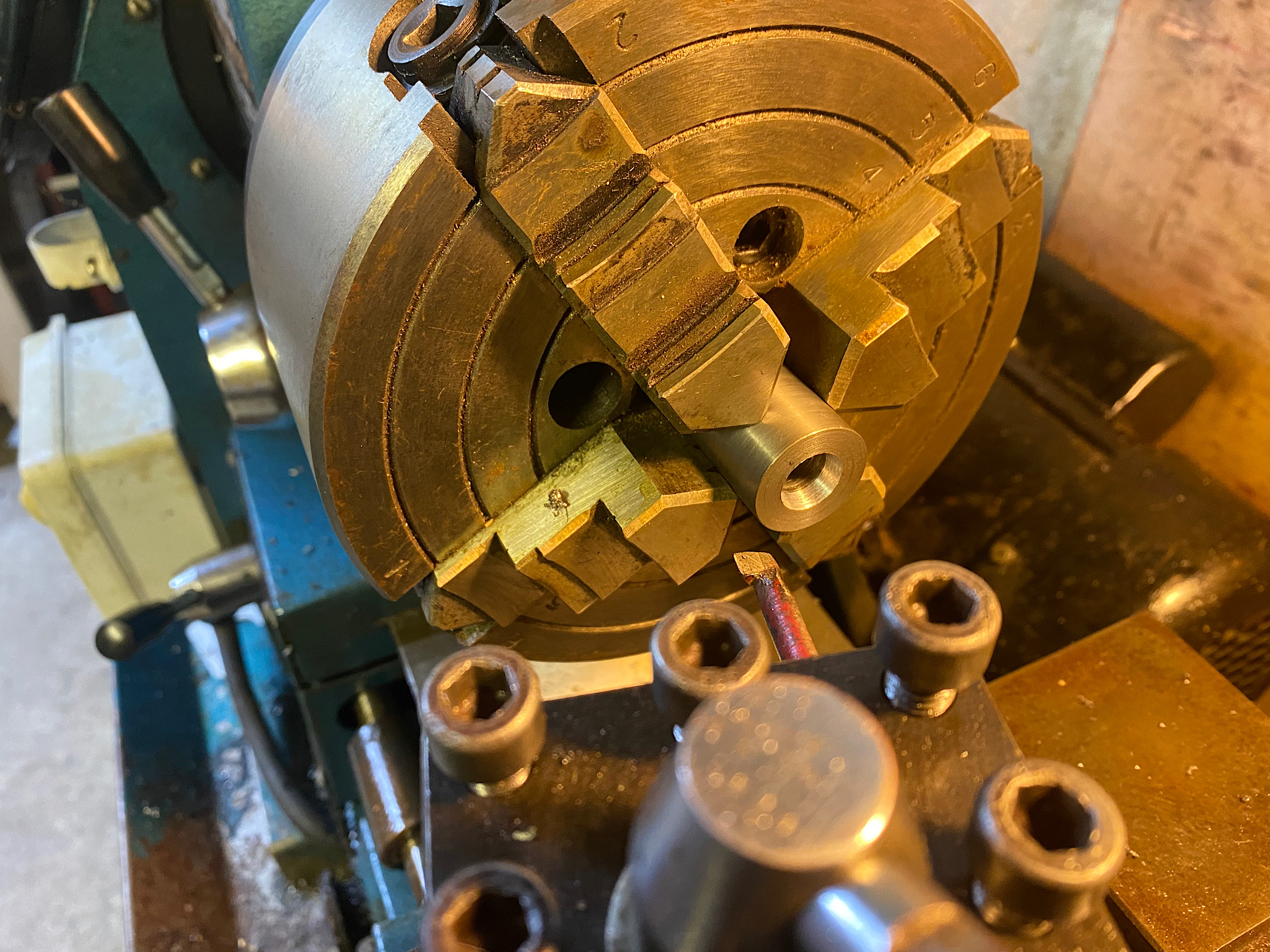

I played around with centring the piece in a four jaw chuck and cutting some relief for the cap head fillet that stopped the cap head bolt fitting home in the 10mm bore cleanly. I didn’t need to cut as much out but the only point of any of this is practice. I could have avoided having to make the piece at all simply by buying a shorter bolt but I wouldn’t have learned anything.
Centring the piece in the chuck was really hard until I got a feel for it and then it went much more quickly. I used a dial gauge on a stand and isolated each pair of jaws as I had read to do. It started to make sense after a period of playing and swearing.
