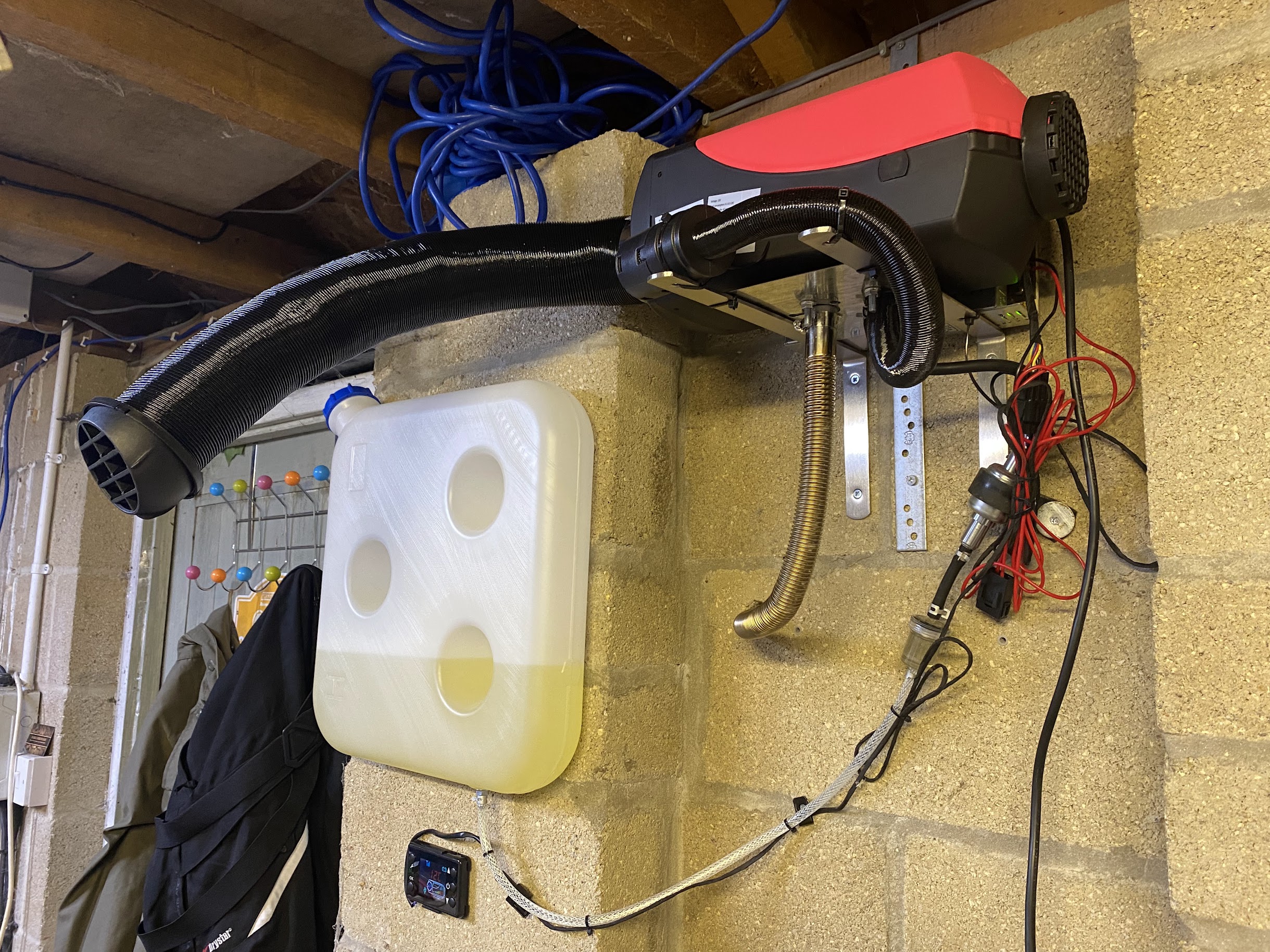

I was thinking about getting some heat in my new (to me) garage as it's big enough that I have space to work on whatever the current project is without wheeling everything else outside as I used to have to do. I saw this diesel heater on amazon at £67 and figured that it's worth a try. I did end up buying a 12v power supply as I didn't want to be messing around with batteries. I have some tidying to do on the wiring... I'll never actually do it but it needs doing.
The thing run on pump diesel but because it's a heater you can buy red diesel if you can get it. There's a garage nearby that sells it at 99p which I don't know if that's a good price but it's cheaper than standard diesel. It says it'll use half a litre per hour but we'll see. Given the garage isn't particularly well sealed or insulated it doesn't get 'house warm' but it does take the edge off on a cold day. You can also aim the output in the area you're working in and it feels warmer than it otherwise would.
I don't know if it's cheaper than an electric heater although I imagine that it would be. It's way smaller than a propane heater and there's no water vapour being kicked out.
I suspect that it would be pretty good to blow hot air over wet bike clothes.
You can even turn it on from the house with the remote.

Not sure if thats fully setup in that picture but aren't you supposed to have the corrugated silver exhaust pipe pointing outside?

As heat rises would that not struggle to heat lower down. I would have thought lower to the floor for the heat outlet would be better. BTW you can get splitters to have two outlets or more. https://www.ebay.co.uk/itm/167010476795 ... R-7fm8fwZA

demographic wrote: Sun Dec 01, 2024 10:58 pm Not sure if thats fully setup in that picture but aren't you supposed to have the corrugated silver exhaust pipe pointing outside?
Looks like a hole in the wall.

The exhaust goes through the wall.

dern wrote: Sun Dec 01, 2024 11:24 pm The exhaust goes through the wall.
Ahh, sorry I couldn't really tell from the pic. Thought it was just hanging down and I'd far rather look a bit daft and someone not be dead from asphyxiation than the other way round.

I’ve been using this for about a month and while I’m glad I installed it, it isn’t going to heat a medium size garage. It does take the edge off and if you point it at the area you’re working in then it makes working in the garage a lot more pleasant. If you want it to actually warm the room up then work will need to be done to insulate and draft proof the place. Over an hour I can raise the garage from about 2 or 3 to about 7 which sounds lousy but standing in the flow is way better.
