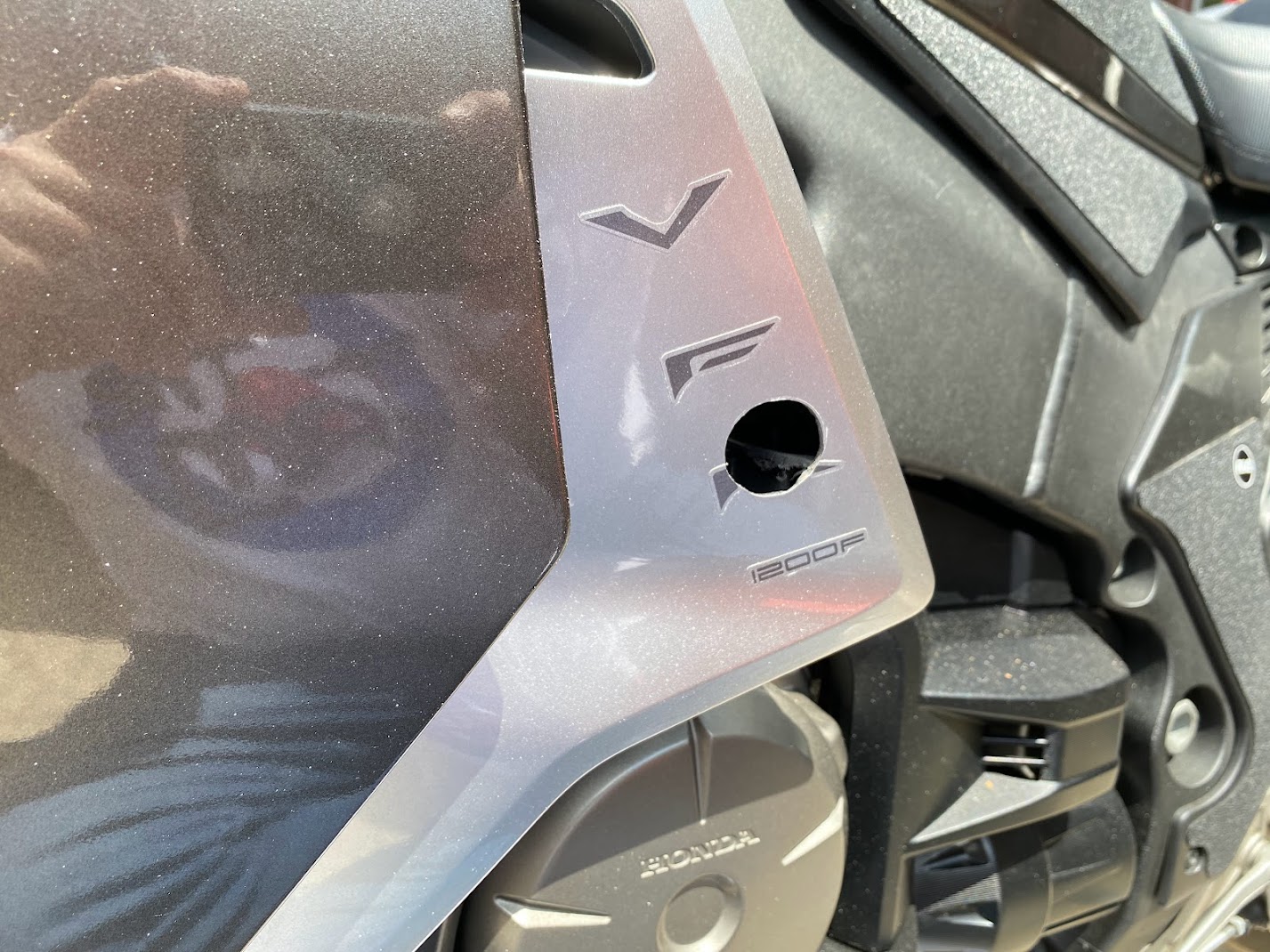

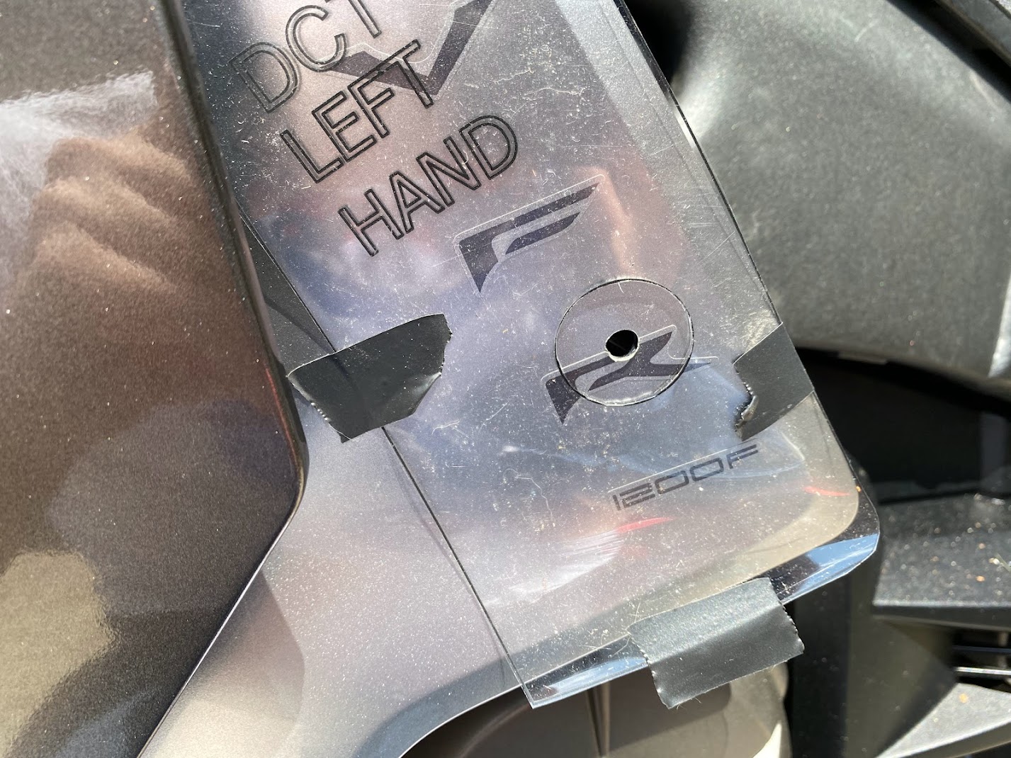

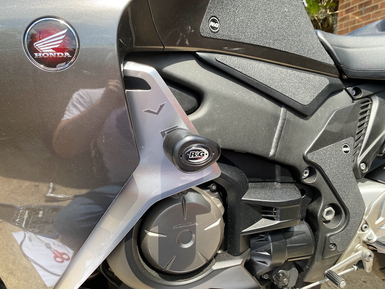

Fitted some R&G crash bungs to the bike today. I figured that the panel I had to drill through was a separate panel so it would be relatively easy to revert if someone wanted to in the future so having the extra protection to the more expensive main painted panels was a good idea considering the weight of the bike. I'm sure that they're not everyone's cup of tea but I think that they're a good idea. You can get them that are offset to the engine mounting bolt but having had those snap when the bike was dropped at a standstill I didn't want to fit those.
R&G provide some templates that work very well to get the hole in the right place and even though they weirdly print of a full page a4 containing a QR code to load up a webpage with instructions that you then print off, the quality is very good.
Re: VFR1200F DCT
As it's mounted where the R should be and it's got R&G on the end, does that make your bike a VFR&G?
Posts: 5966
Has thanked: 5954 times
Been thanked: 3572 times
Re: VFR1200F DCT
Same bungs I got for mine. I know a few knock R&G but folk and engine sliders I got seemed decent and fitted well. Biggest problem I had was getting torque right whilst getting the angle of the bung right at the same time
