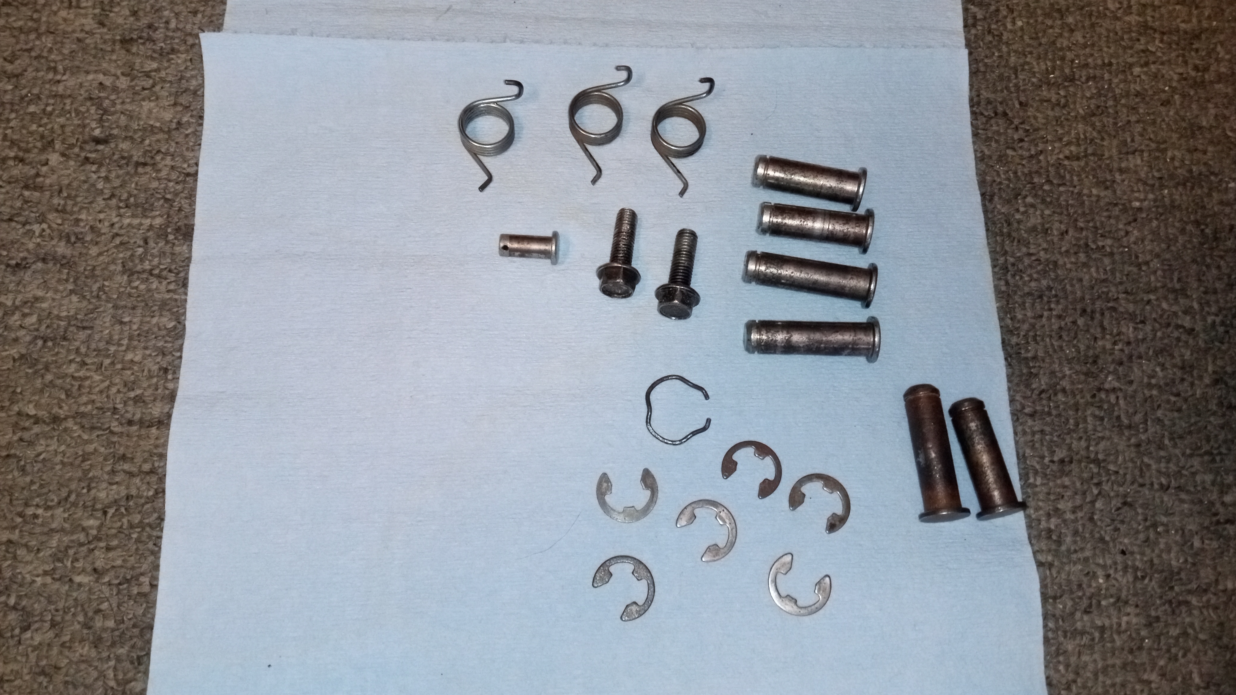

Tumbled the rusty rear brake lever pivot for a couple of hours, forgot to put a couple of springs in there, so they're in it now.

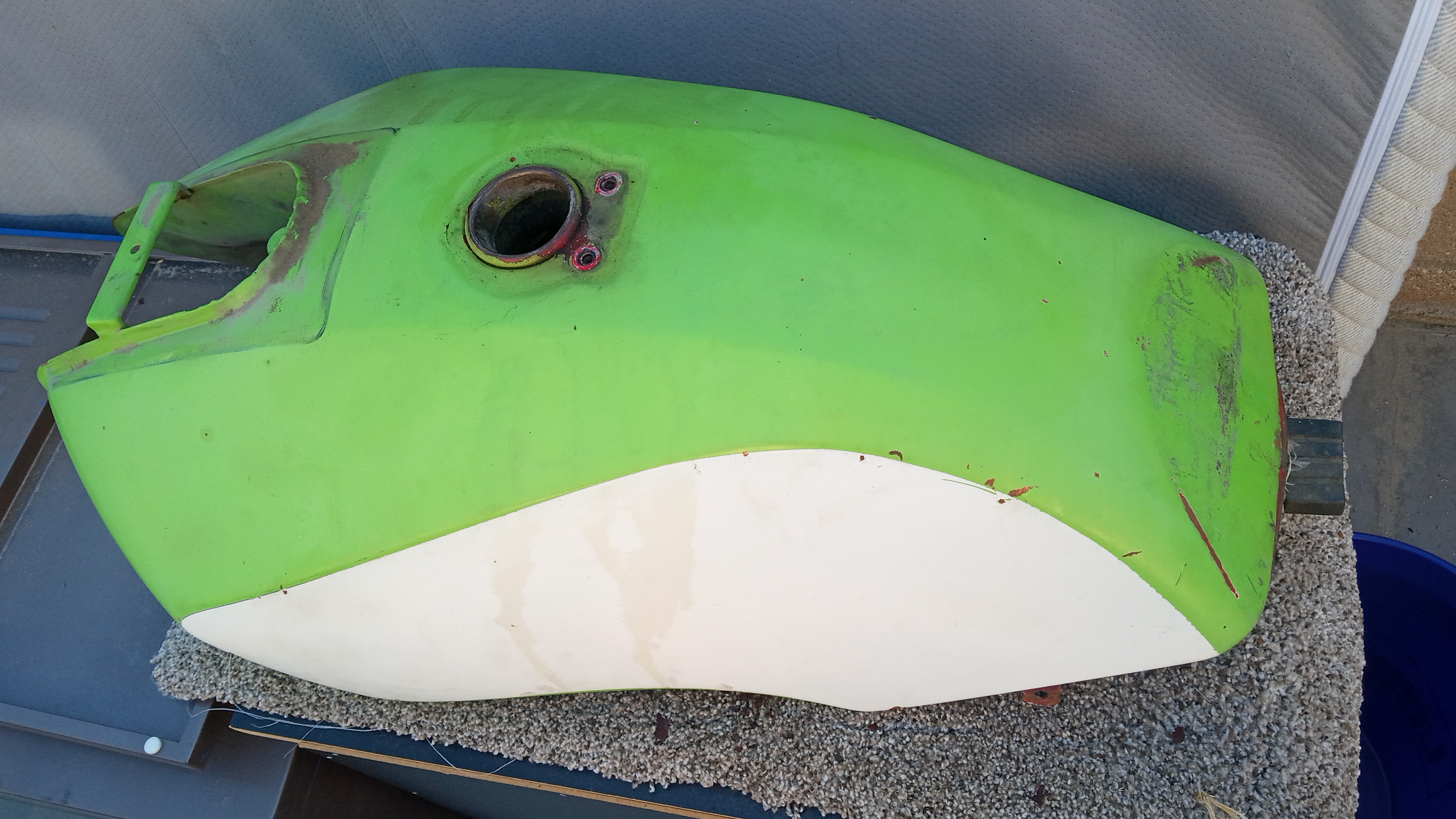

I think I could use what I drained from the tank as spar varnish. Tank is now sat in the Sun airing/drying out, already too hot to touch it (91deg today). That will be going to the local radiator shop to get boiled out. There's also a half-assed repair on the bottom/rear of the tank where someone attempted to fix a leak with fiberglass. They crack were the rear mount is attached to the tank (known issue). That will be getting removed & then fixed correctly with braze or TIG.. or TIG brazed...

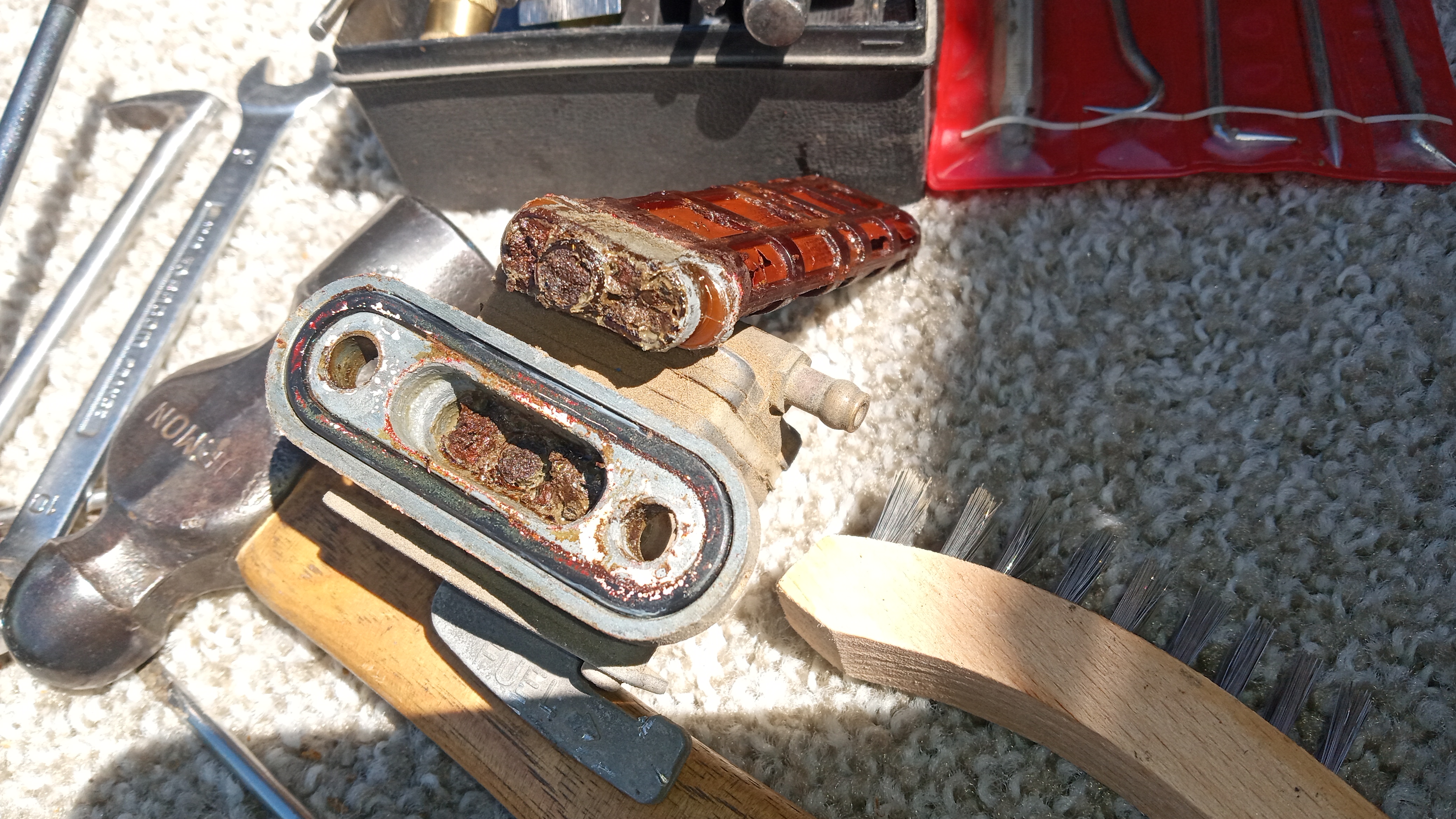

Excavated the fuel tap.... Jesus H Criminny... :wtf: :shock:

The two parts of the fuel tap are in the ultrasonic now...

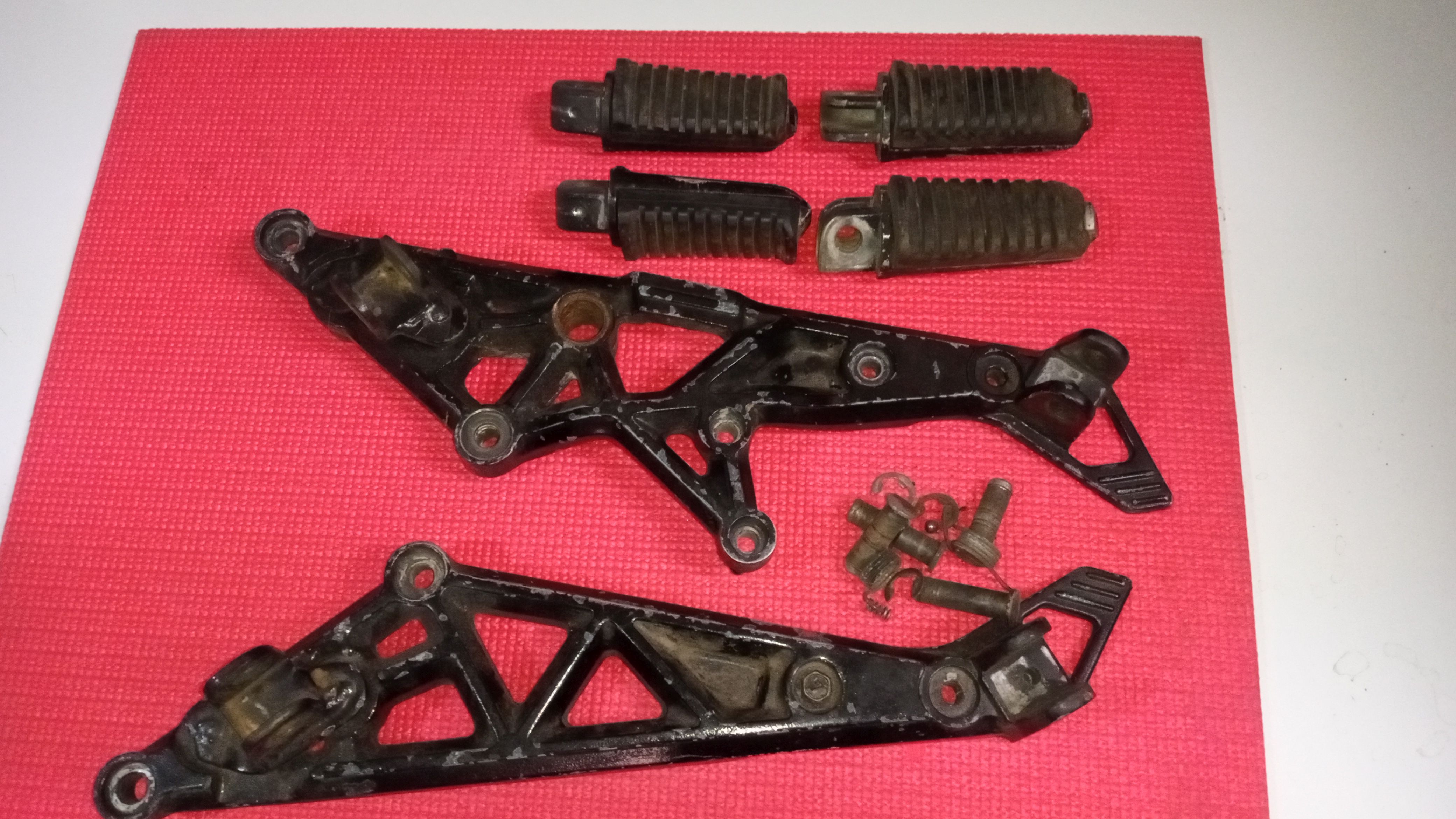

Santa/Postie showed up with peg mounts & pegs etc, these ones aren't all wollowed out like the originals. Well happy :)
Hardware is in the tumbler, mounts will go in the ultrasonic tomorrow for a quick clean up. Probably getting powdercoat instead of paint.

Ultrasonic turned the dry snarge in the fuel tap into clay.... Dug more out, will finished the job with the small soda gun tomorrow (not the soda cannon I bought last week for the carbs).

The inside is going to get pressure washed, then I'll remove the fiberglass bodge repair, braze/TIG the crack, then I'll fit blanking plates to the fuel tap hole & sender unit hole, then fill it with *something*
...which will be either vinegar, muriatic acid or evapo-rust.... :shhh: & see what the results are...
Plan A was the local radiator shop to get it boiled out, but they stopped offering that service owing to environazi's... the fuckers. :angry-cussingblack:

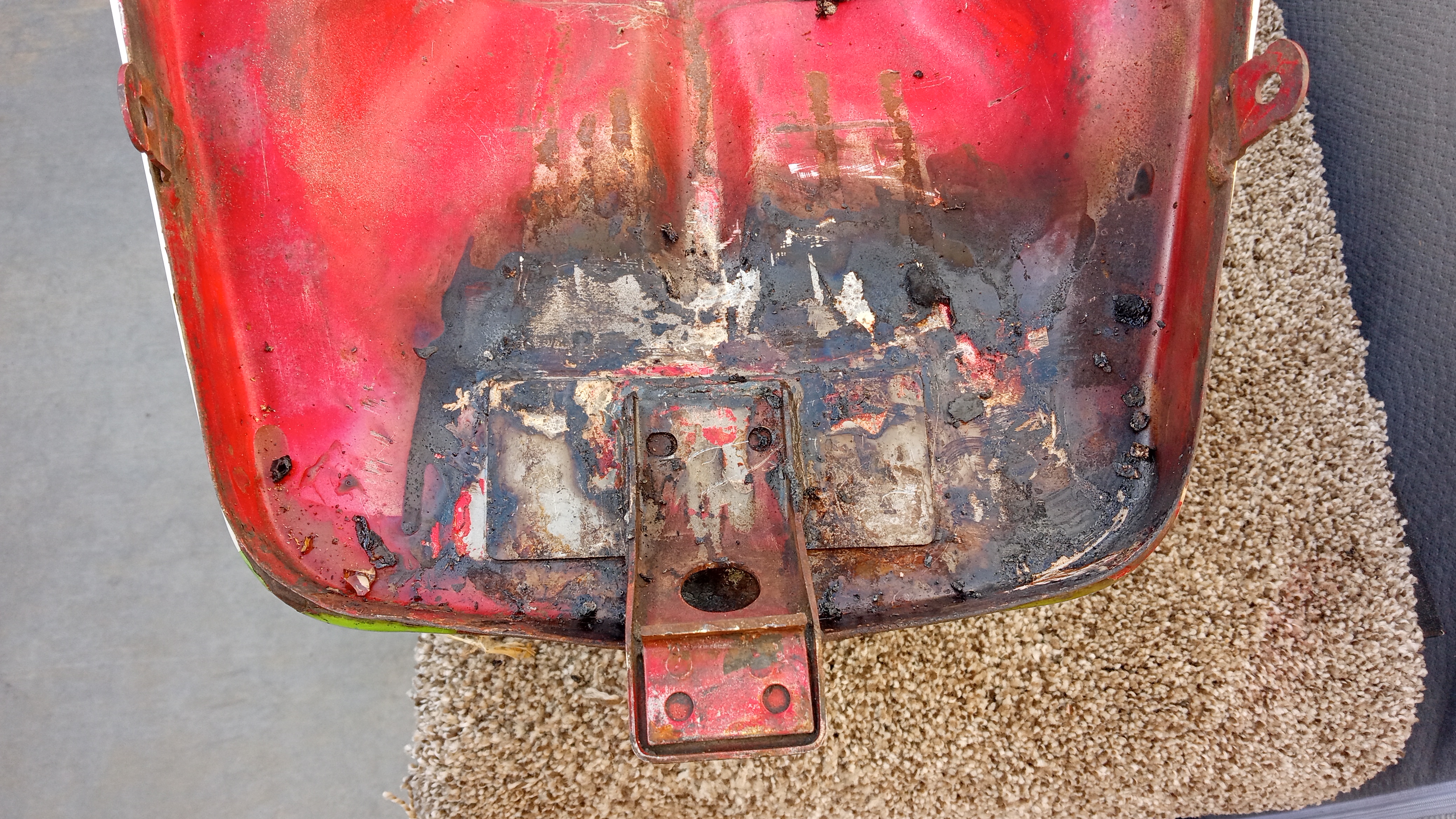

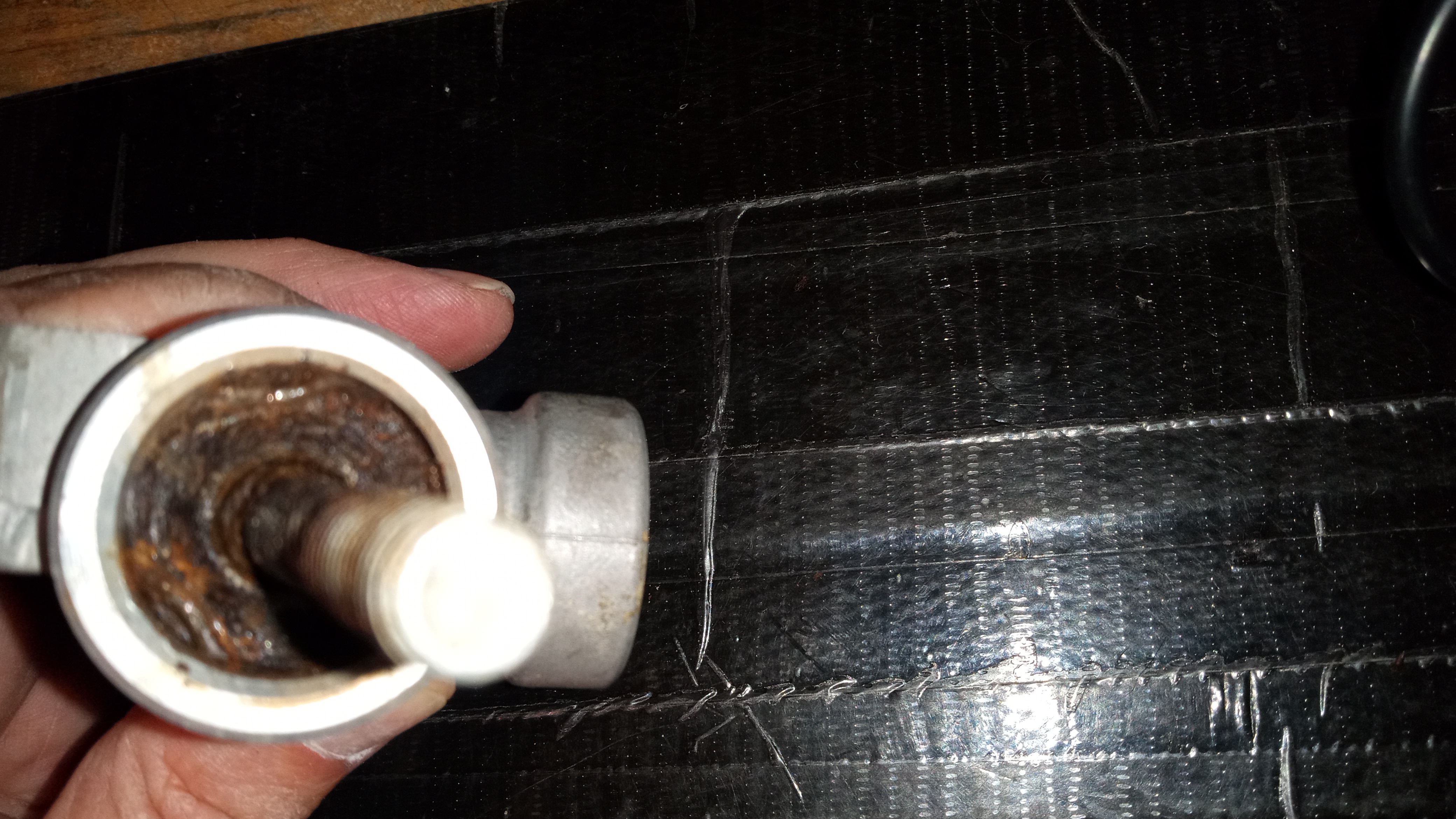

Removed the buggered fiberglass repair on the gastank. Decided that flame was the correct route... :think: Tank is now sitting there venting steam/smoke... Probably should have taken a *before* pic...
Inside the sender unit hole:

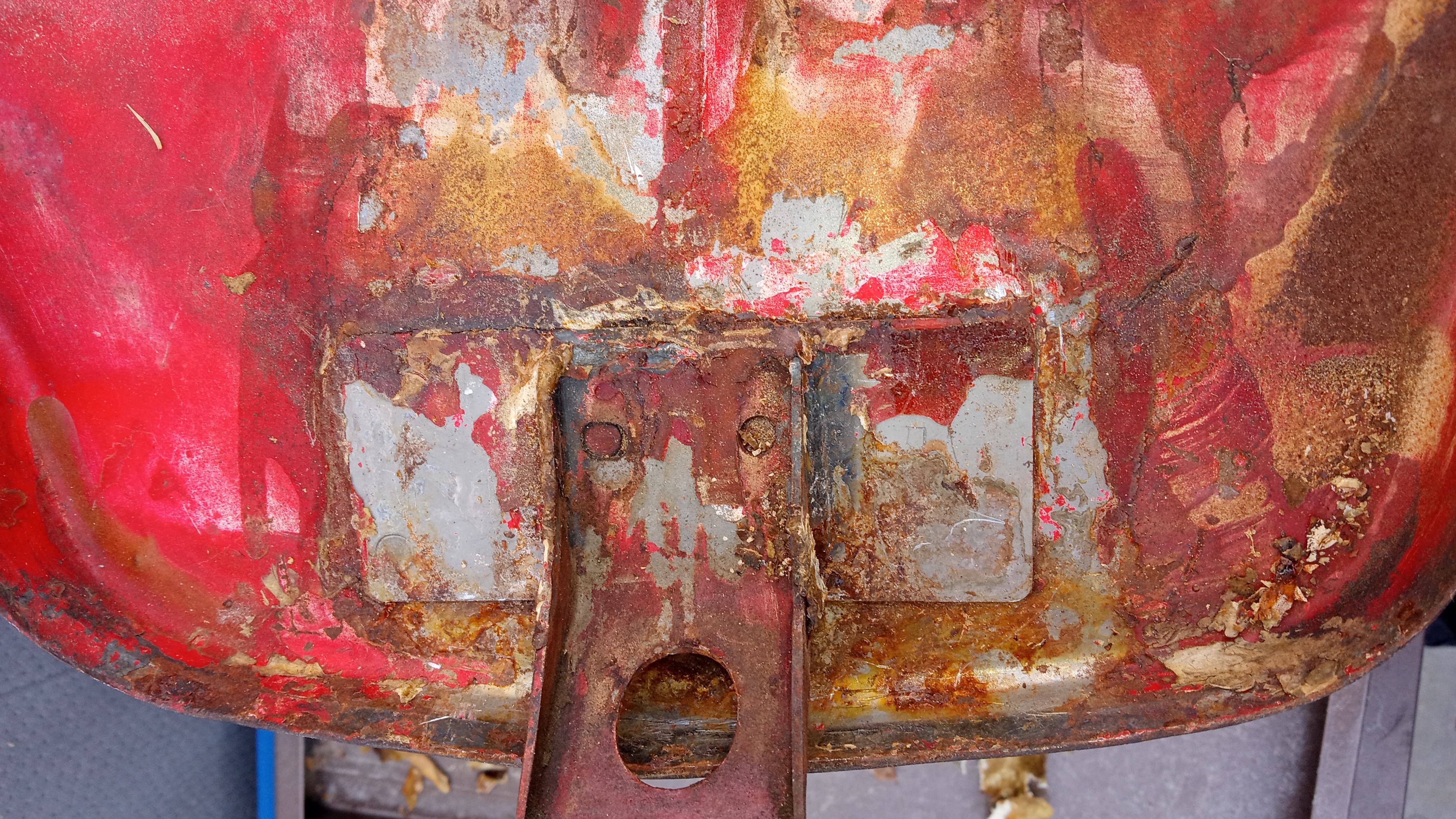

Re: '83 GPz750-A1 malarkey.
Posted: Wed Jun 03, 2026 4:22 pm
by ZRX61

He's also going to blast that burn area on the bottom of the gastank so it's ready for TIG or brazing.
