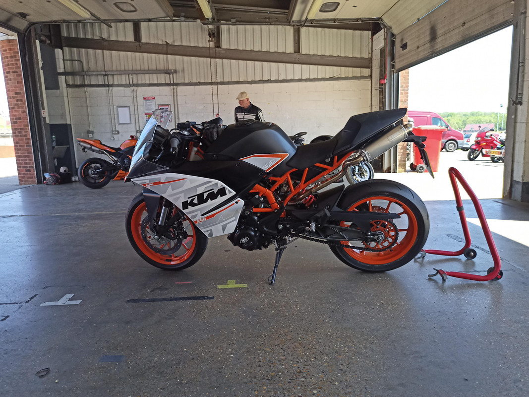

Spent a very enjoyable day at Brands yesterday with @2xtwins, the day itself was brilliant IMO and is probably worth a thread of it's own and maybe Kev will do one, but this one is about the 390 and how we got on.
It of course had a freshly rebuilt engine with a new Piston etc, I'd only finished getting it all back together the day before so running in consisted of approx 30 miles on the road where everything seemed good so it was loaded into the van and off we went.
I have to say that trackdays on a small bike this one really are brutal on the engines, it's not like a bigger bike where you can just take it a bit steady and change up earlier, etc for a session or two to give it an easy time- there is only one way to ride a bike with only 40hp and not completely mullered by everyone, especially in the fast group, and that is on the stop everywhere so that is what it had from the word go, and it was brilliant.
I'd geared it down a little (-1 off the front) after Lydden as I wasn't even using 6th there, and that proved about right for Brands- when I'd got a good run through McClarens/Clearways, it was just shy of the rev limiter in top at the end of the start-finish straight, indicating 102-103 mph just before shutting off
I'm not sure it's producing any more power than it did before (not that I expected it to), but I am very pleased to report that there is not a hint of oil smoke or smell, , the oil level didn't move a mm over the day, no funny noises or leaks and it's running spot on.

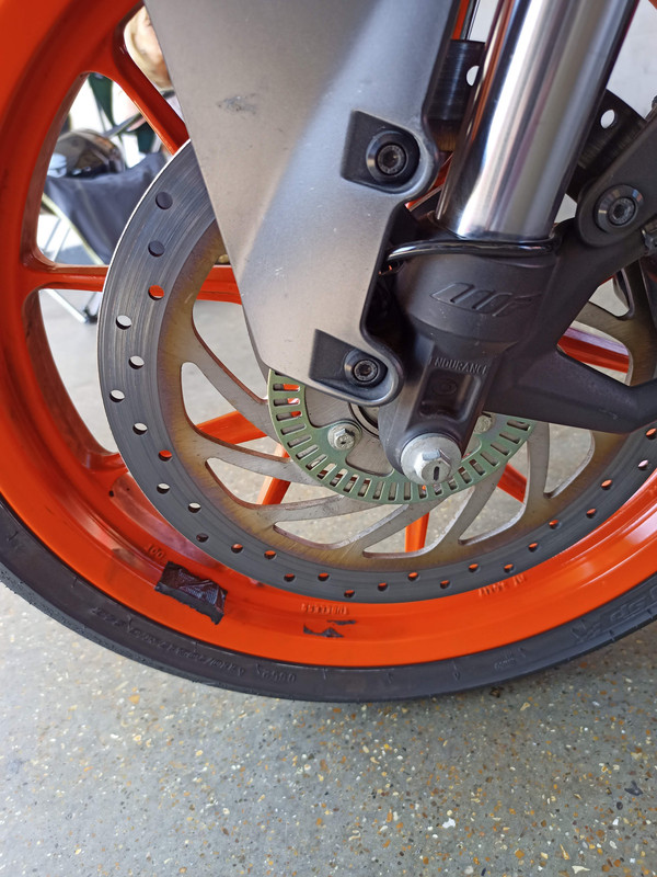

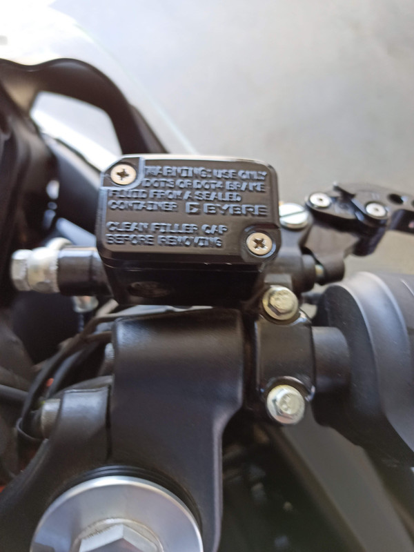

The only slight issue we had was with the front brake in one session- you only use the brakes twice a lap on the 390 (Druids and Graham Hill), but Druids particularly is full-on, and a combination of a tiny fluid reservoir filled to the top mark, race pads in a cheap shopping-bike caliper, and boggo DOT4 fluid meant that it got pretty hot one session and caused the front brake to stick on a bit.
I noticed coming out of Druids that it seemed sluggish and thought uh-oh, and throttled off slightly anticipating a seizure but there were no funny noises or smells so I continued through Graham Hill and it the motor was OK, but seeming down on power and struggling, only pulling 70ish MPH along the Cooper straight where normally I'd see approx 85 , and then when I shut off for McClaren's/Clearways, it dived and slowed so much the penny dropped- the front brake was dragging badly, so in I came- the disc was glowing and the brake lever had gone solid.
Once cooled down all was back to normal, but I removed a few cc of fluid from the reservoir, and took the caliper off, and gave it and the pads a check-over and clean-up, and all seems good now but it's going to get a change to some Motul 660 and I'll keep an eye on things- hoping that I won't have to revert to standard pads as the Bendix MFs really are the business in terms of stopping power improvement on this bike.
Next outing just under 2 weeks time at Donington on 14th, and Cadwell the day after - if we have the same sort of weather and as smooth running days as we did yesterday it'll be perfect- Scorchio!
Anyway, a couple of pics from yesterday, not particularly exciting ones, but I know we all love them anyway :D

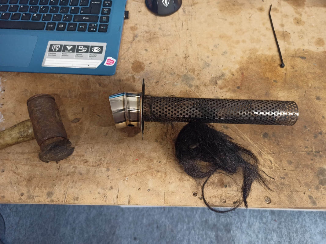

It's just sat in a corner of the garage since then, so this weekend I thought I'd better dig it out and give it a once over and treat it to some fresh oil before it's Pembrey outing later this week.

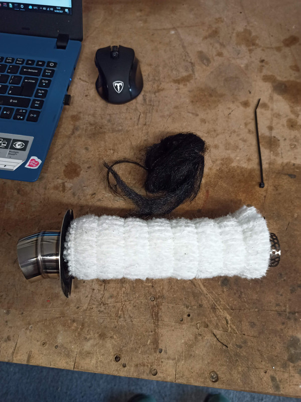

I also thought ( particularly in light of Alan's recent Pembrey email ) that I'd see if I could quieten the Tyga system down a bit- whilst it's not failed a noise test anywhere yet (and Donington was a quiet day), it isn't what I'd call quiet, so I thought I'd re-pack the cans, but before I did I downloaded some free sound meter app to try and assess the success of my work.

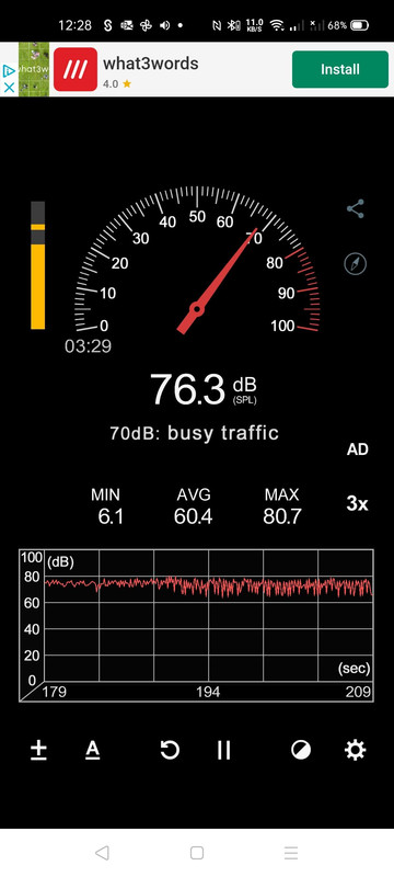

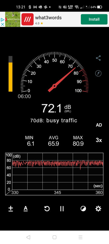

This was what I got after I'd warmed it through- it's not that meaningful TBH as it was on tick-over, simply as I was by myself in the garage and my arms weren't long enough to operate the throttle whilst holding the phone near the end-can outlets, but its a reference point, perhaps :D
THe stuff that was in there was wire wool, and there wasn't much of it so I was quite hopeful that my new, quality packing ( supplied by Pipewerx- it's the stuff that expands when hot, supposedly) would make it noticeably quieter
Didn't seem to make any measurable difference really though either to my ear or the app , but at least I know it's pretty much as quiet as it can be
