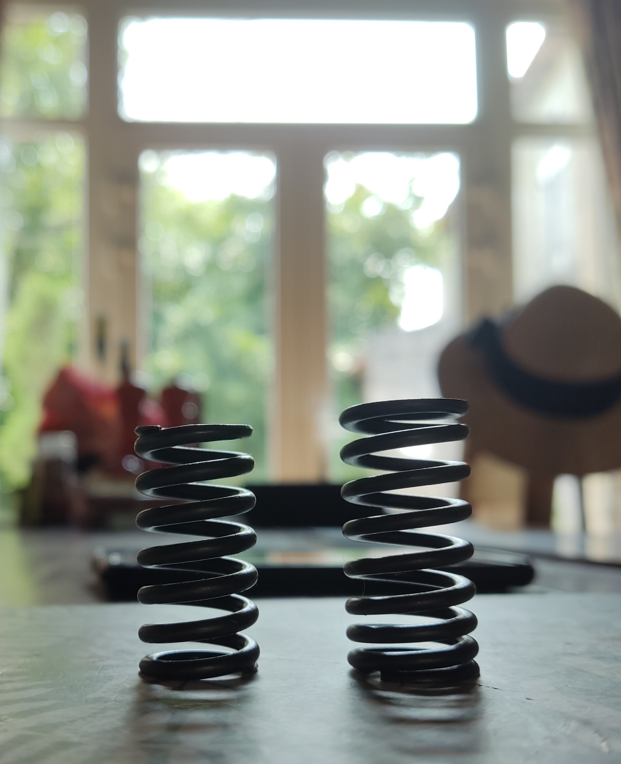

Just started rebuilding this lads Duke. Get the new valve spring out of the packet, hmmmm!!!! Not sitting in the bottom seat.
Drop the other inlet valve as I was changing that as a precaution, sits fine in the bottom seat, both sides.
A quick visual inspection reveals different lengths, and not by a wee bit either!
Measure the diameter on a Vernier, old spring drops through new spring dia!

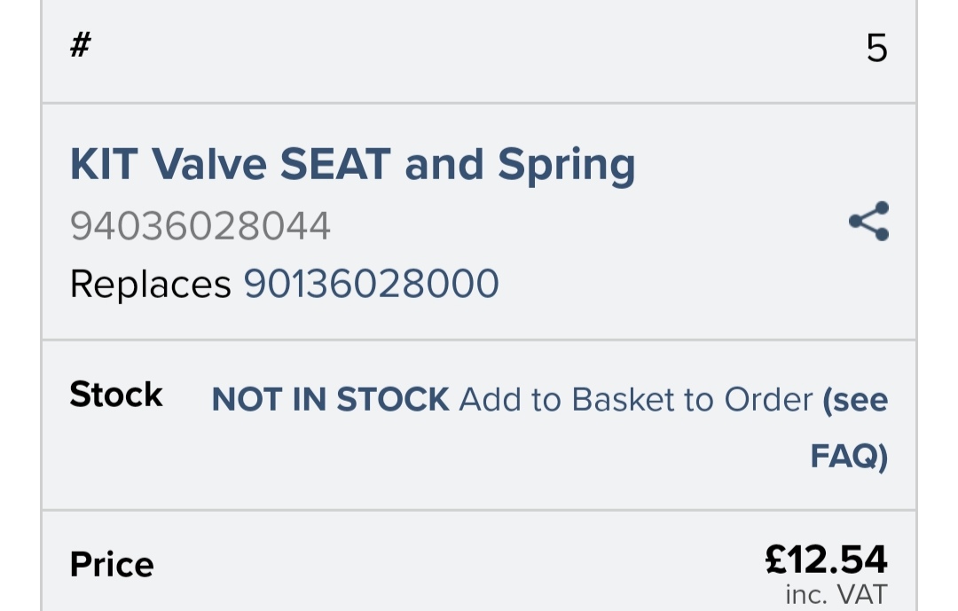

Ok, off to the fowler's website, 2021 bike, yep, that's the part number KTM have listed.
I wonder if it's an older motor with new clothes.
Check the 20MY, valve spring has been superceded by new part, which they haven't put on the 21MY fiche. Cnuts
