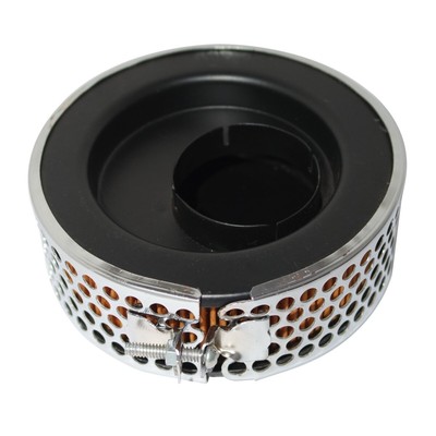

The authentic-looking air filters on late 1960s Triumph and BSA 650s are these and they are restrictive too, with a paper element.
They also develop cracks from vibration and fall to bits.
