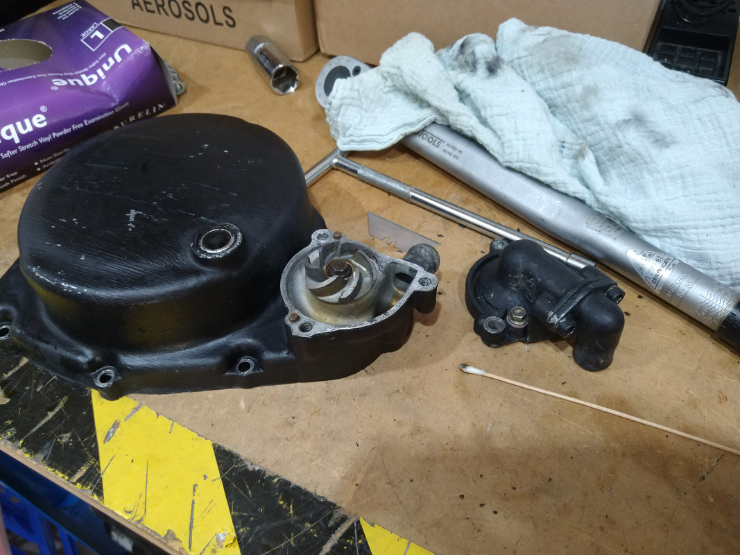

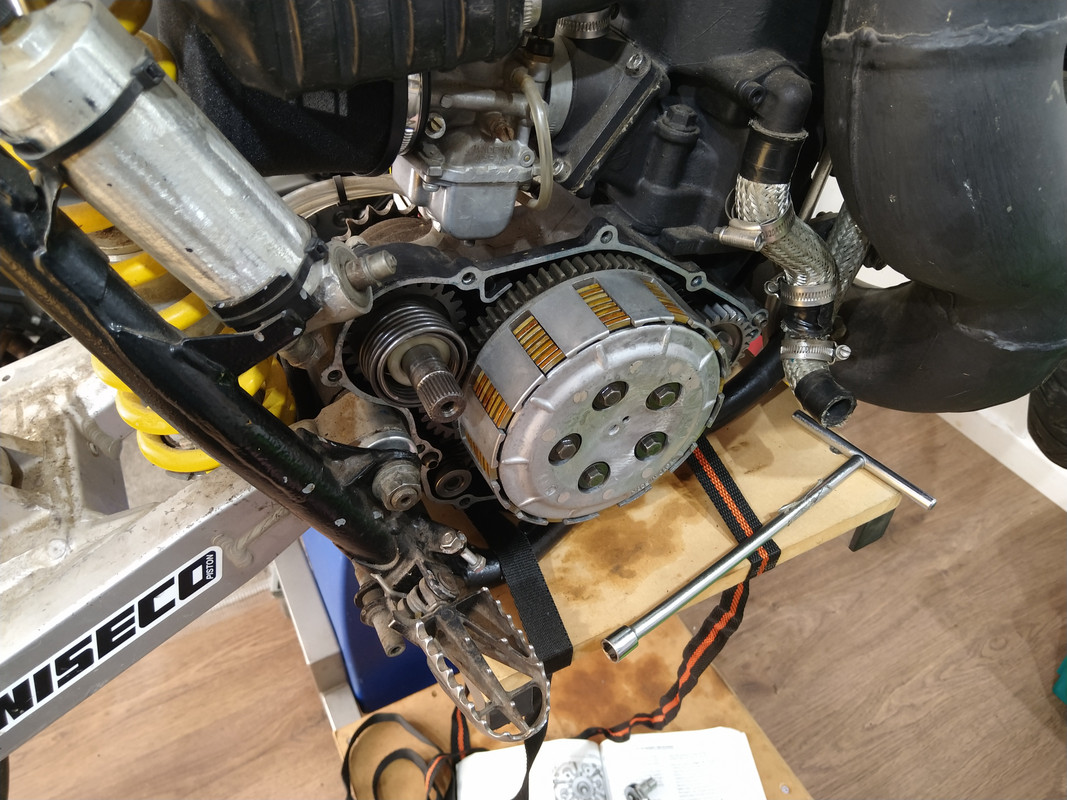

New clutch assembly fitted and torqued up. Cleaned up the mating surfaces and ordered a gasket set.

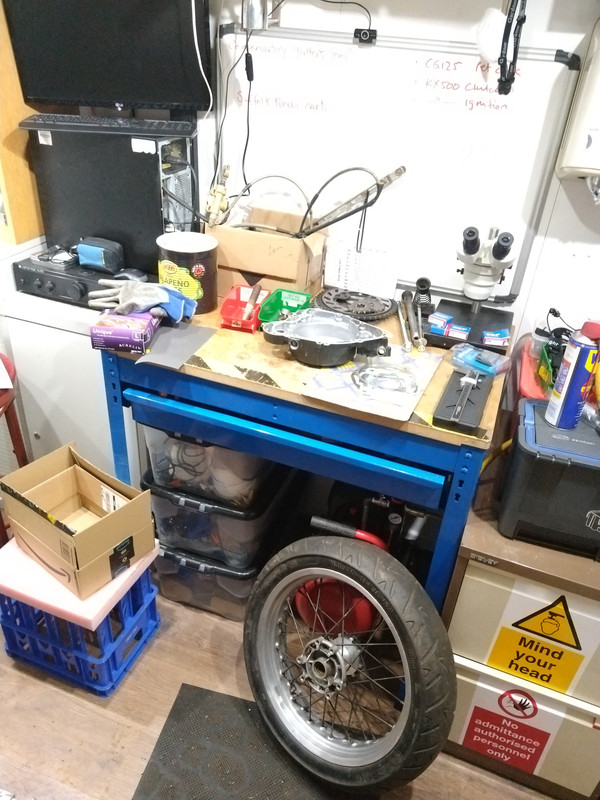

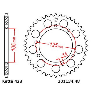

So it was a good guess that it was a European 125 motard the wheels came off, turns out they are common on a range of bikes - Peugeot XPS125, Motorhispania Arena and Duna 125, Derbi Sanda and a couple of others. I managed to find the dims for the sprocket to get a 520 one machined up and Cheb has kindly offered to knock up some top hats for the axle sliders to allow me to fit a 15mm axle and work out the alignment for the chain and brake hanger and get the dimensions for the required spacers so I'll be using the wheel.
Gasket set is in the post. When that arrives the next steps are gearbox oil, coolant, reconnecting the wiring for the coil/CDI/kill switch and checking the points gap...and trying to get a spark. Oh, and I've ordered some 10mm ally plate for the front brake adaptor, cardboard template first of course.

It's narrow, 130 rear section tyre.

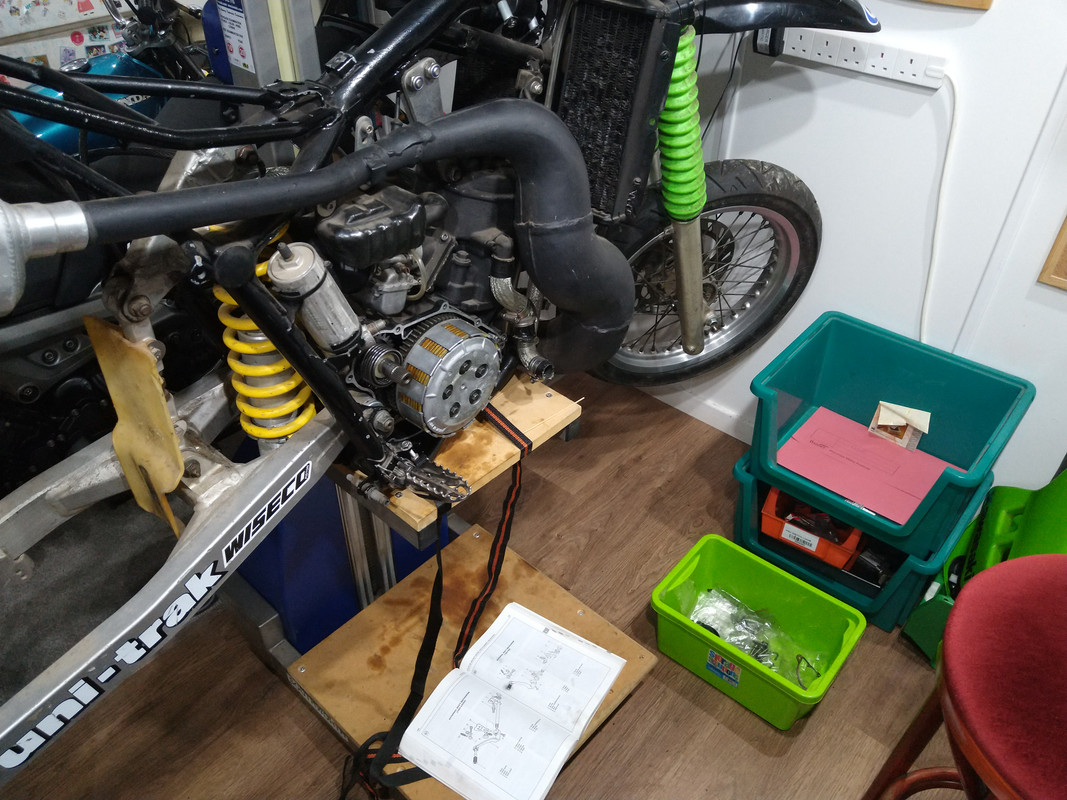

Gasket set and wheel bearings arrived. I've had too many beers to be fucking about in the workshop tonight though.
Bolt it back up and get some gearbox oil in it tomorrow.

Fluids going in now...

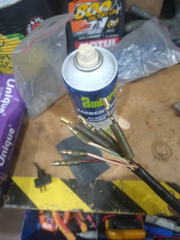

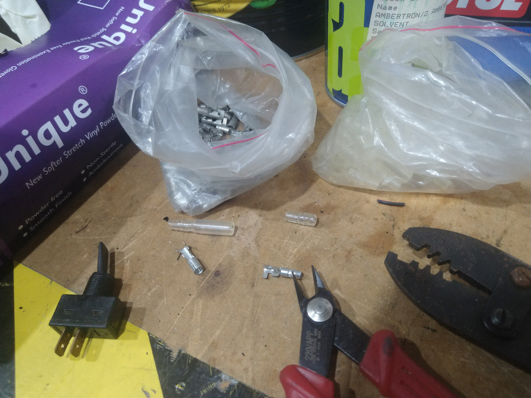

Cleaned up the old connectors and used new jap spec m/c ones on the stator leads. Put a temp kill switch in there too.
