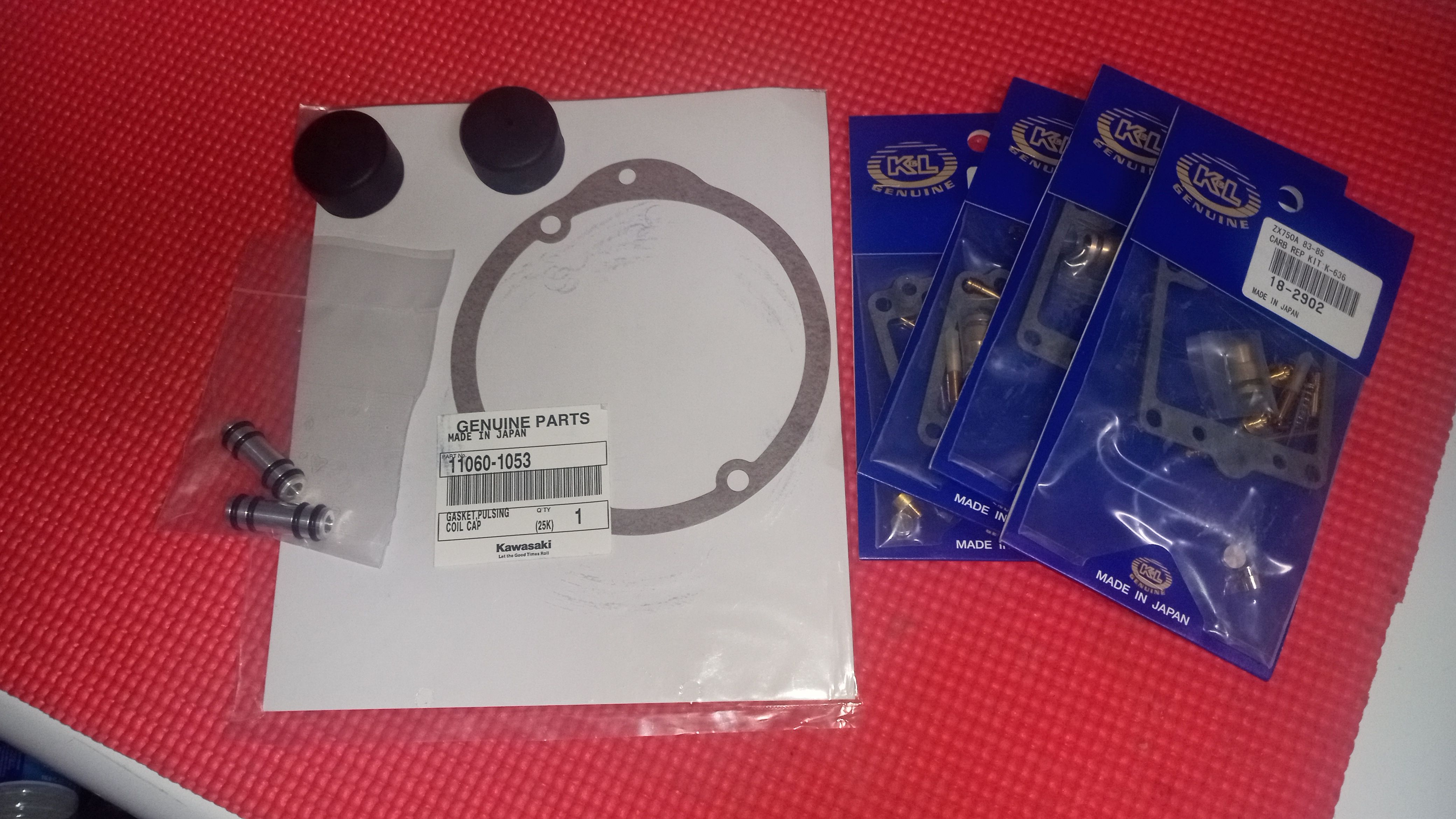

More gubbins arrived...

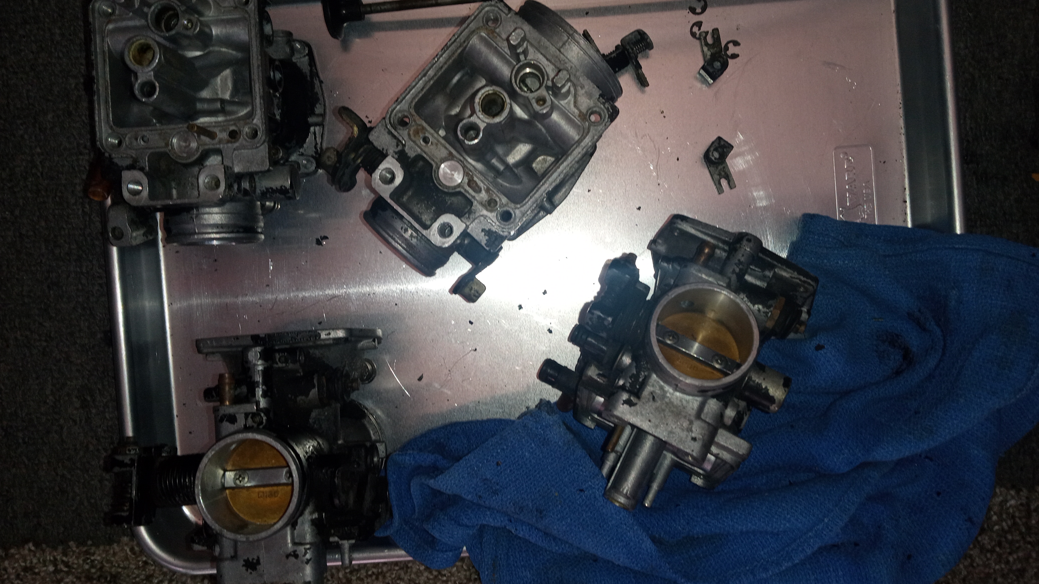

Scored another set of carbs for parts from a mate for $20 + shipping, same guy who sold me the clocks for $25.

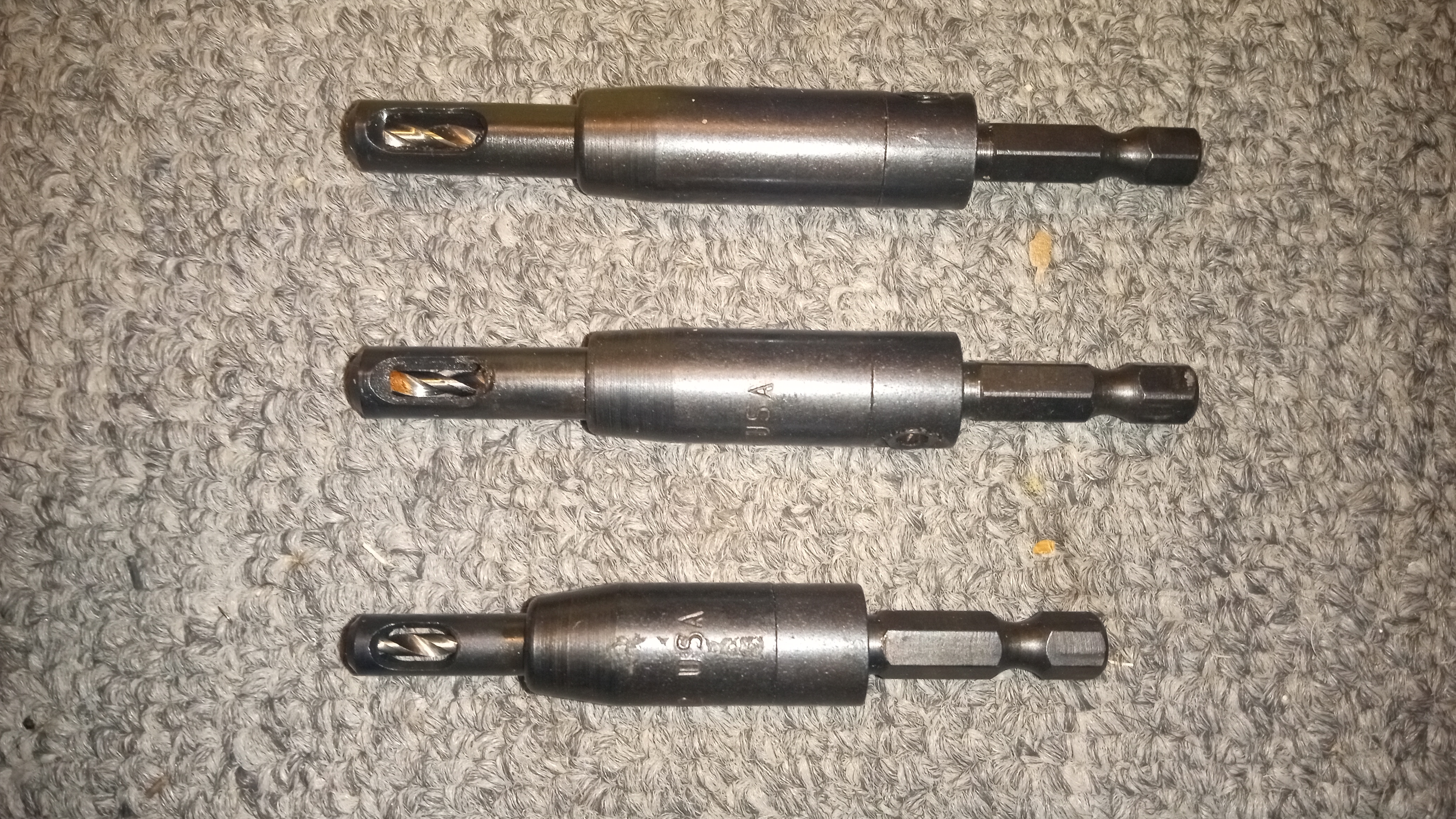

Also dug out my tin of weird drill bits... it has tapered bits for wood screws....
and also these three bits which have a spring-loaded doodad that centers the bit when drilling pilot holes for door hinge screws...
The smaller one is the perfect size & depth for drilling into that buggered air screw on the #1 carb, & I deployed the screw extractors for use after I put a hole right in the middle of the air screw.

All set to drill out that buggered air screw now. Got the drill bit shown in the previous post & three different types* of extractor... NONE of which are those fucking E-Z Out mongfoolery. :)

Started with the self-centering hinge drill doodad to get the hole started, went up to a slightly larger bit & went to town (notice the brass swarf), Then put the Rennsteig in the hole, seated it with a couple of light hammer taps & then just unscrewed the jet. 8-) 8-)

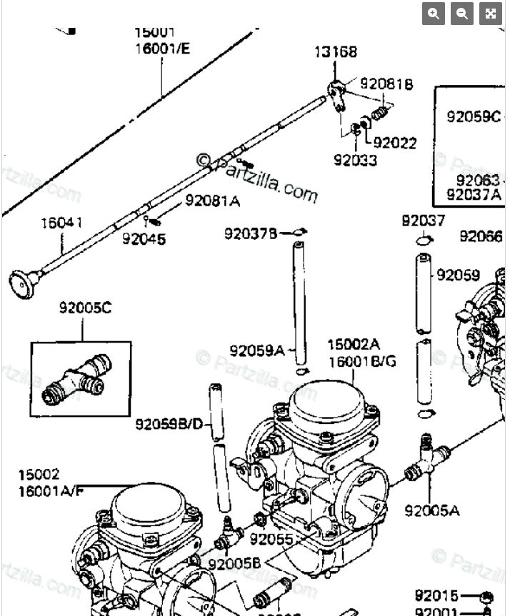

FINALLY got the carbs separated. Issue was the choke rod which most online posts state "remove the screws & slide the rod out"... :eh:
Problem:
It doesn't have any fucking screws :angry-cussingblack:
Solution:
Found a post on KZRider from over a decade ago that mentioned Ping!FuckIts! & even listed the part # (92033-1066) Looked up the parts diagram & found the buggers. :thumbup:
Choke Rod.JPG (115 KiB) Viewed 1943 times
& once I popped those buggers off I could separate the carbs.

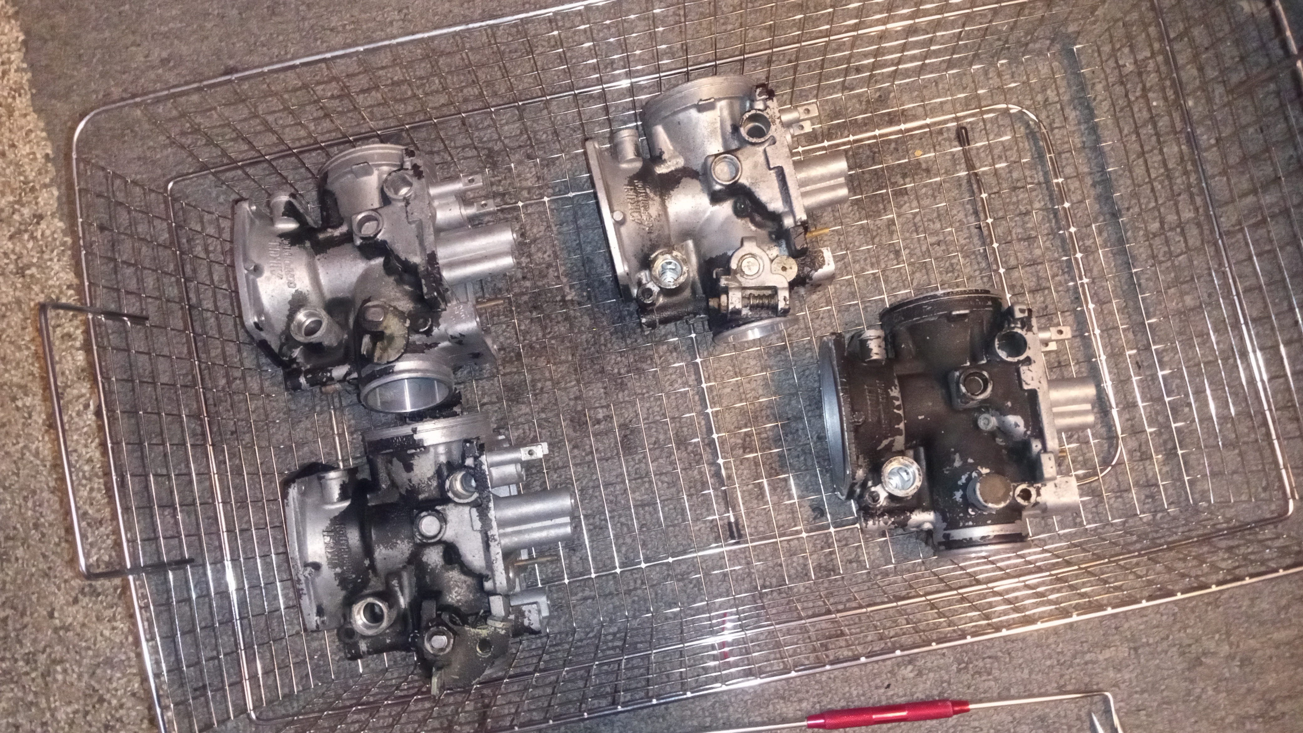

Re: '83 GPz750-A1 malarkey.
Posted: Mon May 25, 2026 7:39 pm
by ZRX61

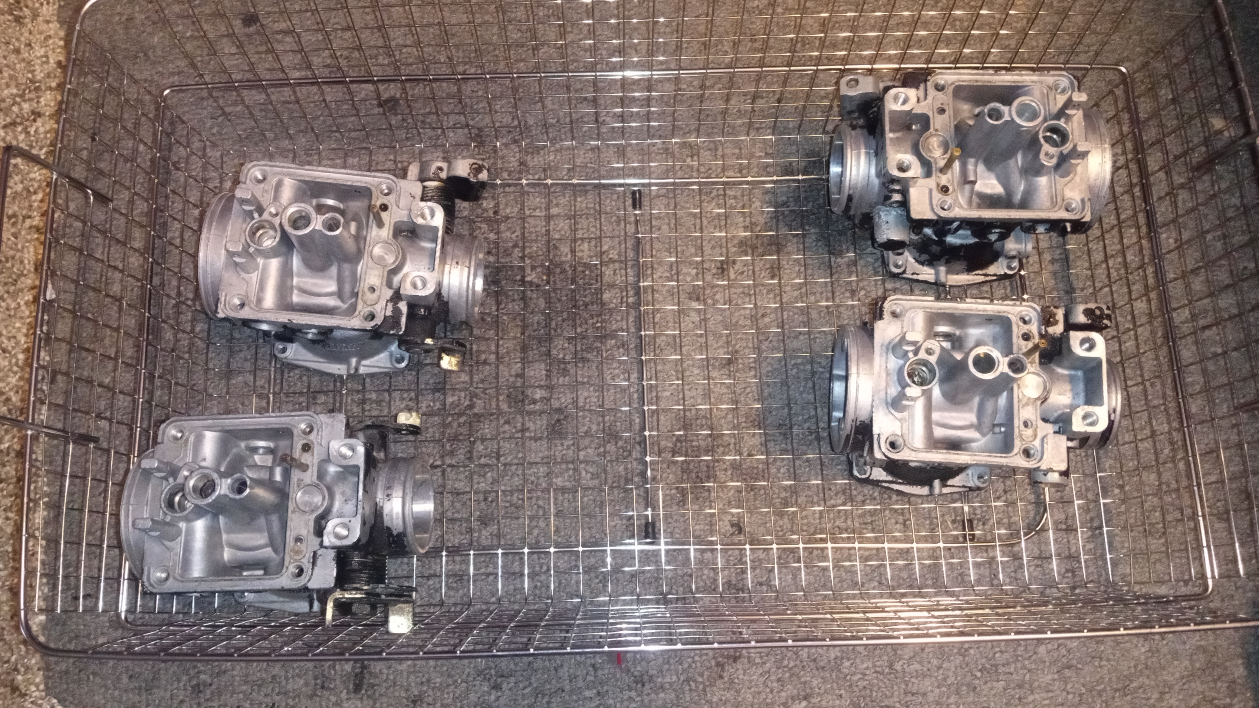

Choke plungers removed, carb bodies back in the ultrasonic.
Posted: Mon May 25, 2026 8:25 pm
by ZRX61
...and back out again after an hour. Even managed to get the balls (# 92045)& springs (#22081-A) out of the two carbs that position the choke rod. Balls came out in the tank, springs removed after with a sharp pointy thing (scribe, for you technical types).

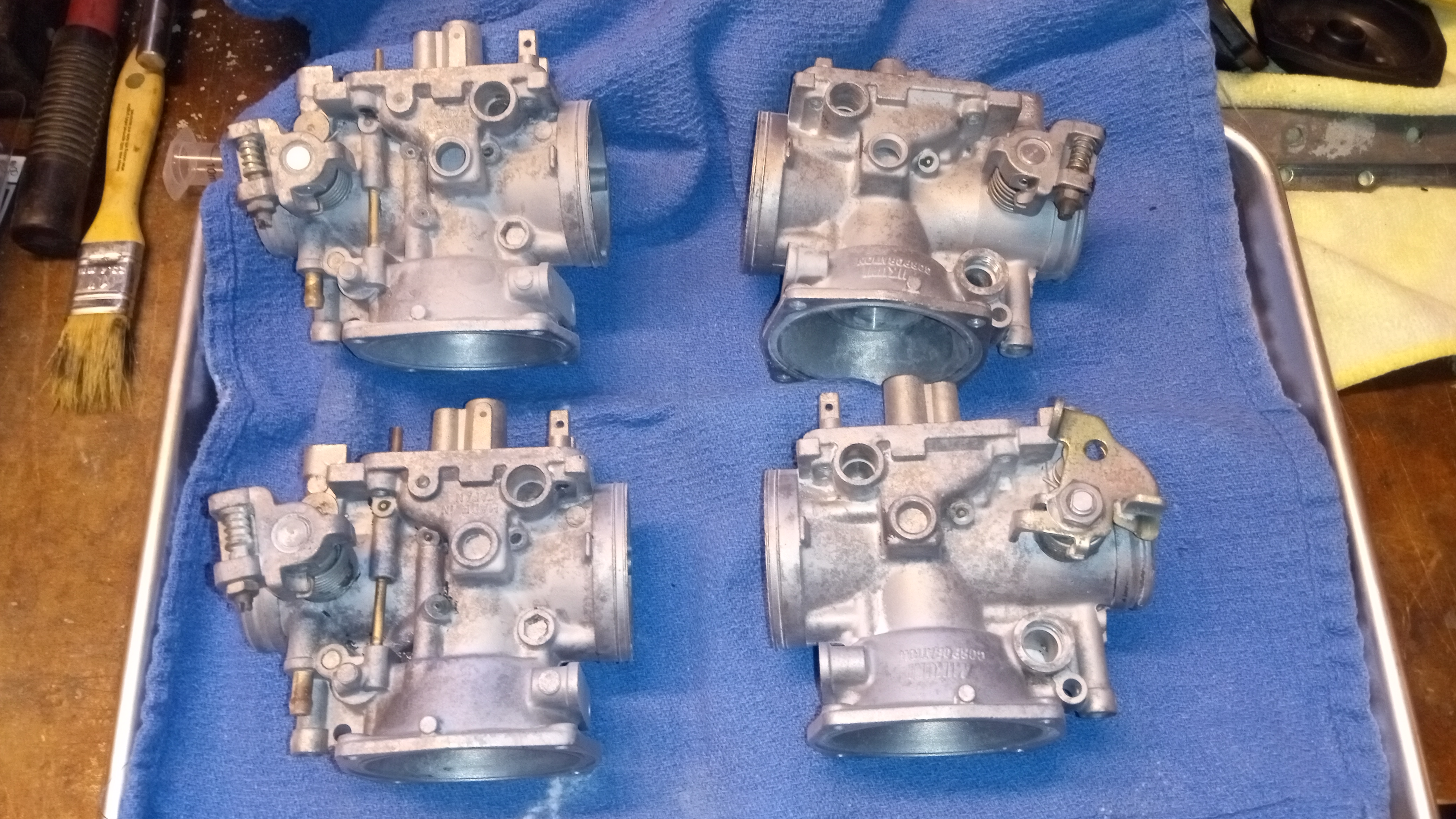

Fired up the soda blaster in the driveway & knocked the paint off the carbs. :thumbup:
JHC!!! It looked like a scene from Scarface be the time I was done. Barely used any soda, but the mess was epic :shock:
Got done with that & put everything away, hosed off the driveway etc.. & just when I finished the other set of carbs showed up from Texas. :roll: I thought I was getting a partially stripped set, but they're complete :banana-dance:
So the Saturday plan is original carb bodies back in the ultrasonic & pull a couple of parts off the spare set.

More gubbins showed up...

Soda'd carbs.
