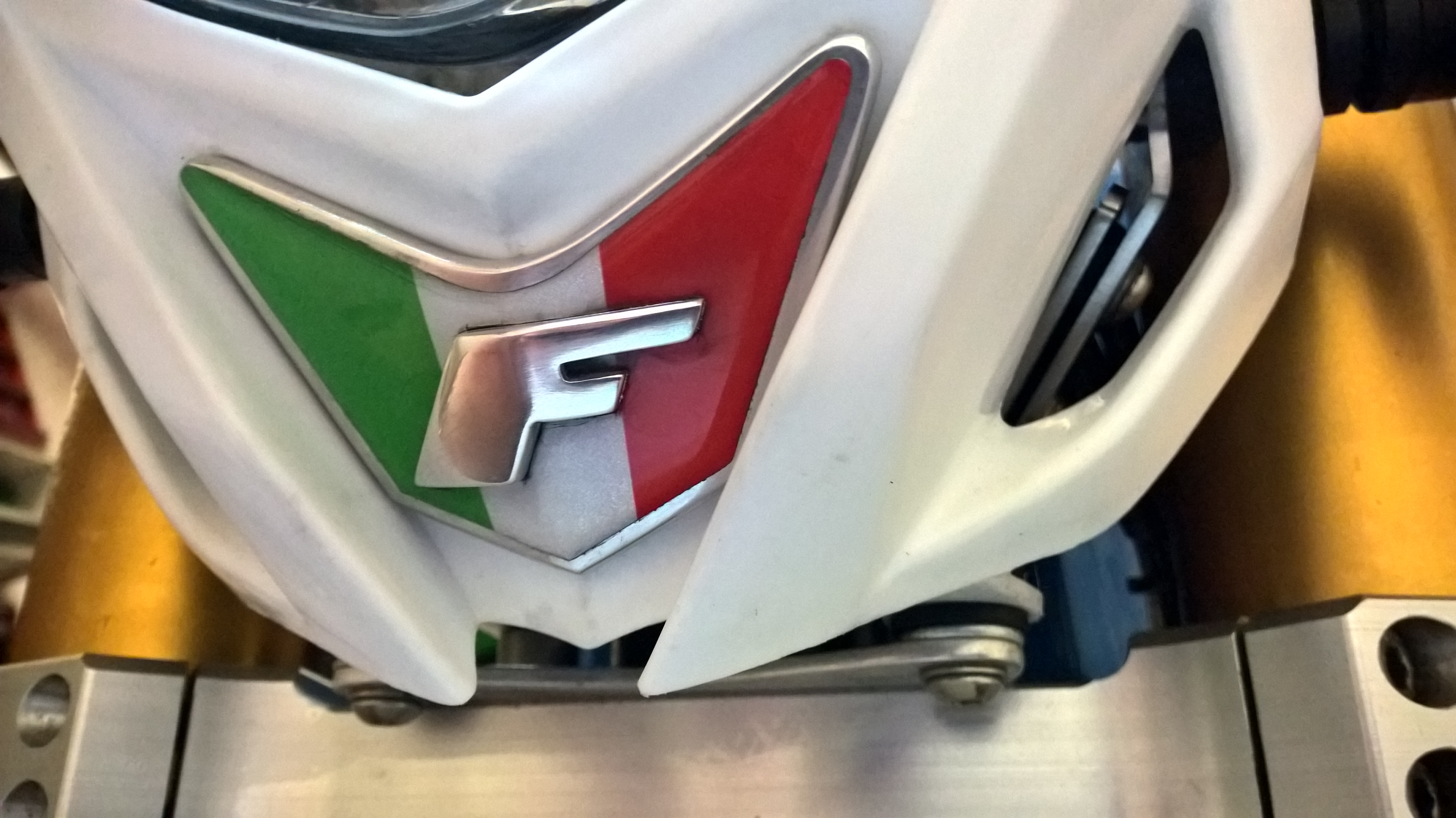

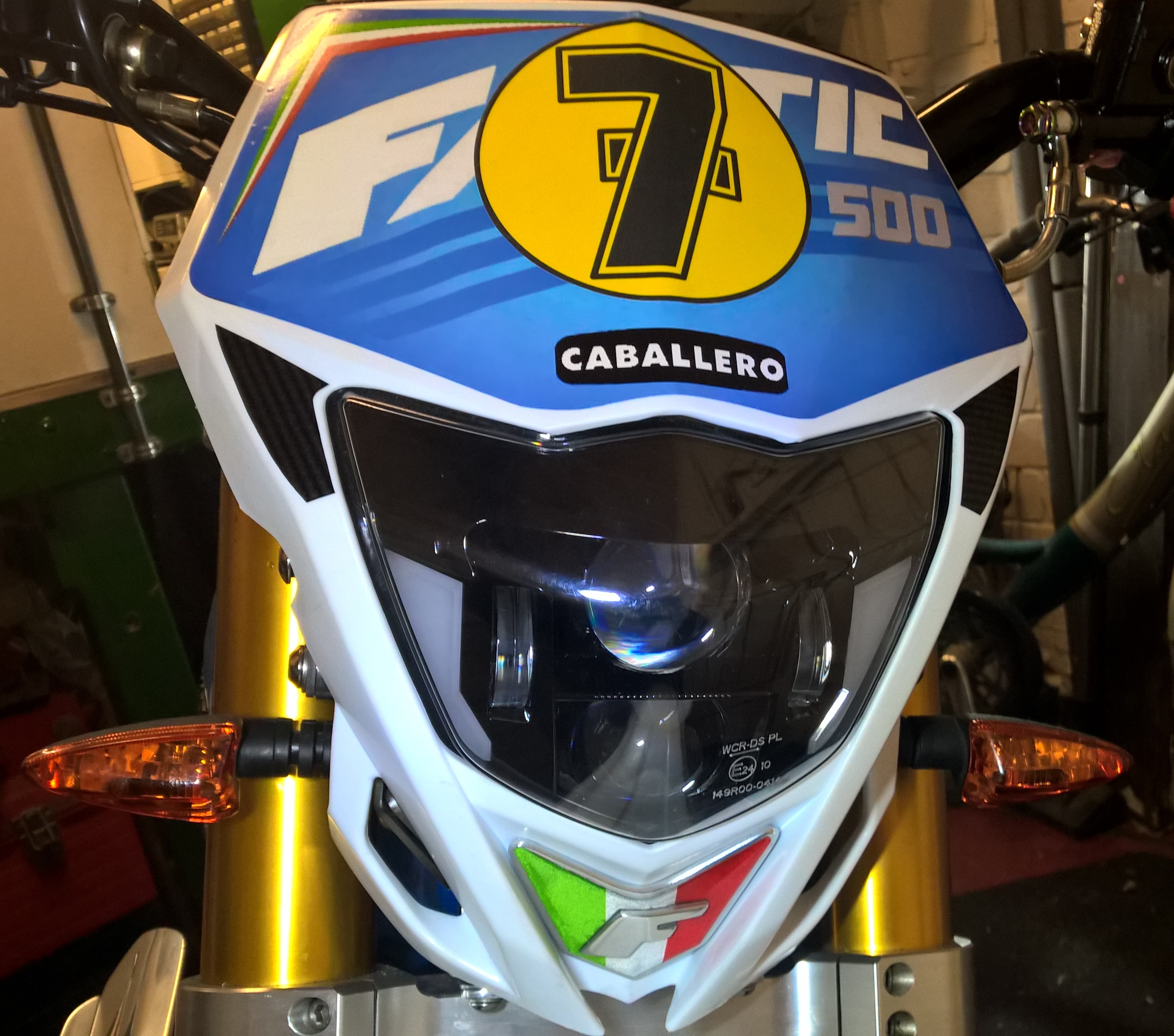

Another JB snippet!. This time it's a Fantic badge fitted to headlight mask below the headlight. It's a piece of ally shaped and bent, 2 M5 csk fixing screws were then stuck in place with JB. An Italian flag sticker was then stuck down and a 'F' cut out to suit the 'F' fantic logo cut from a small piece of ally which was then stuck in place with JB.

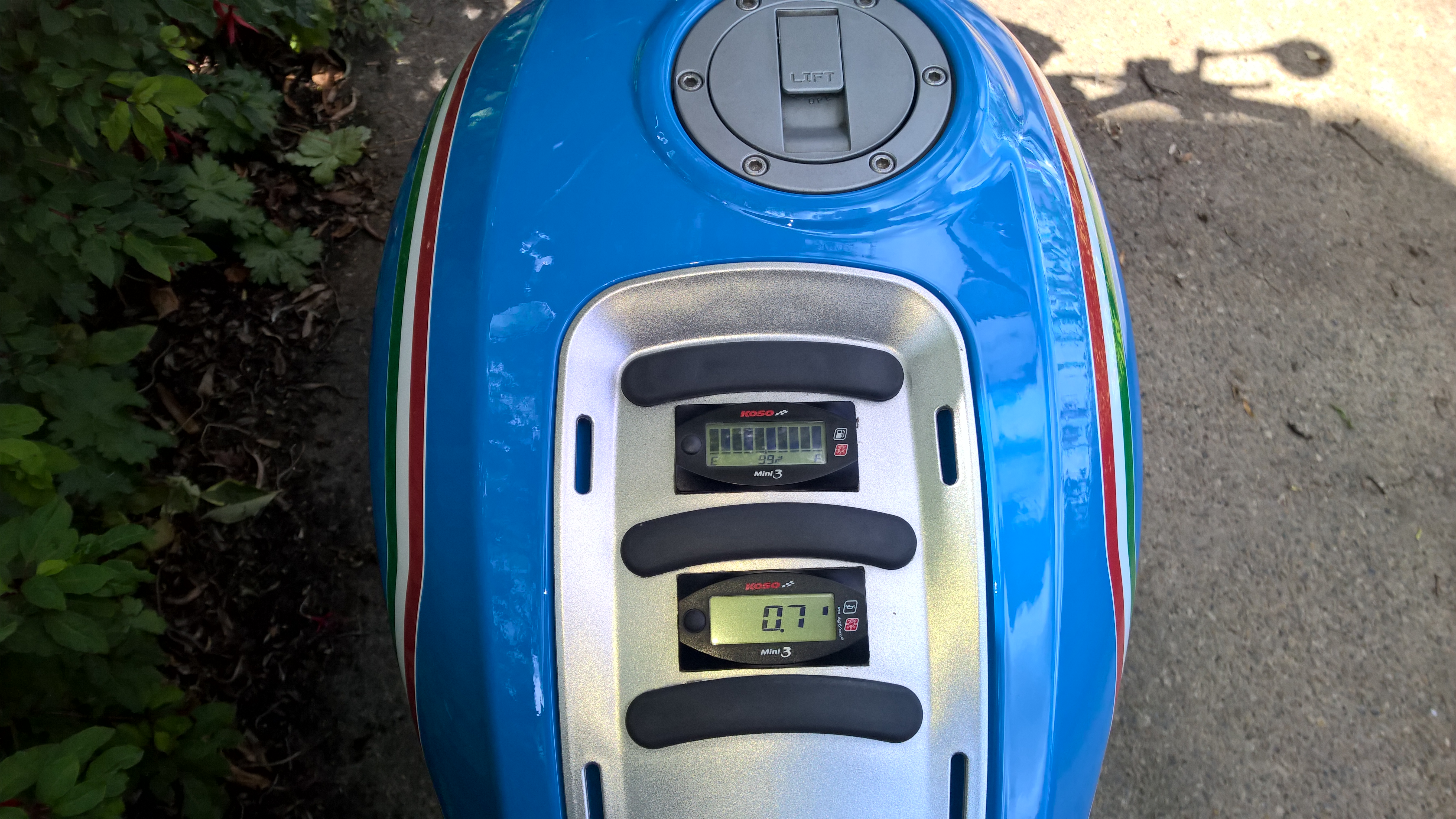

Koso fuel and oil pressure gauges stuck in place with JB. Don't worry haven't got many more examples of JB left!

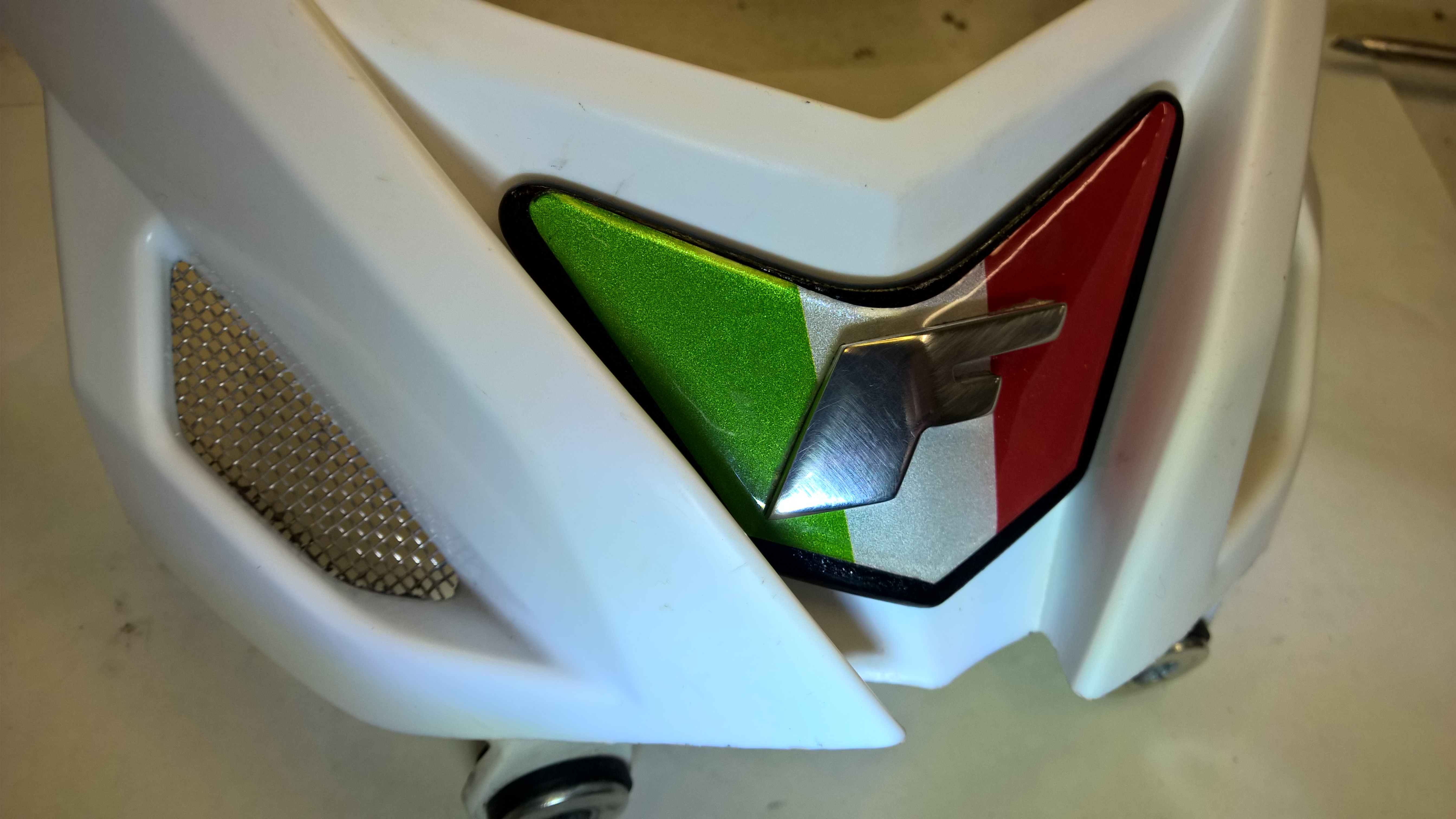

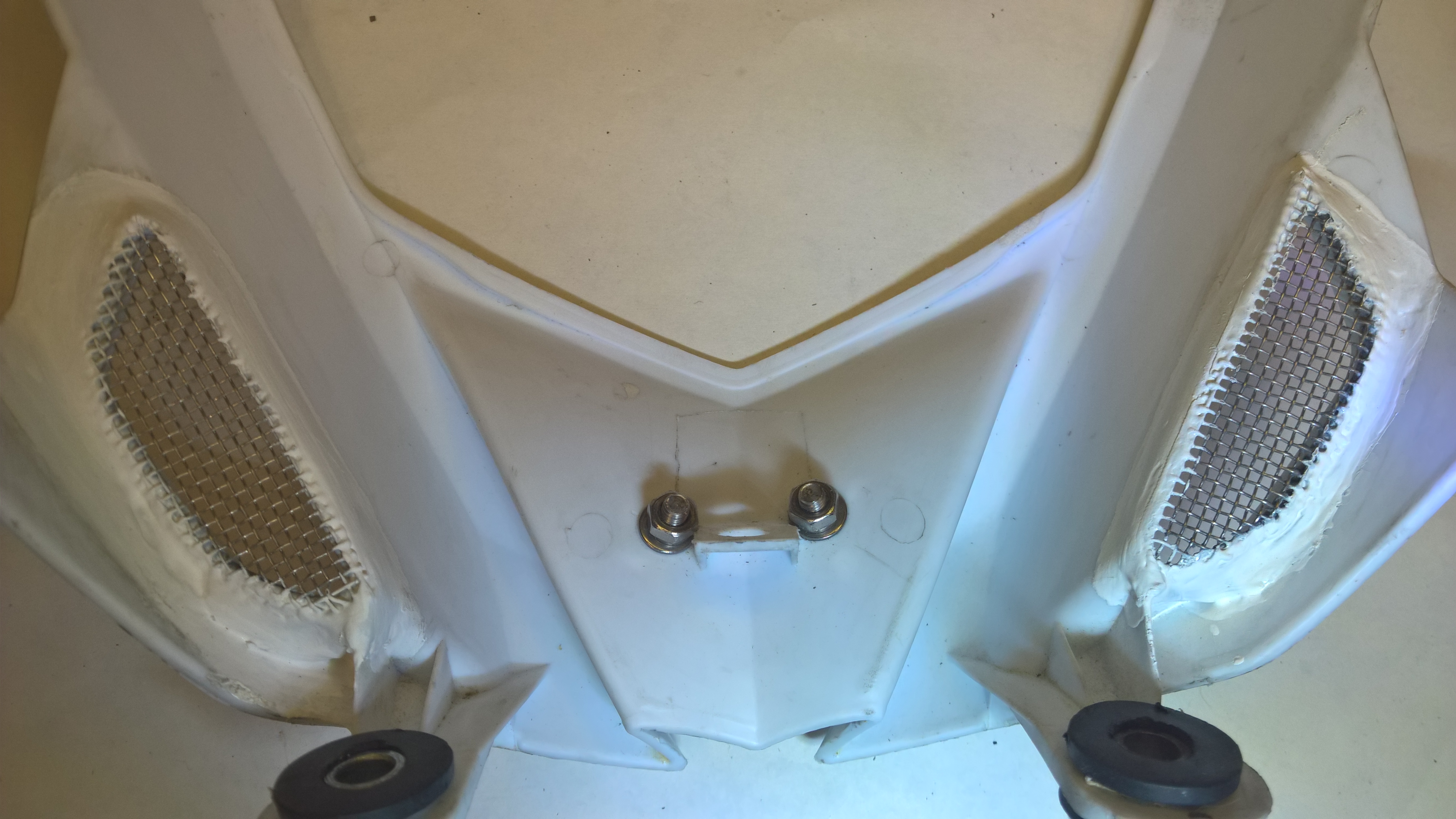

Just fixed some mesh behind the headlight mask cut outs with JB just to make them look a bit more purposeful!. The grey JB has been painted white just to try and disguise it.

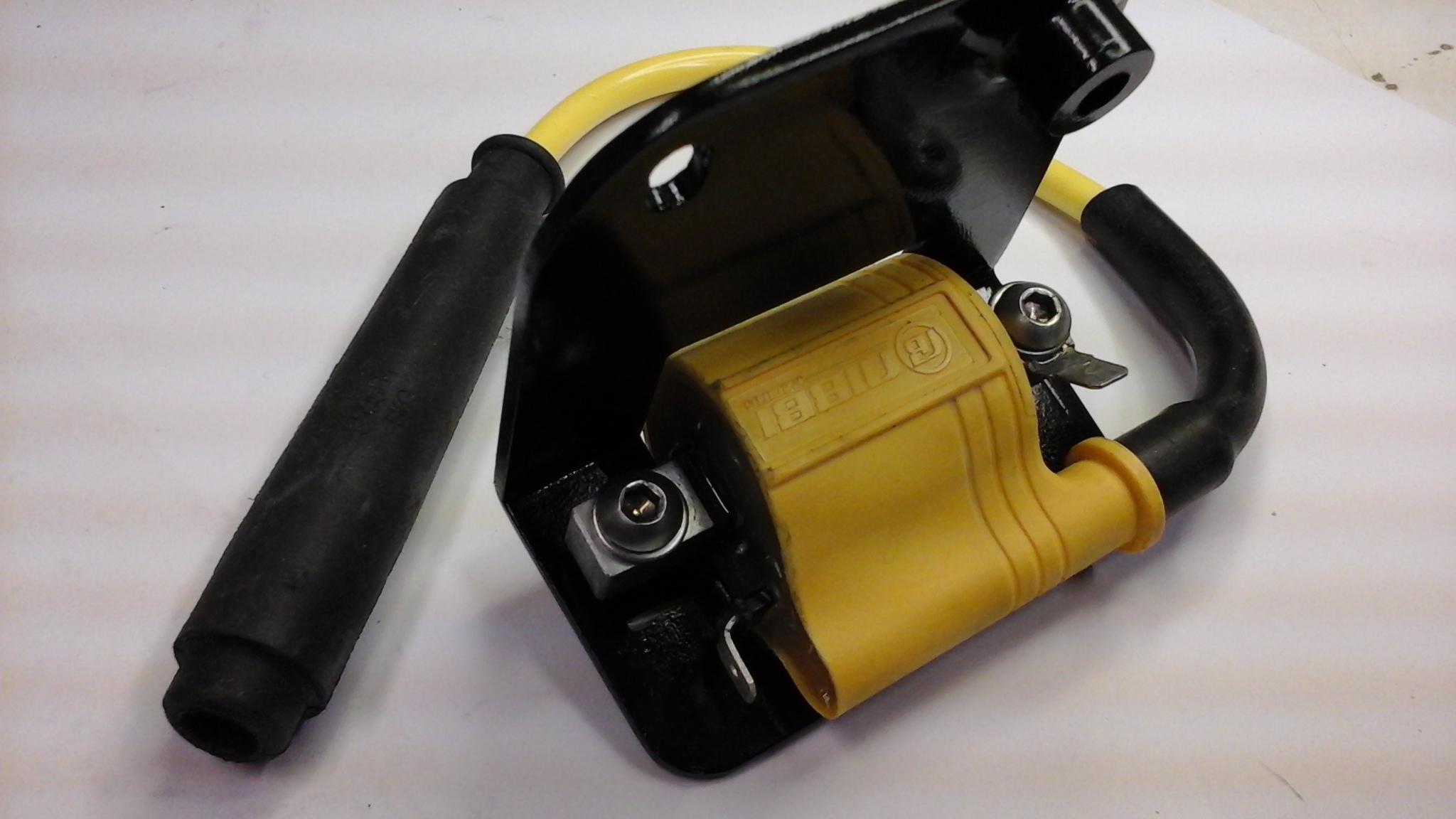

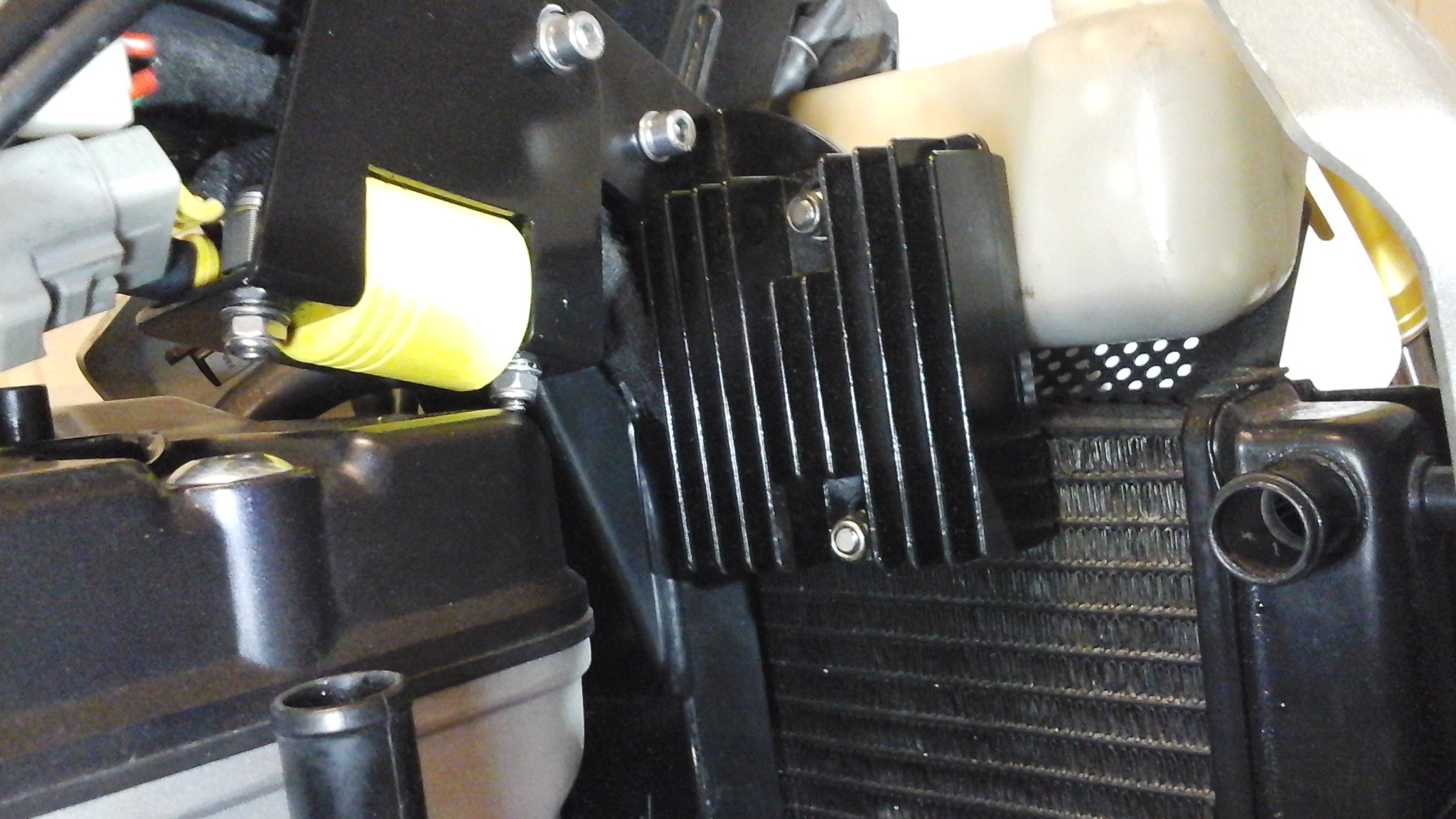

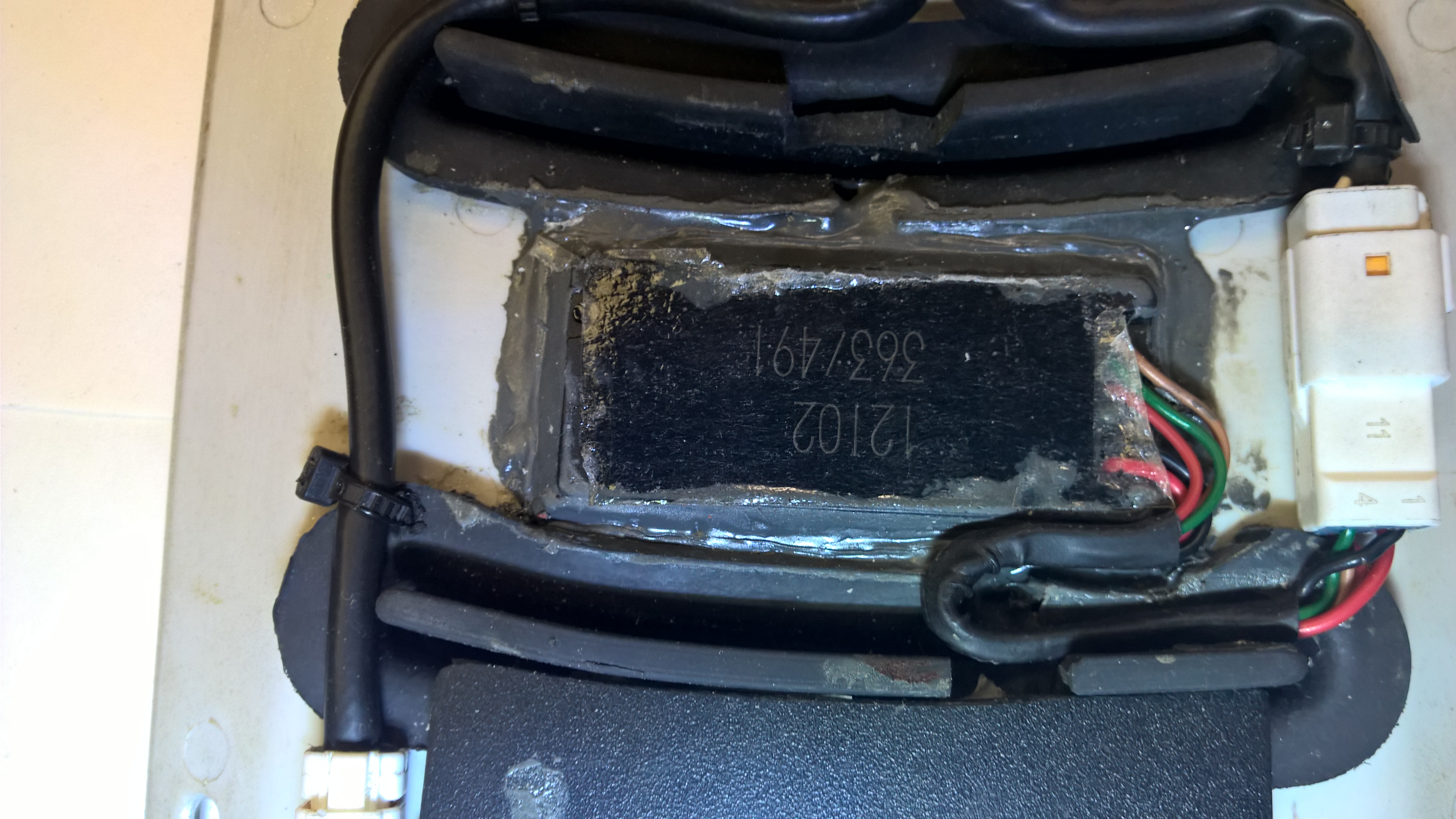

When I replaced the NC450 sohc engine with the NC450S dohc engine I had to make new brackets for the HT coil and rectifier/regulator due to the limited space above the cylinder head. These brackets were made out of ally shaped and bent with spacers fixed with JB.

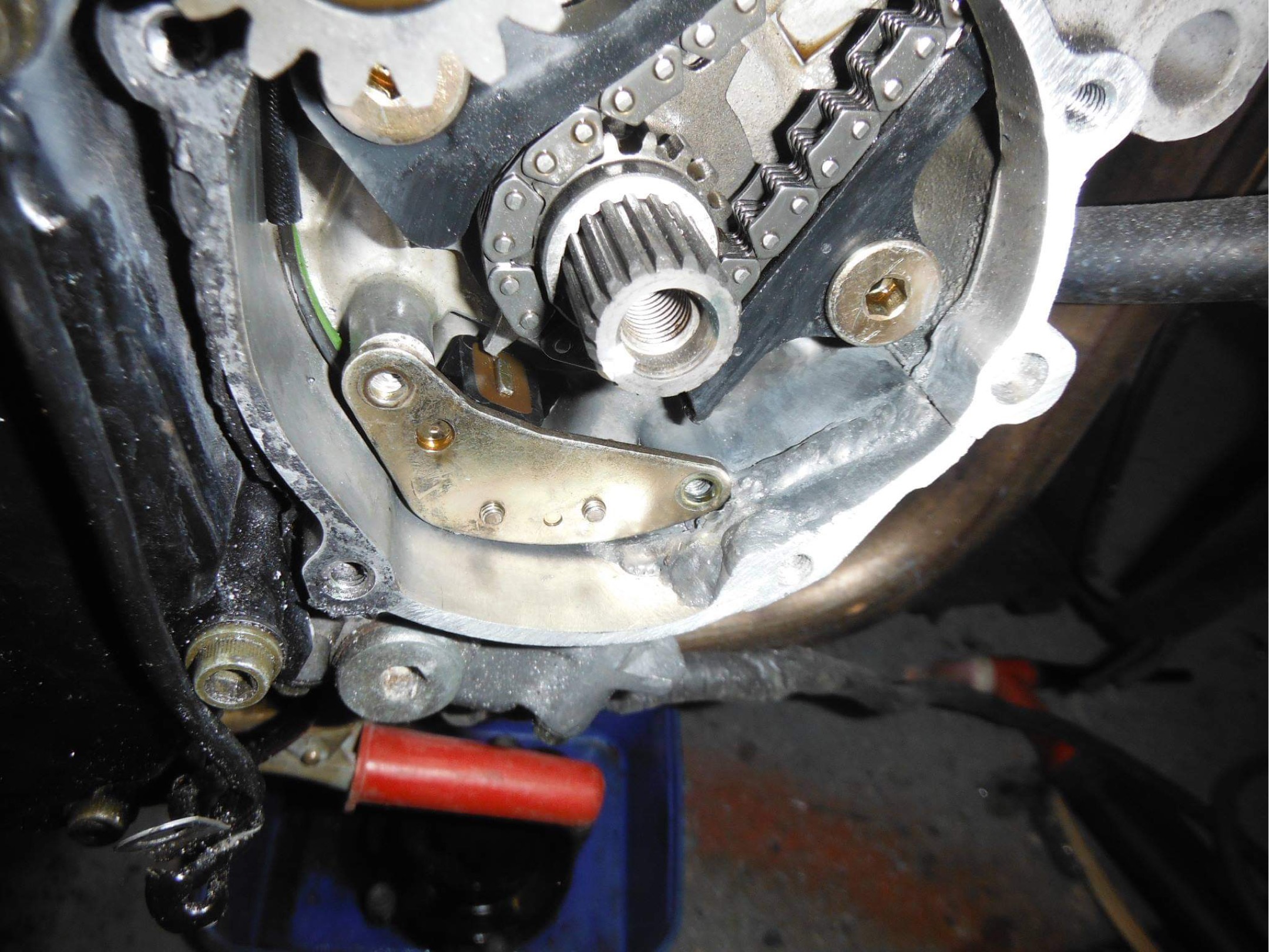

I bought a GSXR 750 years ago and stuck it straight into a mates garage over the winter. He phoned me up to say there was a pool of oil under the bike. On investigation there was a lump out the crankcase stuck on with JB. That probably explained the multiple owners it had had. Buy it,find out the problem and sell it on.
The picture is the welding that my mate did, easy for someone with the right knowledge and equipment. Now why couldn’t someone have done that before punting on a defective bike?

Scotsrich wrote: Thu Mar 05, 2026 12:21 pm IMG_0187.jpeg
I bought a GSXR, 750 years ago, and stuck it straight into a mates garage over the winter.
I kept reading that as if those commas were there. :lol:
Possibly not the best use.
Are you sure it was JB and not that chemical metal stuff? :hmmm:

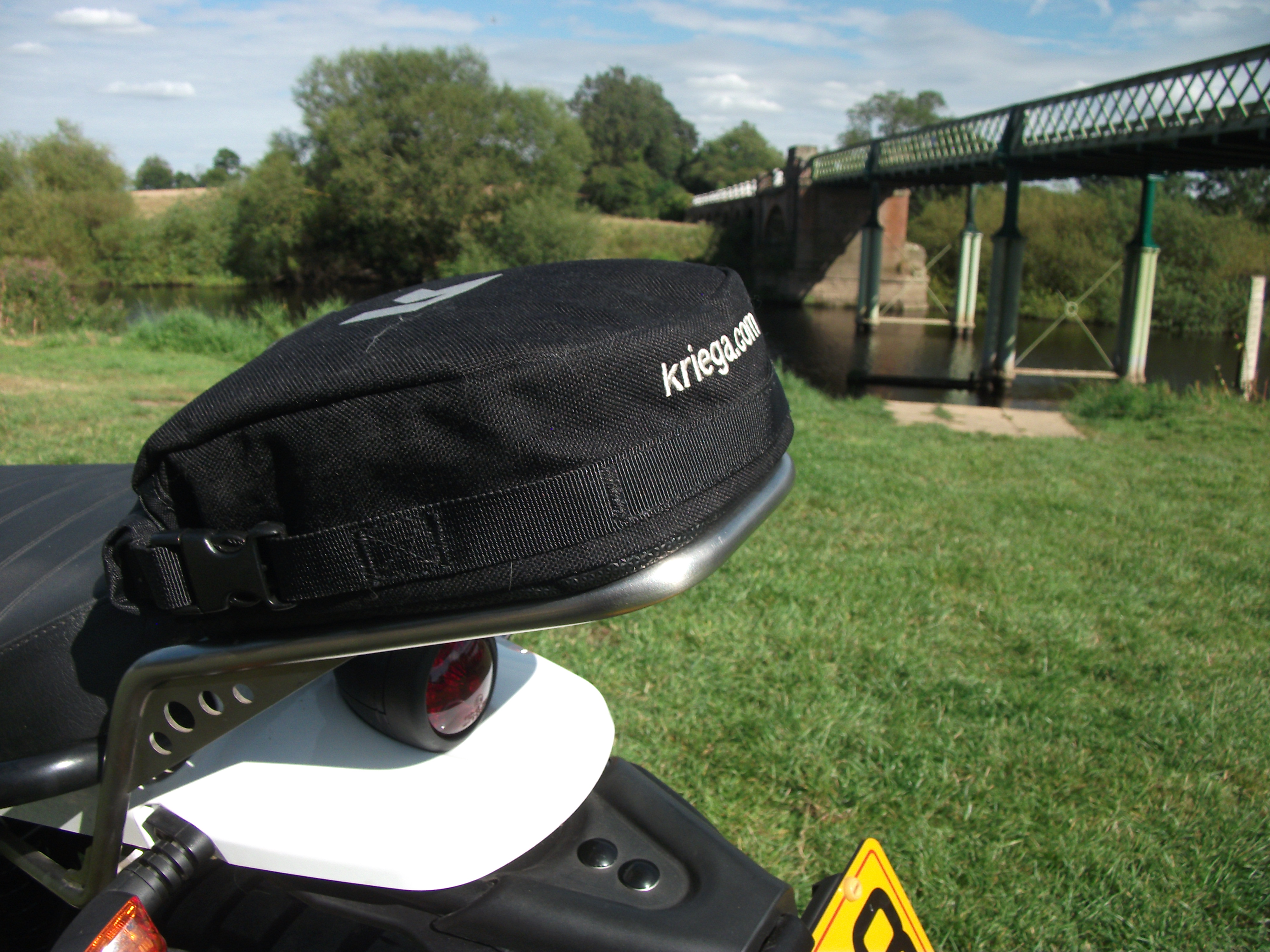

Made up this plate to fix Kreiga Rally pack to Berotec rear rack which has locating blocks stuck into position with JB.

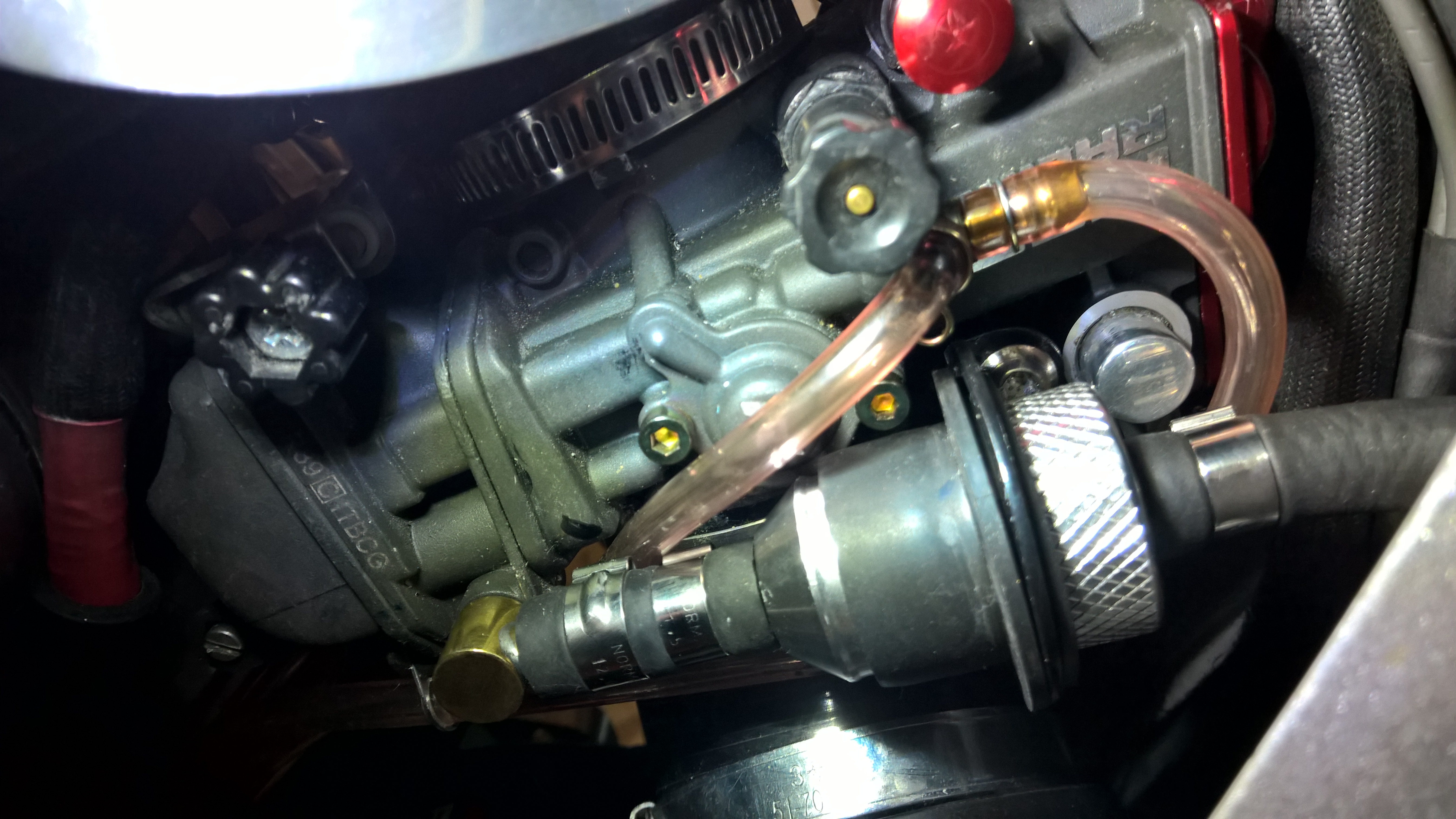

This is my latest and last project that uses JB, so over to you Guys now for your examples!. Nothing fancy just made a bracket to secure the fuel filter to the carb. I removed the throttle position sensor and used the fixing hole for securing the bracket instead. The CDI that I'm using doesn't have a TPS input so no problem removing it. However I needed to blank off the TPS aperture to avoid any air leaks, which I did so by making a ally blanking plug and fixing into position with JB.
iansoady
Posts: 504
Has thanked: 72 times
Been thanked: 244 times
Re: Projects using JB Weld
Post by iansoady »
