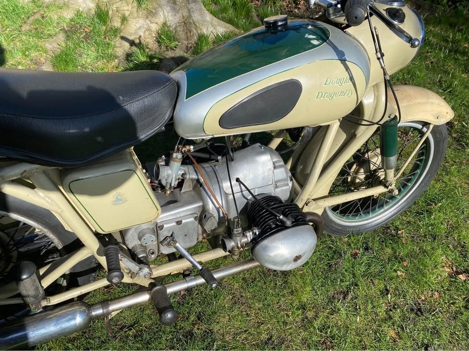

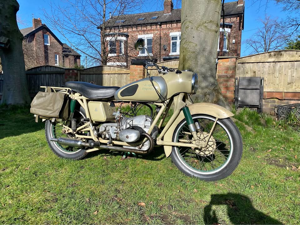

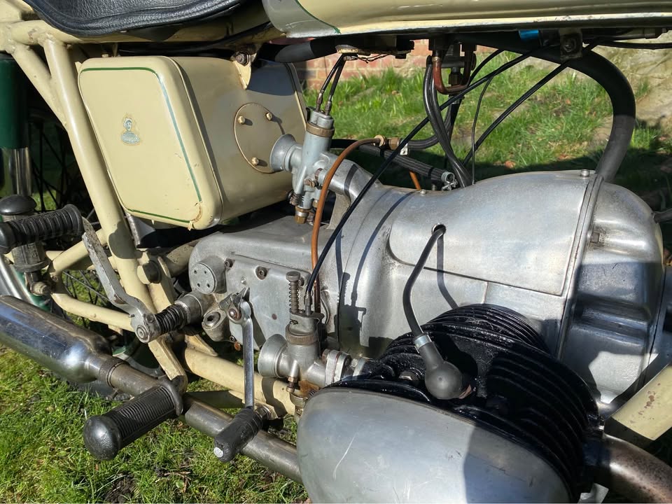

I spotted this Douglas Dragonfly on FriendFace Marketplace.
Why does it have three carbs and what is the middle carb feeding?

Dodgy69 wrote: Wed Mar 04, 2026 8:05 am Special init...Google says. 👍
Indeed....but how the heck does it feed into the cylinders? :hmmm:
I thought it might feed premix into the two main carbs but I can't see how.
Supposed to be part of the mods to make it a 100+ mph bike. Not sure I'd want to be on it!

KungFooBob wrote: Tue Mar 03, 2026 9:31 pm I could google this, but it's more fun getting the info from here :)
https://www.facebook.com/share/17tm3McZzw/
Very odd. I'd be interested to know how it works.

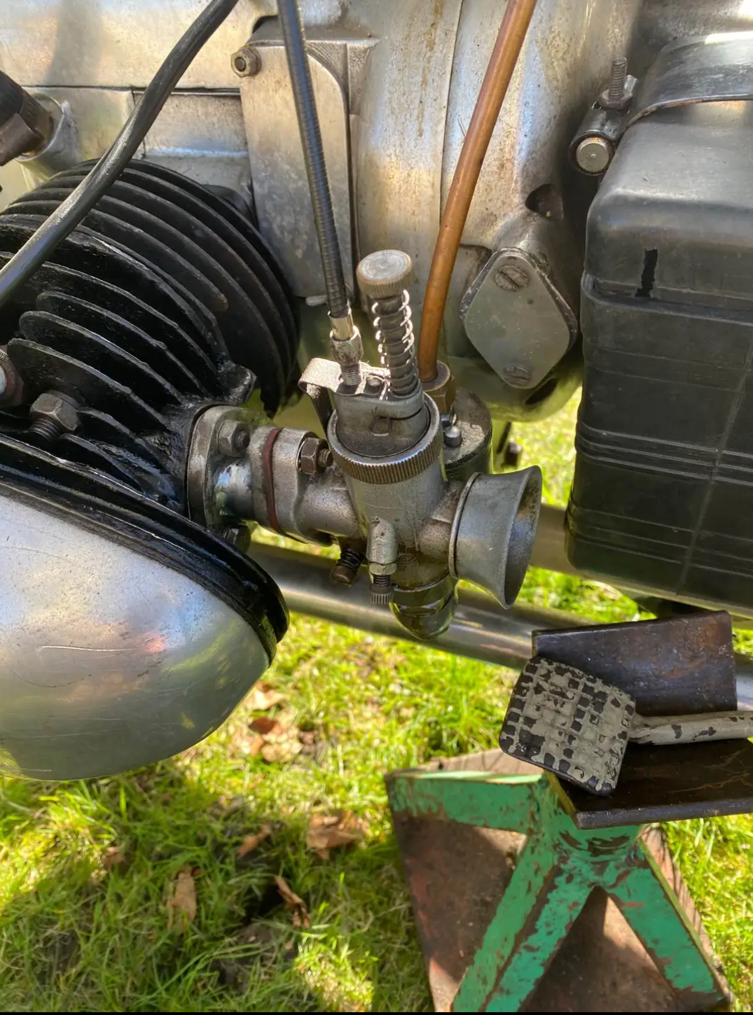

It looks like the centre carb fed a plenum behind the block, which then fed both cylinders, you can see the intake pipes in this pic...
I guess putting a separate carb on each inlet improves performance, but you'd think the centre carb would then be removed?

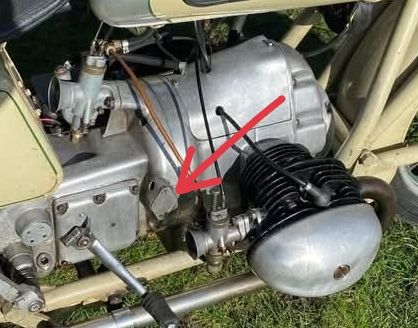

I had a yarn with our local Brit fiends. We all assumed it was a 3 carb bike,but it's actually a twin carb conversion. The carb in the centre was the original and the one on the right cylinder is the extra. You can see where the manifold was blocked off. So middle carb still feeds the left pot and the new one feeds the right.

I wondered about that blanking plate but couldn't see from the pix if there was an equivalent on the other side.
Posts: 17499
The other pot has a carb too...
Middle one must be a dummy,then?
Posts: 15905
Has thanked: 8035 times
Been thanked: 5693 times
KungFooBob wrote: Wed Mar 04, 2026 1:43 pm The other pot has a carb too...
So all is clear then. :thumbup: Blanking plate on that side too.
I couldn't see how the central carb was possibly connected to either the cylinders or the carbs when it feeds into that housing and the housing isn't connected to either - and the answer is - it doesn't, but it used to. So it's now a spare. :D
Had me head scratching last night though!

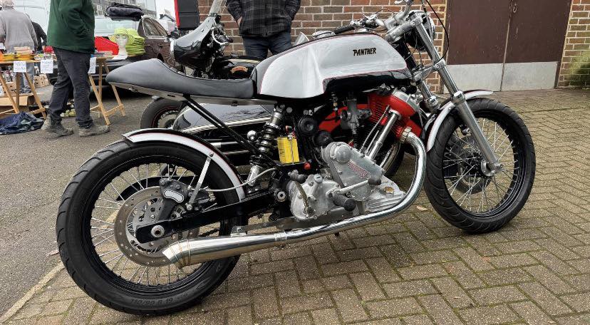

That's horrid.
Panther special.

Skub wrote: Sun Mar 08, 2026 5:54 pm Panther special.
Seen it all now. A café racer Panther! :lol:
...with disc brakes too!
The centre carb is for the auxiliary engine that runs the Aircon, hydraulic pumps and electrics.
