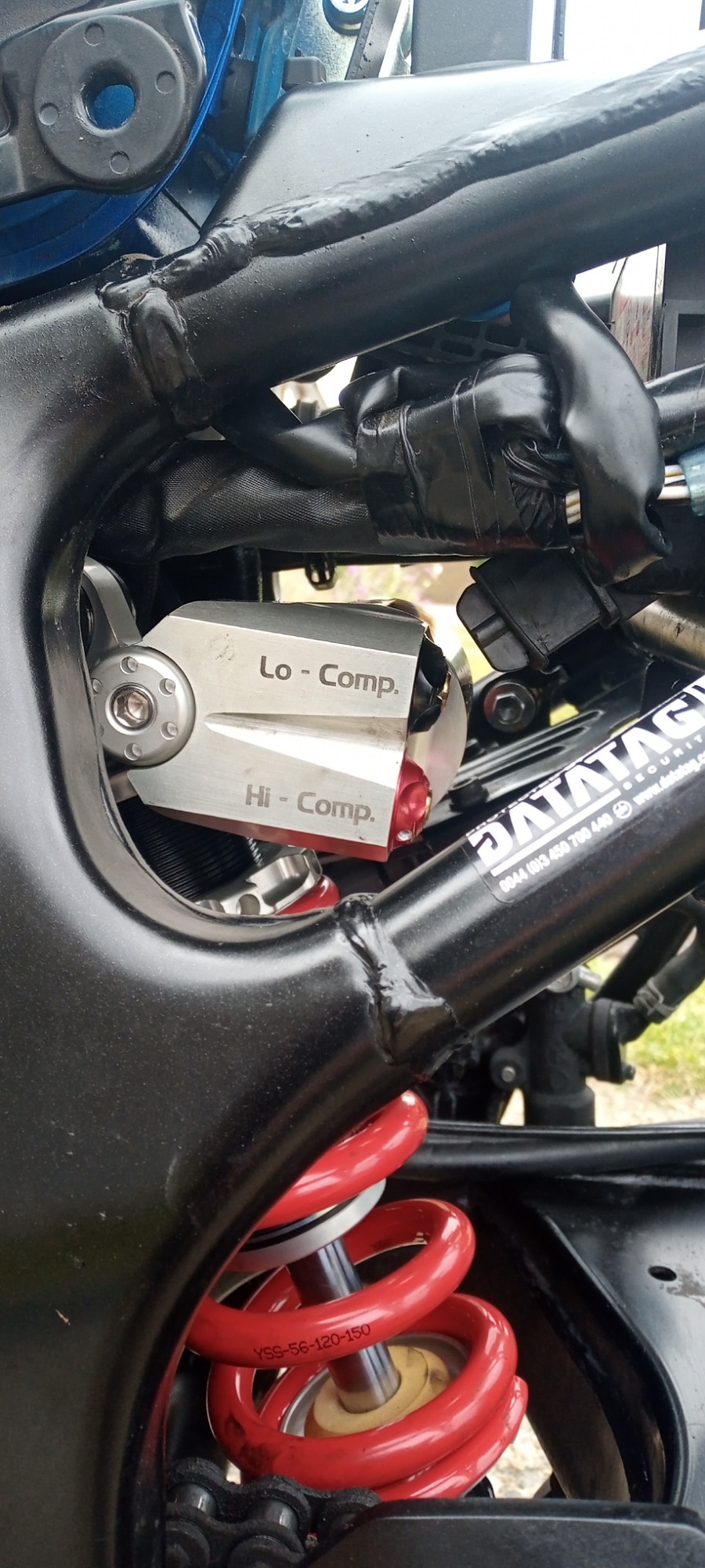

You can see the tab the relay mounted on in this pic, just to the right of the resovoir

Been out on it this morning, the new shock is fantastic, rather than skipping off bumps, the suspension now does what it should, no more wheel spin and the traction control cutting in on a bumpy road - probably the best improvement I've ever made to a bike, it shows what a budget shock the original is, over sprung and under damped.
The bike has gone from feeling like a powerful, smooth 1980s bike to feeling like an upright 2002 GSXR 750, the YSS shock is easily as good as the shocks on the top end sports bikes I had 20 years ago.
Backed off one click of low speed compression damping because it was a little firm for me.

I've noticed that somehow I've managed to put the shock bolts back in round the wrong way, the top shock bolt is now 6mm too long and the bottom 6mm short, it's not an issue because the nut on the bottom bolt is all the way in and there's a small amount of thread through the nut, but I've ordered a new bottom bolt and I'll replace it, I won't change the top one because too long isn't a problem, and more to the point, it's an arse to get to.
I'm mildly annoyed with myself for doing this because I laid the bolts out carefully when I took them out.

Longer ride on bumpy roads out to Orford this evening, the rear shock is very good, I can feel that the bumps are there, but the rear wheel is staying in contact with the road all the time now. I might need a click more rebound damping and maybe one less high speed compression damping, but I need to ride it some more to be sure.
