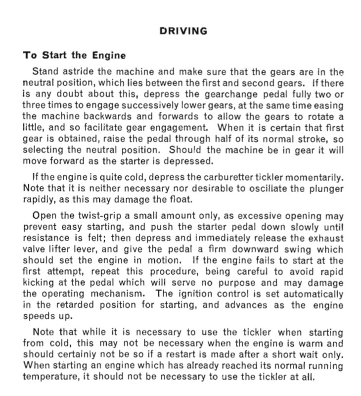

David wrote: Sat Aug 14, 2021 8:32 amWhat handbook?
The one for a 1971 Vauxhall Viva Estate.
I think it’ll often need tickling much more than “momentarily.”

Mr. Dazzle wrote: Mon Aug 16, 2021 6:09 pm I readjusted the clutch today after watching a few YouTube videos....seems pretty straight now.
Sadly I also discovered I've got the wrong primary casing gasket. I must have bought one for a different 1969 Bonneville :roll: :lol:
I put the casing back on anyway and tried to start her up. It'll be OK for a couple of mins with no gasket, there's only a little bit of oil in there.
Sadly I also failed to start :lol:
Kicker is much more positive now, every stroke generates chuffs, doofs or hisses from the pistons. I got pops and coughs pretty consistently, a kickback a few times (I assume that's what it was.....doesn't start and then suddenly lever fires back at you hard). Even got a few massive puffs of fuel vapour ejected backwards out the carbs.
No running though! I'm pretty sure its my technique.
That sounds like it needs more flooding on the tickler.

You don’t start it from cold on a closed throttle.
