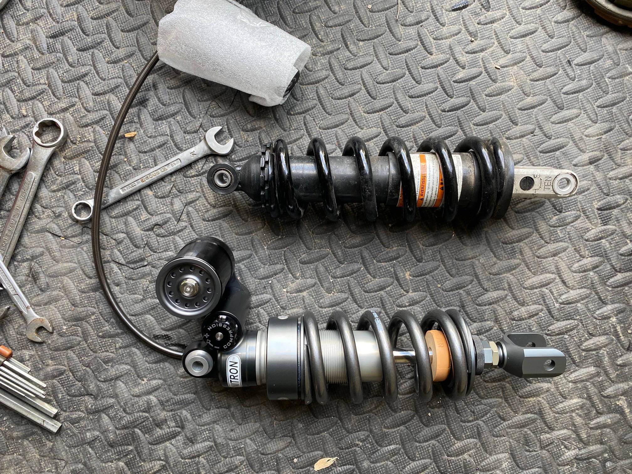

Investigated fitting shock today, thought I'd be able to improvise a chocking arrangement but that's a very wobbly no, so ABBA stand on order.

Old and new (note photo cropped to remove socks and sandals PPE). A little bit of a faff as exhaust bolts required loosening to allow lower pivot bolt to come out and then rear wheel had to come out to allow bulkier Nitron Shock to go in. Quick bolt check tomorrow and good to go.

Re: Shiny new bike day
Never mind that,we didn't get a report on the Nitron shock.
Ha ha, sorry, shock is lovely. Much more comfy though still needs a bit of dialling in. With the old shock when the TC kicked in with the bike leant over they would be a definite unload/step out as it was happening, all that happens now is the TC light flashes at me to let me know it’s working and bike just carries on accelerating out of the corner smoothly.
